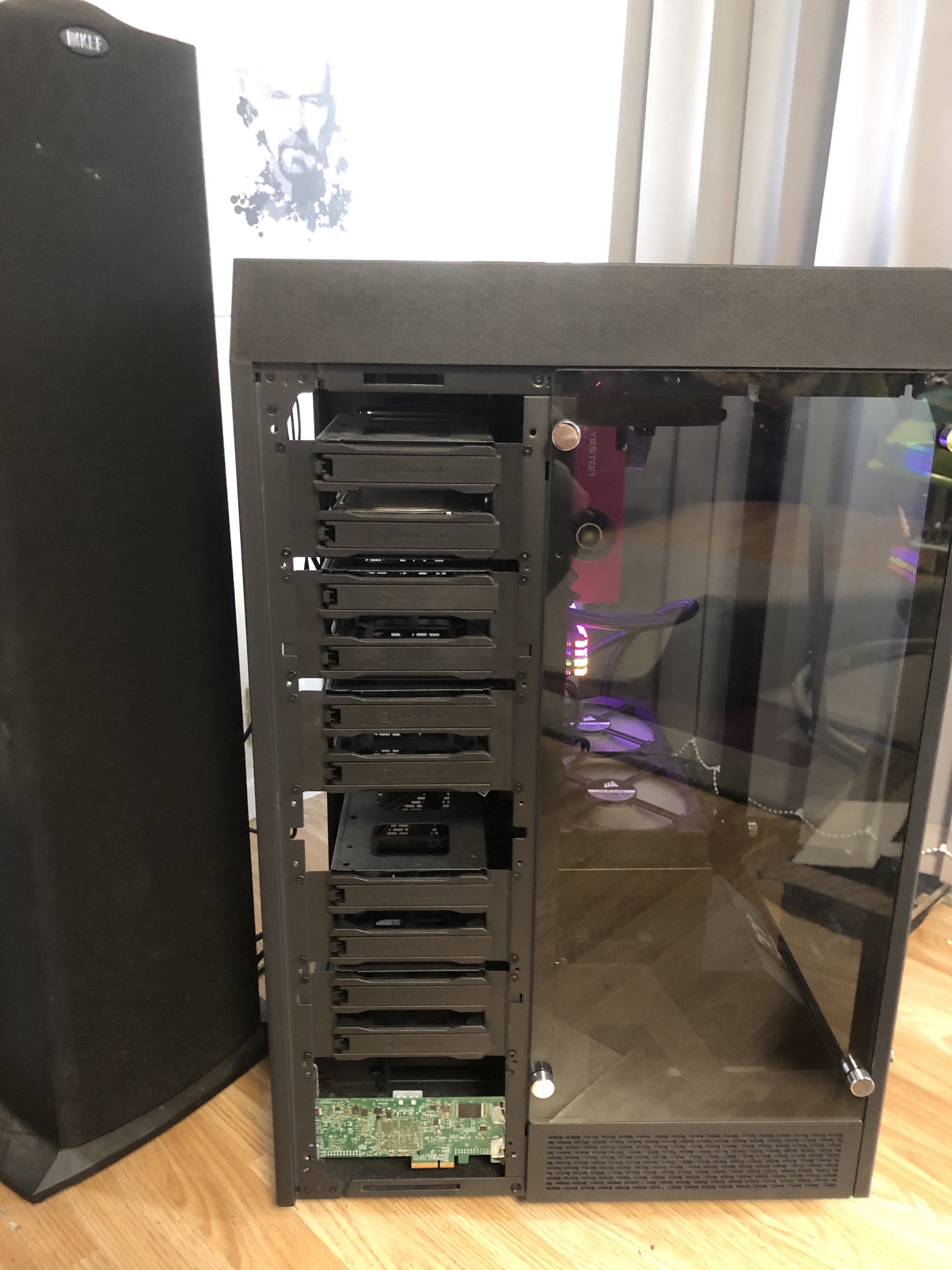

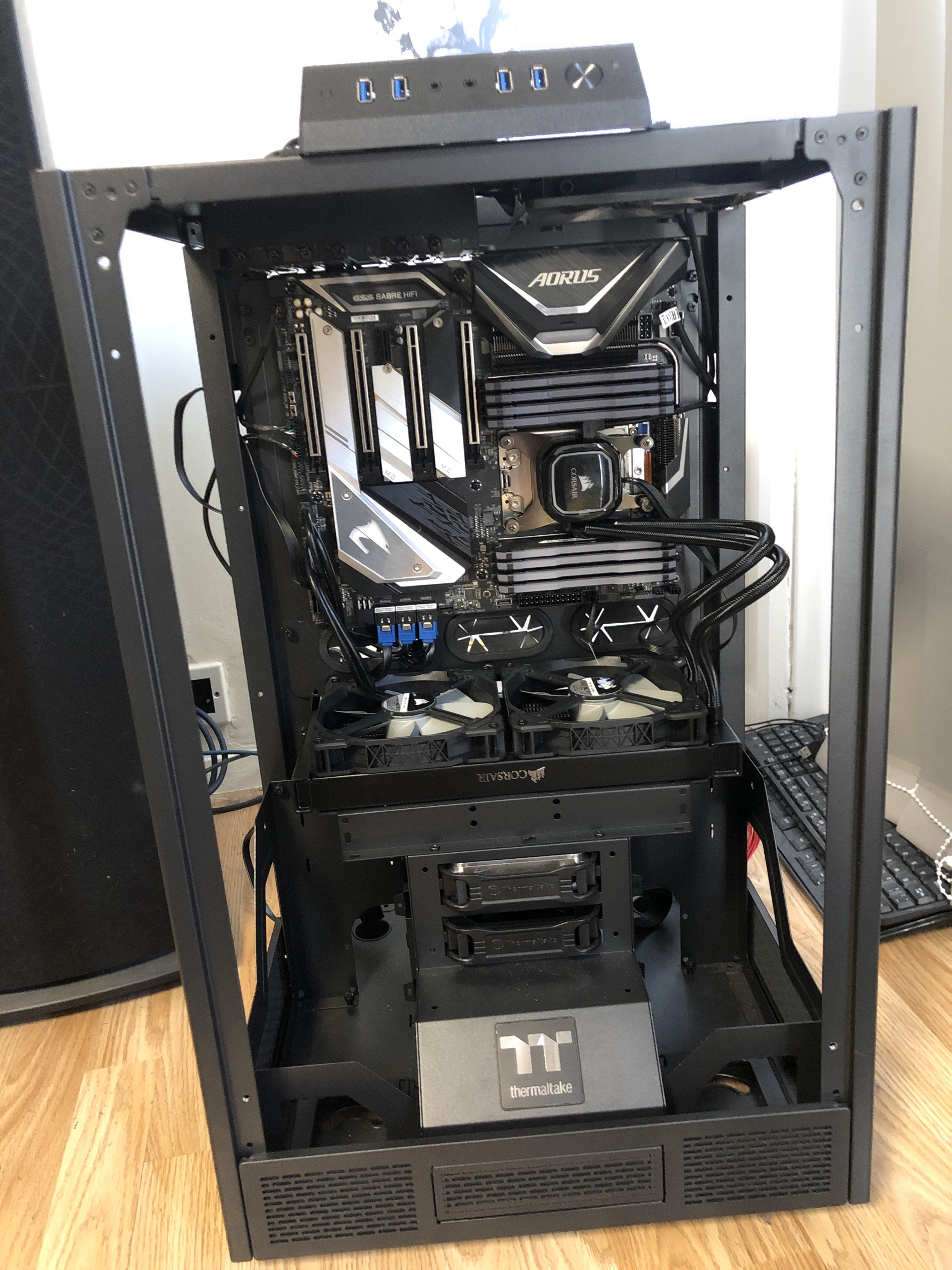

Aight guys I've got a question about the HX1200i that I have recently purchase I plan on making some custom cable to power all the hard drives for cable management would it be possible to power 10x sata drives from a single connection on the power supply? I will eventually be running 22 drives 10 in the left rear of the case 10 in the right rear of the case and 2 up from for parity. I plan on making 2x cable psu > 10x sata power for the left and right banks in the rear. If it makes any difference I'm planning on using 17-AWG hook up cable and the drives are all ironwolf 12tb.
how about two cables, four sata connectors and one cable, two sata connector?
Thats a possibility but to be honest a single cable would look much tidier plus the fact that I will need to make some custom cable to power my sas expanders. The sata expanders only require a single molex each but they are on opposite sides of the case. I'm not even sure if I would have enough connectors on the psu since I will need to run a total of 27 sata power cables. 26 for drives and 1x for my cpu cooler.
To give you an idea of what I'm talking about I've attached a couple of pics. The 10x hdd's in the rear are identical left and right side they will be connected to a sas expander which is at the bottom just below the HDD cages. You can see the 2x 3.5" drive bays at the front which I will be using for my parity drive and will be connected direct to the motherboard. Kind of hard to see but to the left and right of the parity drives there are 2x 2.5" mounts on each side and they will also need sata power.
