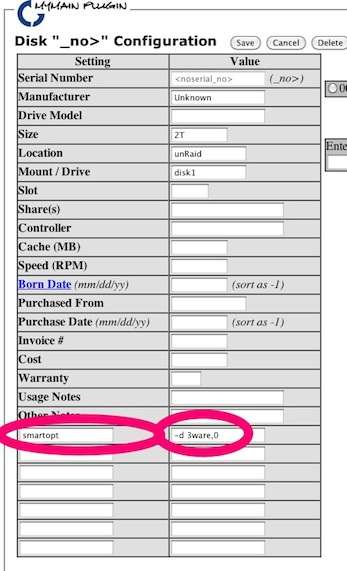

In myMain, you can go into a drive's attributes and set an attribute call "smartopt" to "-d 3ware,0". This should enable temperature and smart scene functionality in myMain. Post back if you have questions and I can help you get this configured properly. For anyone with a BR10i controller, setting smartopt to "-A" is needed for each affected drive.

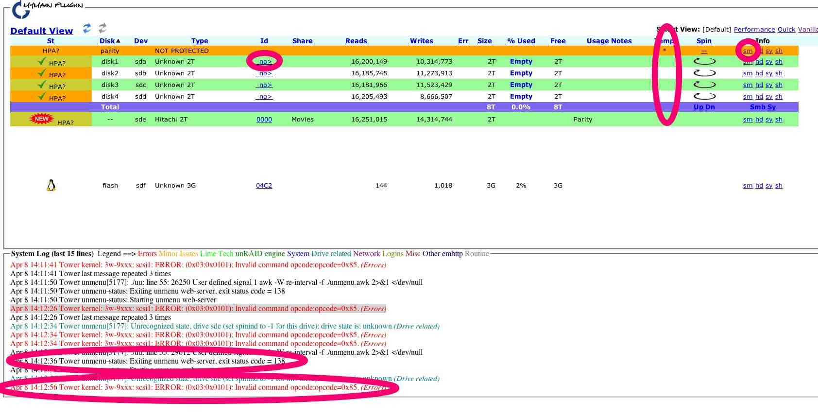

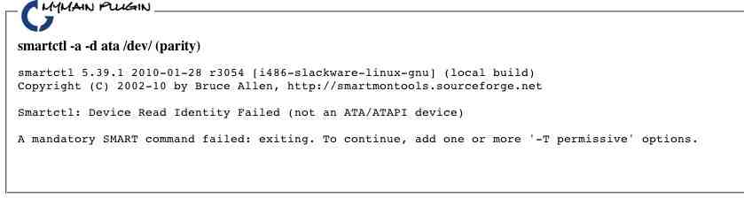

I must be doing something SIMPLE wrong?
Below is what I did based on your post, but I don't see the result, not in the "MyMAIN" screen, nor when I press "SMART"?

Obiwantje -
Below is a link to a zip file containing updates to some of the myMain files.  You need to unzip this into your unmenu directory.  (You might want to create a backup of the entire unmenu directory first to be safe).
You will need to add the "/dev/twa0" to your "smartopt" setting ...
smartopt      -d 3ware,0 /dev/twa0
Give that a shot and see if it works.  Post your results.

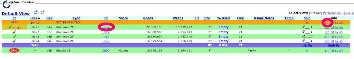

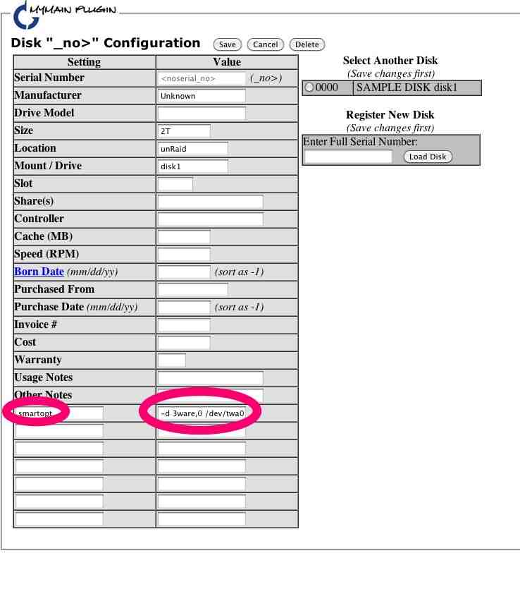

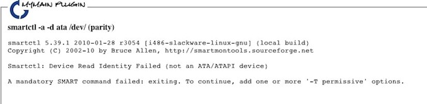

First off: THANKS for helping!
I tried it, but it does not seem to work, unless I am doing something wrong. I first did a clean install of unmenu, then the updates, and lastly overwrote the files and restarted unmenu.
myMain_Utility_-_smartctl_-a_-d_ata__dev__parity.jpg.e00fd86d1ad128e5ccca43162dedd1ff.jpg
58aad688c7908_myMain_-_Disk___no__Configuration.jpg.c13866fe30540fde6ea08412e85f581e.jpg
Were you getting a valid serial number before?  The setting I changed won't help it you're not getting a valid serial number to identify the disk.
