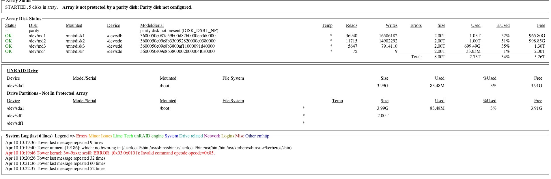

I get your point - So I installed 5.0b6a - And ran both commands again.....I see some data in there that looks different, and am hopeful this may be helping! Thanks for your continued effort!
lsbyid.txt
mdstatus.txt
Does unmenu show the temps? Try some smartctl commands.
Try unzipping this file into your unmenu directory.  Make sure to keep a copy of the prior version.
What is does, is if the serial number ends with four zeros ("0000"), it strips the zeros.  It seems that if you remove the zeros, the last 4 characters are then unique.  I am not sure if they persist across boots, however.  You'll have to try it and see.
This file will not become part of the normal base, so if this works you may need to reapply this going forward.  It's not a great solution becuase the string is really NOT your serial number.  That has implications if you move the drive to another controller.  (Like I said above, it may not ever stay across boots).

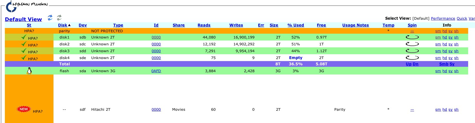

We're getting there! I think there is one more little thing wrong in your code...check the screens:
58aad68963f31_myMain_Utility_-_smartctl_-a_-d203ware020_dev_twa0__dev_sdb_disk1.jpg.9f9124e6b231322ef6941bafab3ccc7f.jpg

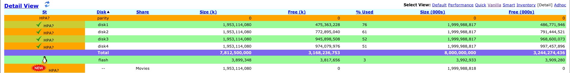

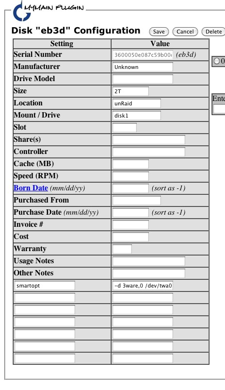

This looks like what I was expecting.  Did you go back and do the smartopt setting (see your own posts earlier in this thread for some screenshots).  Now that each drive has a unique "ID", the settings will stick and the smart report should work.
It appears that your drives are a funky size.  May be indicative of an HPA.  Go to the "Detail View" and take a screen shot (or else just look in the column labeled "Size (k)" and tell me the number there).  But this is not hurting anything.  And there is a way to turn off the warning if this is a byproduct of the controller.

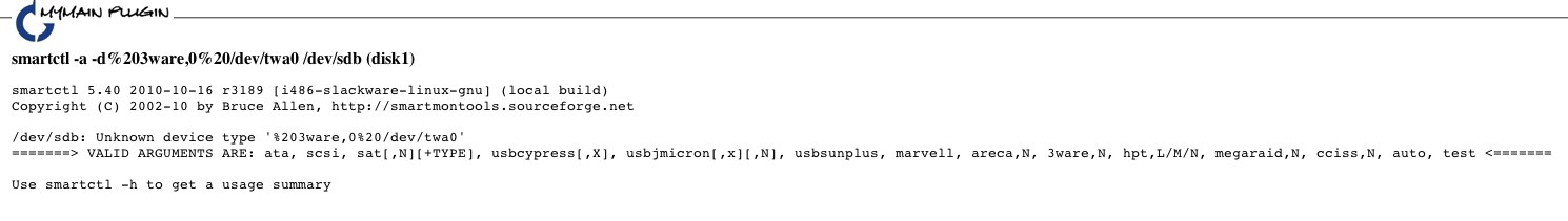

I forgot to add one screenshot (below) - I did the add of the smartopt - but as you can see it seems like it get's confused by the spaces used (translates them as %20%)
This issue was fixed in the attachment linked in THIS post.  I have removed the file from my file sharing account.  If you still have this file, please unzip both the 99-unmenu-utility.awk and drivedb.lib.awk files.  Do not overwrite the unmenu.base.lib.awk file, as I sent you a newer version.
If you no longer have this zip file, let me know and I will repost it.

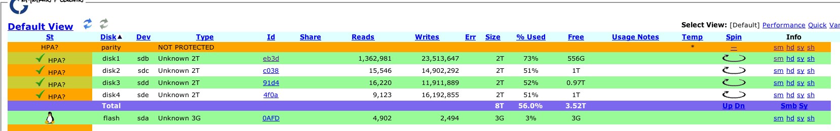

Sorry for that late reply....This seems to work now - though still no integration of the parameters.....this is the max I seem to be able to achieve with my 3ware controller....
Glad that it is working now.  There is no way to reliably convert an "sdX" to a 3ware number, but with a little manual setup, you should have a fully functional myMain.
