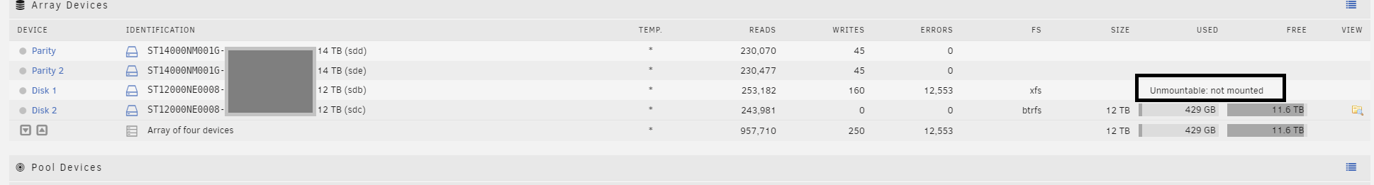

So i let my Unraid server shutdown and didnt use it for about 1-2 months when i came back and booted it up i was meet with my drive dont wanna mount.
It say error but i ran extended S.M.A.R.T test no problems there.
So what do i do now as this is my Data drive and the other is almost empty >_<
Screenshot show server after start.
Added diagnostics in case they are needed.
I hope someone can help me please.Screenshot_4.thumb.png.c1b0e86d4f4c50a74b6d086658541140.png
tower-diagnostics-20211110-2047.zip

So i ran a check as the guide said and this is what i got but i dont know what it mean about "mount the filesystem"

Also for some reason i have 1 drive in xfs and 1 btrfs im pretty sure they should be the same but im 100% i didnt change anything like filesystem
