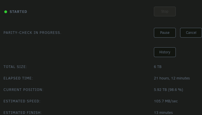

Parity check has been stuck here for at least 2 hours:

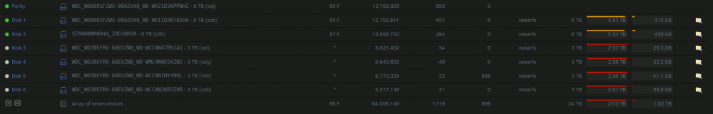

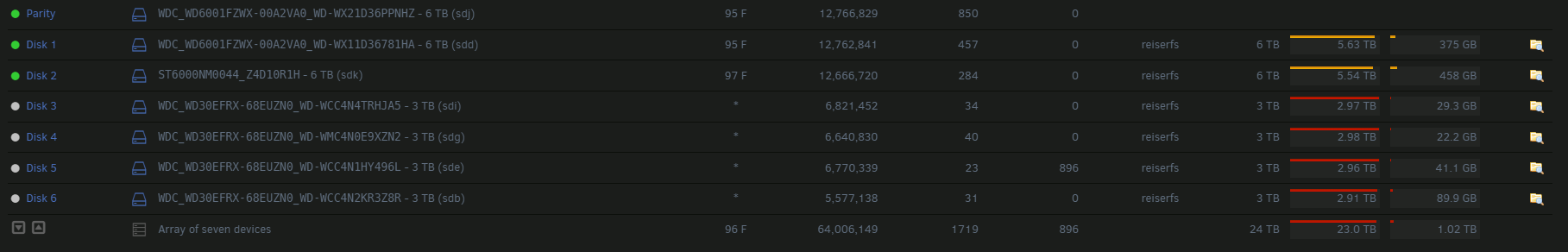

And I have this disk with a ton or errors:
I do have a 6tb disk on hand I could use to replace disk 5, but I wanted to check in what the best way to proceed was before making any changes.

The parity check is still at 98.6%, it's been there for about 12 hours
Should I try to cancel the parity check?
