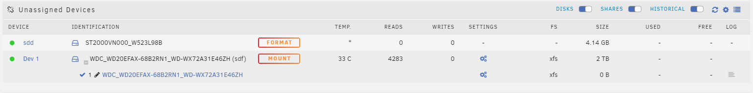

Since the new disk is not assigned, you could remove it and attach the original disk2. I just want to see the original disk2 in the diagnostics without the array started.
If the original disk 2 is truly out of commission (as I assume given the ❌ that was next to it when I replaced it), what other options exist here?
just saw your reply. Reconnecting the original disk 2 now. The new diagnostics are uploaded here. It looks like Unraid is seeing the old disk 2 as a "new device" so I'm very fearful of spinning up the array and then Unraid begins to automate the formatting and syncing process...
If this disk happens to still work and has retrievable data, how do I prevent Unraid from going forward with a process to rebuild data??

I have a new question in reference to the issue.
On 11/13/2021 at 5:30 PM, trurl said:
disks can be disabled for different reasons, and one of the most common is bad connections.
SMART for original disk2 looks good. So, we are going to New Config original disk2 back into the array, and rebuild disk1 instead.

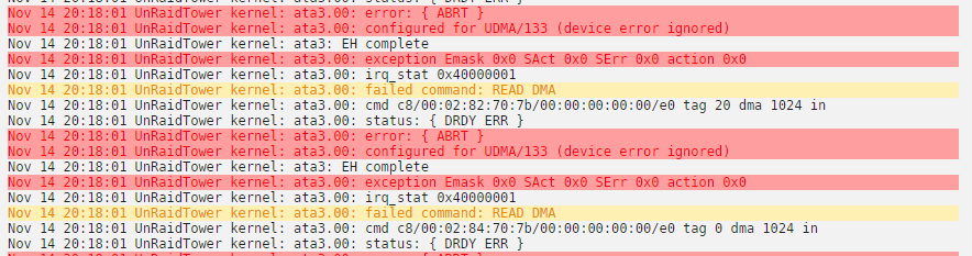

Alright... so after running step 3, and looking back at the MAIN menu, disk2 disappeared from the array devices list. It's no longer assigned, and it's no longer in any of the dropdown menus... It is now under Unassigned devices and labeled "sdd", next to the replacement disk for disk1. I have no idea why it says that it is 4.14 GB. It's a 2TB Seagate. I'm afraid it might be the "Hybrid" SSD part of the disk that is the only thing being recognized.
Here's a snippet from the disk log:
Edited by egeis
So I rebooted and all four disks are now able to be allocated... though I still think disk2 is suspect given my previous post. Looking forward to your suggestions of whether I should continue given the previously mentioned errors.
Edited by egeis
Try replacing or swapping cables with a different disk, but possibly disk is really failing, despite a good looking SMART.
