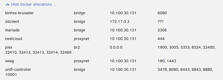

I have 3 Ethernet cards in the server, each with own IP net. Purpose is Eth0 10.100.30.131/24 is for systems management access, Eth1  10.100.100.10/24 will serve requests form Internet direct via firewall (not DMZ), Eth 2 10.100.50.10/24 will serve requests from local LAN. I have SWAG installed with reverse proxy set up to support Nextcloud as per vids from spaceinvaderone. It works fine in the sense that I can access Nextcloud via the reverse proxy (from Internet) but all responses from the server come out via Eth0 the management interface. I've set up my firewall to direct all incoming (from Internet) requests for Nextcloud via Eth1 (Internet access interface) the server receives and responds back out via Eth 0. I tried playing with the docker network connect command to attach an IP from Eth1 to swag but to no avail. Anyone have any idea how I can go about getting this setup to work correctly such that the server will respond back out the interface it received requests on?
