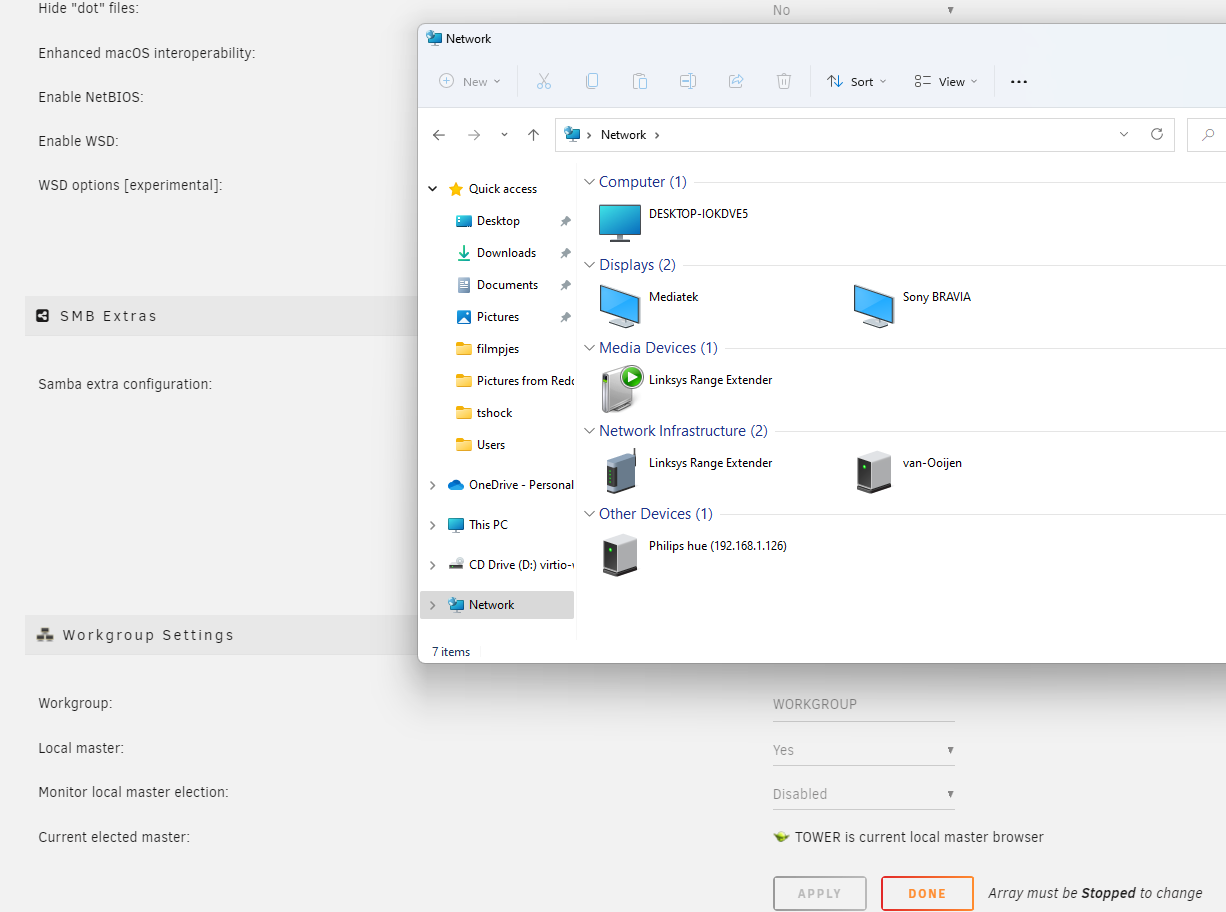

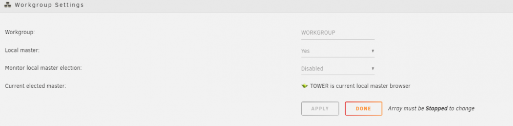

Thanks for the link. That is a big page so I will read most of it later. I checked all computers in the house and they are all part of the default workgroup. I never set anything up and they just found everything that was on the network. So I assume that all computers / virtual machines are just looking at everything available on the network. Unraid says:
image.thumb.png.19ef93077b1e98bad0b147d784c400b3.png and all computers also say they are part of "WORKGROUP".
I also found Yoda so my Unraid system is the local master. I will check that next time when it goes offline. That could take a few hours or a day. It is always random. If this problem is related to the local master thing, then the next time my shares go invisible, the Yoda logo should be gone.

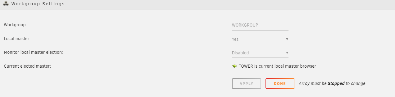

It happened again. The shares have gone invisible:
But Unraid is still the master browser. I think that means that there is another problem going on in my system.
I also don't understand why there are 2 displays mentioned there while I do not know them. But They have been there for months.
