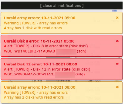

I powered up the server and it seemed to come up fine. I then noticed a couple data drives disabled. Not ideal but not too big a deal I thought as I have two parity drives and a few spares.
Shut down server replace disk 8 (14TB for 14TB) and parity rebuilds successfully in a little over a day.
Once that's done shut down again and replace second drive, disk 12. I upgraded this disk from 8TB to 12TB. I put the new disk in and all of a sudden disk 11 is completely missing. I checked the connections and all looked good. I decide to let the disk 12 replacement finish rebuilding and then will visit disk 11.

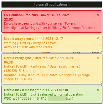

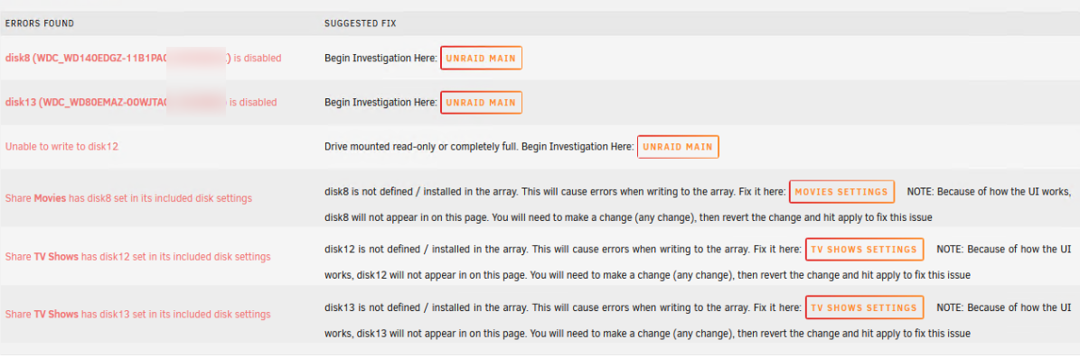

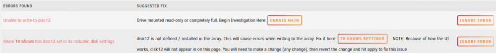

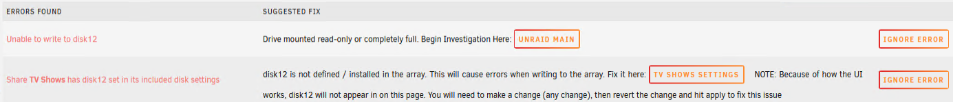

While this starts I get a error message from the Fix Common Problems plugin. It shows that my disk 12 which was recently replaced shows as being unable to write to, ie read only. I will investigate after disk 11 finishes data rebuild.

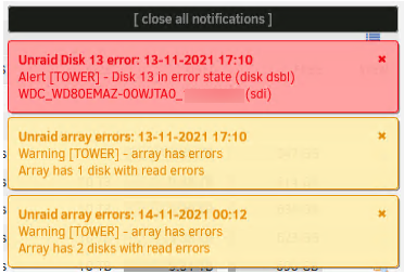

Before disk 11 finishes rebuild disk 13 goes to error state. I again decide to wait to investigate after disk 11 finishes data rebuild.
Disk 11 finishes rebuild but with many errors.

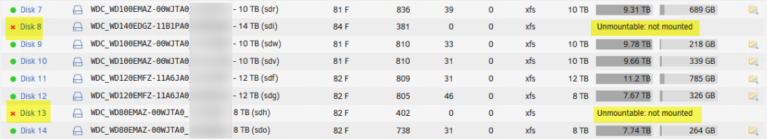

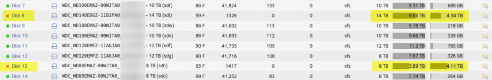

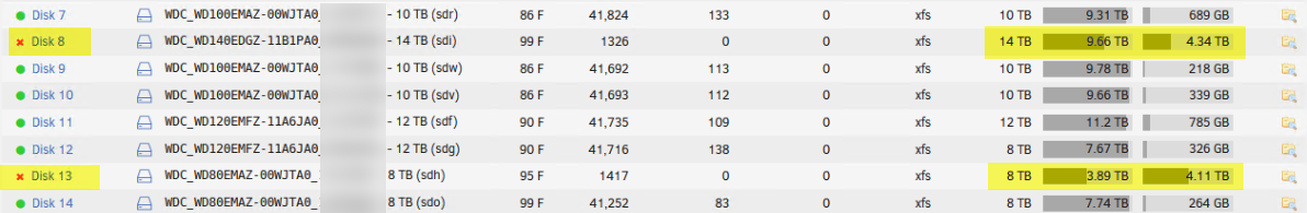

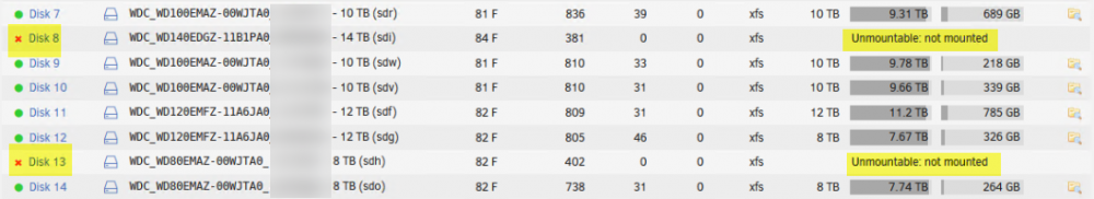

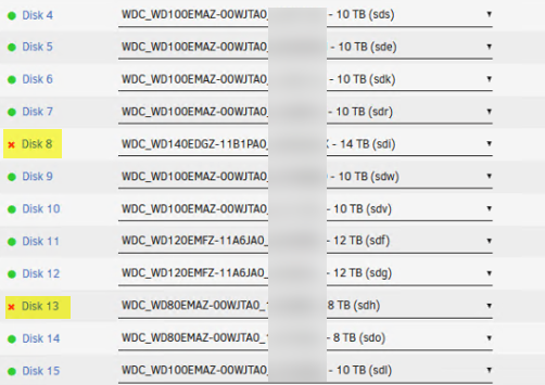

I stopped the array and disks 8 (replaced) and 13 (not replaced) are both disabled. These are the drives where all the errors are coming from.

I power my das up first then server. Disks 8 and 12 are still disabled but now show unmountable not mounted.

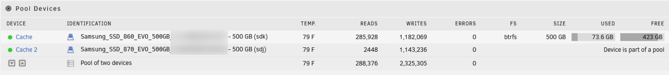

I have a second ssd and added to my cache in the hopes that it will let me access the shares such as appdata, system, domain. The second ssd adds fine but still no access to dockers.

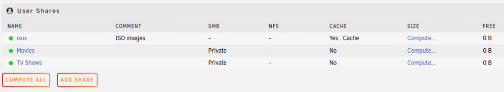

Finally one of my shares setup for Plex shows as being completely empty. I have two setup, one for movies and one for tv shows. Most of the disks that had issues are in the tv shows share but one is used for movies. I am able to view the contents of the movies share for the most part. For the tv show share in the main view in the console I can see data on the disks allocated for the tv shows share.

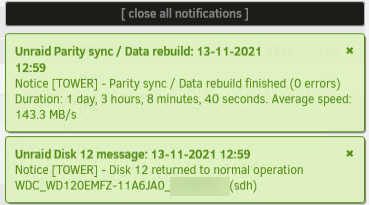

I also noticed that Disk 12 is 12TB but shows as 8 in the data column. This was the second disk I replaced and it completed rebuild successfully 10 days ago or so.
Rebuild message on 11/13
Disk 12 status on 11/24
Would either of these cause any issues if I were to put in new drives to rebuild? If not I will proceed to let that process run.

According to those screenshots, disk12 was rebuilt on the 13th, but then a parity check on the 14th found a large number of sync errors. Was that a correcting parity check?

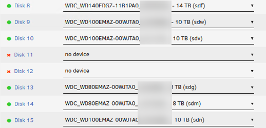

  • I replaced disk 12 on the 12th. When I powered on the system disk 11 was not detected. Instead of troubleshooting this I let disk 12 be rebuilt. It completed successfully on the 13th.

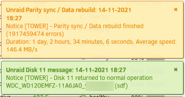

  • I then replaced disk 11 and this is when the parity errors were generated that show on the 14th.
Do you mean you successfully rebuilt disk11 and then you ran a (correcting or non?) parity check?
Disk 11 returned to normal operation but i did not get the message when it completed saying that data rebuild finished with no errors.
This is the message I received .
This is unlike when I rebuilt disk 12 days earlier which did complete successfully.
Same number of errors on rebuild as on parity check.

Some of my other shares now appear that were on the cache drive.
No dockers but I think that is okay as I can download them again.
My Movies share seems to be fine. I can navigate the folder contents and see most data there.
