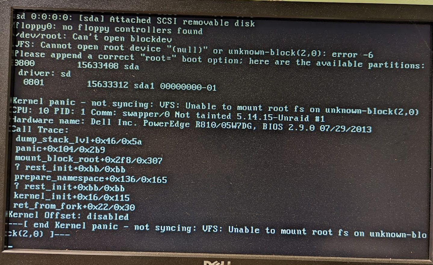

Last night I upgraded from 6.10 rc1 to rc2. After rebooting I'm getting a kernel panic-
Kernel panic - not syncing: VFS: Unable to mount root fs on unknown-block(2,0)
This is a pretty new one for me, I wouldn't have expected it to fall over. I'm wondering if it's the flash drive...
Any help appreciated!

This is usually a flash drive issue, backup the config folder and redo it.
