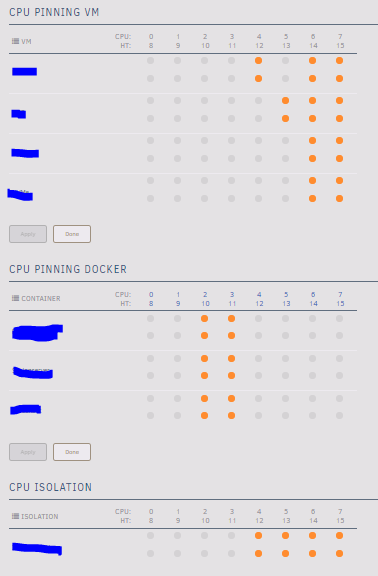

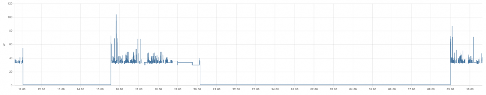

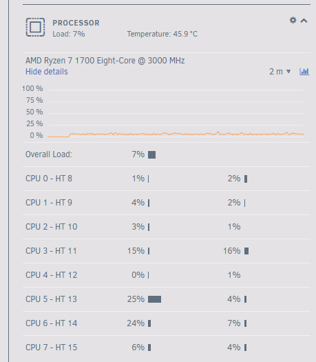

With more core, you can pinning cores for different application and make cores overall running in lower clock rate to got best power usage. Below is my Ryzen 1700 pinning setting, with 10G NIC, power usage is ~50w.
My main desktop was 9700K with 10G NIC, power usage ~36w.
