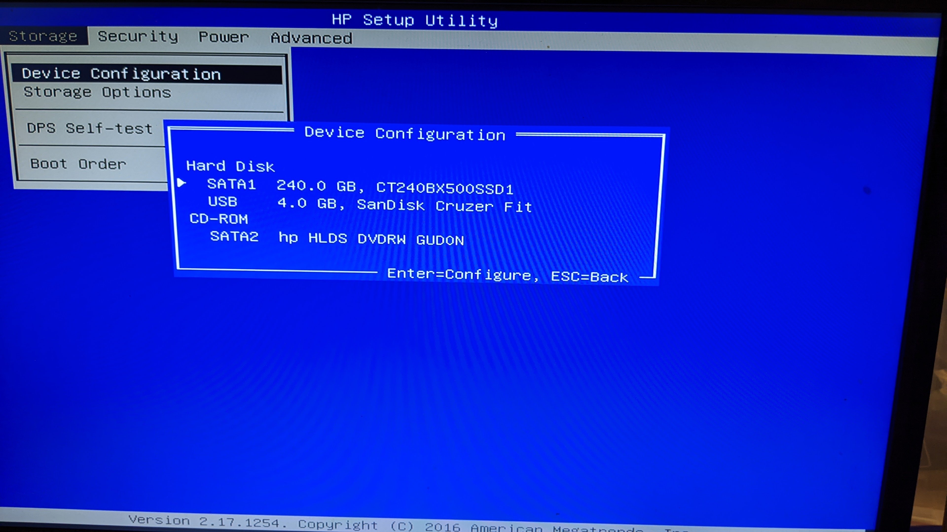

I did try looking around the BIOS of my HP and it did see the Cruzer USB Stick, but for some reason its not appearing in the boot List.

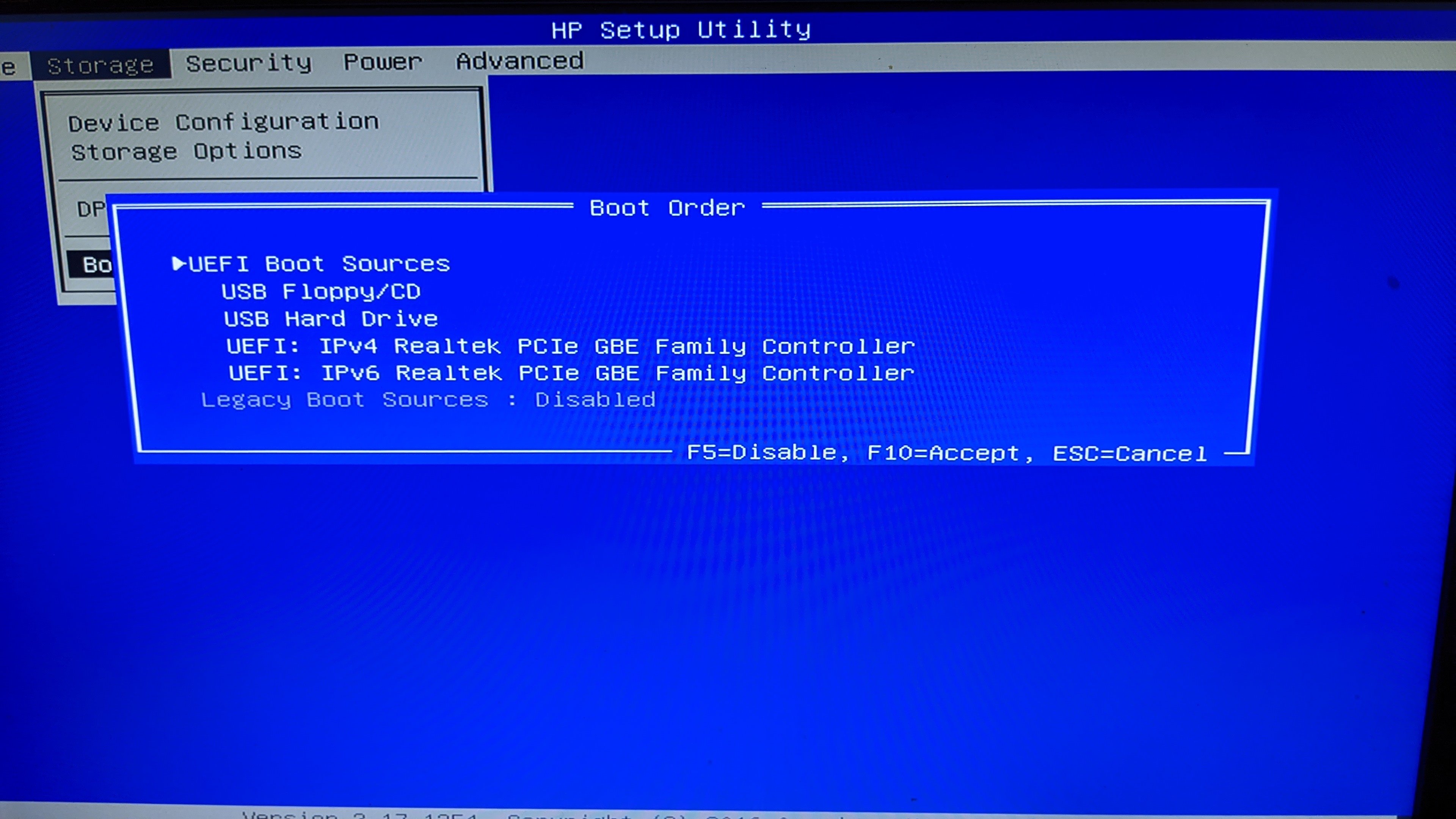

Can you post a picture of that?
Sure. Here are pics from my boot list and what drives are appearing
Thanks again!
Did you enable UEFI boot on the flash drive? If not rename EFI- to EFI, or enable legacy boot in the BIOS.
