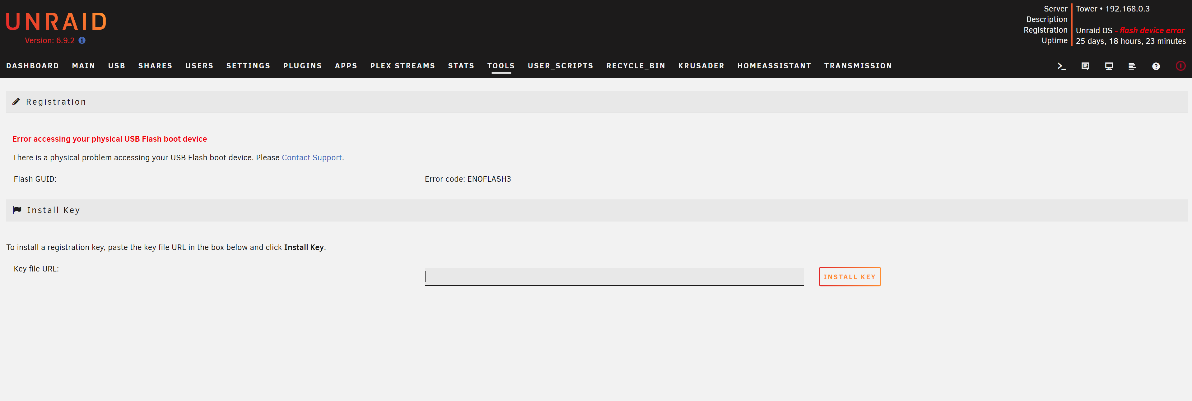

flash error.. not sure what caused it?
can you guys tell me what went wrong..  i didnt unplug the flash drive  but i wasnt able to copy to the array and i checked my server and it was down.. flash drive was corrupt.. so that makes the Array unusable

but here is the diagnostic   maybe you can tell me  where it went wrong

does it say how the flash drive got corrupted?  as i didnt pull nothing out
so i letting it run parity check.. after  this second time it having issues with the flash..  and having to reboot  its gone into parity checking.. so didnt wanna touch it...
i use the detacth attach usb device for home assistant  would that done it?   as i use ESP Home devices to program them  but i only attach  the esp device  nothing else  to home assistant

Are you using (recommended) USB2 port for the flash?
Nov 19 19:04:16 Tower kernel: usb usb6-port1: over-current condition
Nov 19 19:04:16 Tower kernel: usb usb5-port1: over-current condition
Nov 19 19:04:17 Tower kernel: usb usb5-port2: over-current condition
Nov 19 19:04:17 Tower kernel: usb 5-2: USB disconnect, device number 2
Nov 19 19:04:17 Tower kernel: usb usb6-port2: over-current condition
I'd say it's the flash drive
i dont think i have a usb 2 port anymore  its all 3.0 3.1 on this board
does the over current mean its getting too much power?
i use the bios flash usb port on the motherboard......
is me using the other ports  causing it to over current...    as it happened again...         maybe  i need to use inside usb port need one of those adapters
i also checked i dont have usb2.0 ports  all ports are USB 3.2 gen ports
there is internal header  for usb 2.0   ill have to see about a cable and make the usb drive inside the case
did it say its over currented again?  if so  i think it might me being using  ESP32 devices on the usb ports on the back of my motherboard.. to program them with ESP Home...  in Home assistant..  i think maybe its drawing too much current?
gonna try to get internal usb cable to port  and hopefully that solves that
