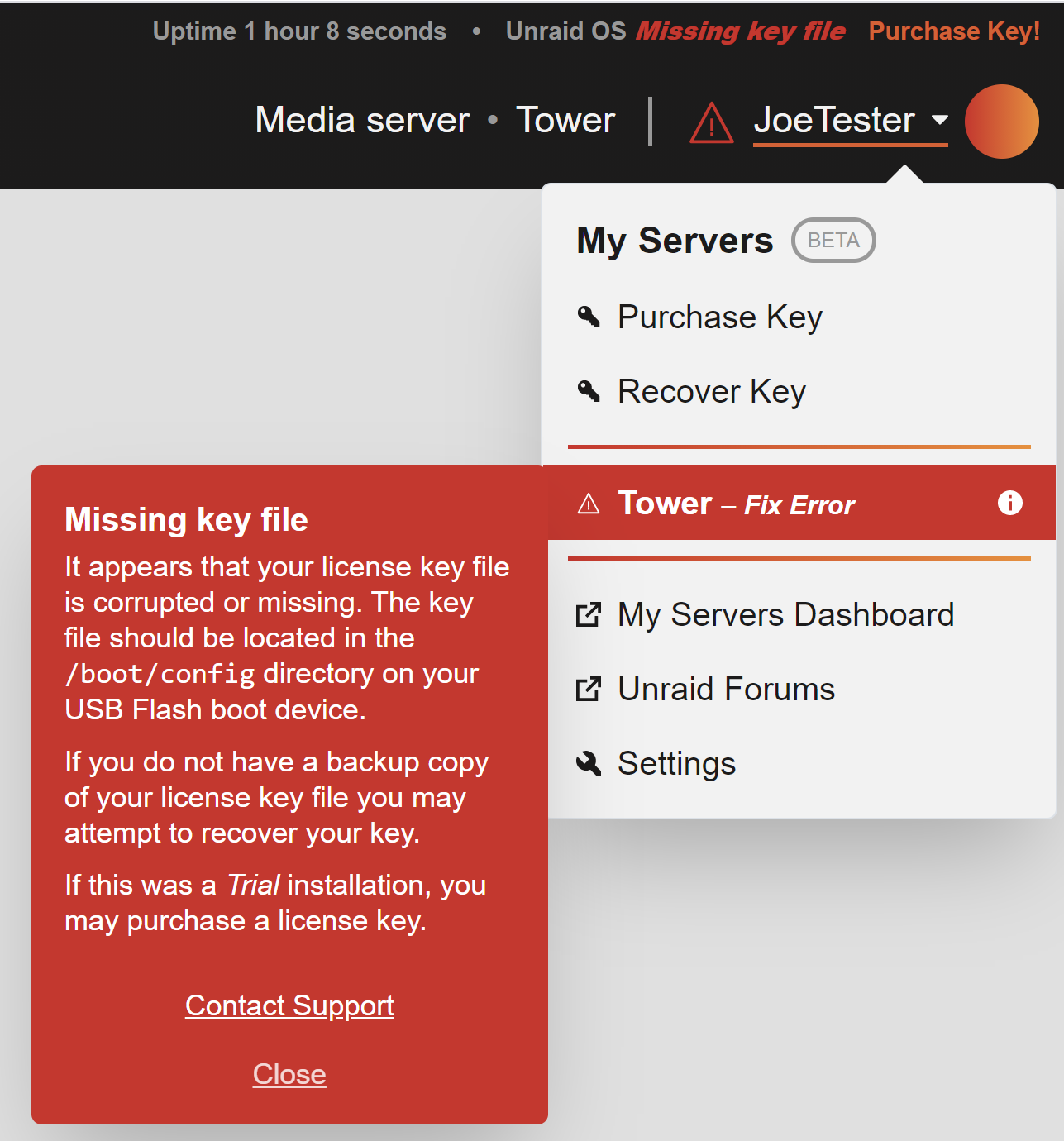

Corrupted/missing keyfile. I have re-sent the keyfile to your email. Please try reinstalling

I re-sent the keyfile. If you copy paste this into Tools-> Registration -> Install Key, does the issue persist?
