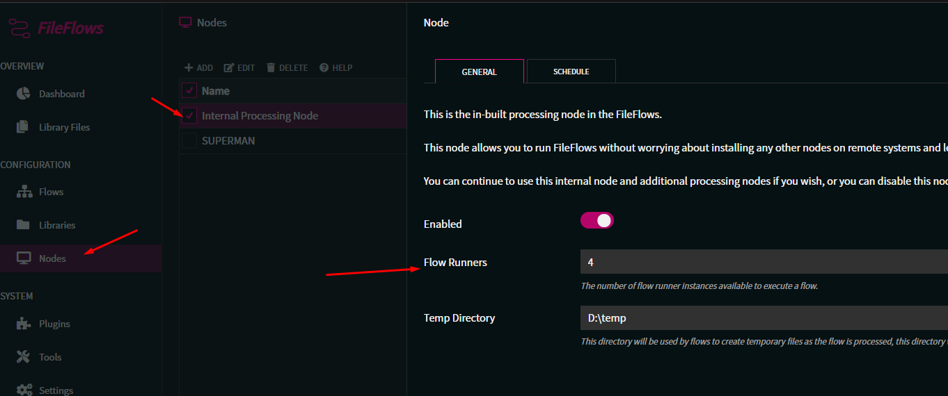

Is there any way to set this up to run multiple encodes at once?  Do I just make duplicate flows?
  1. Go to "Nodes"
  2. Edit "Internal Processing Node"
  3. Change "Flow Runners" to how many you want to run at the same time
  4. Save

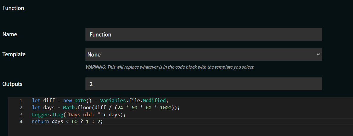

Has anybody figured out a way to guide a flow based on file age?
For example, I'd like to compress files older than 60 days for archival
I'm sure it's possible with a function block (it seems to have file.modified?) but I'm not sure where to start with that.

This isnt the best place for support, discord is quickest, then github.   I rarely check here tbh.
So you can achieve this by using a "Function" node.   with the following code
let diff = new Date() - Variables.file.Modified;
let days = Math.floor(diff / (24 * 60 * 60 * 1000));
Logger.ILog("Days old: " + days);
return days < 60 ? 1 : 2;
Where output 1 will be less than 60 days old, output 2 is greater than 60 days
