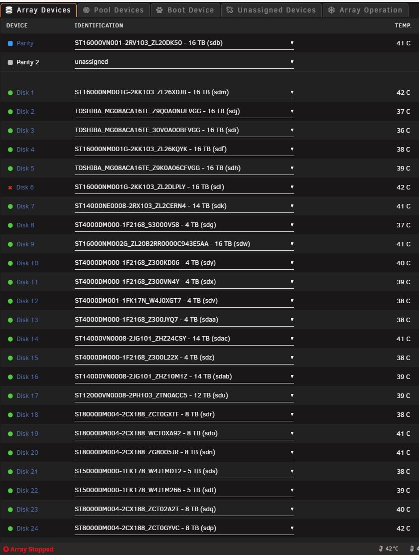

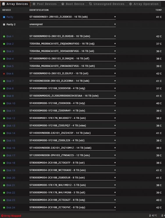

I have stopped the array.
Never done a new config before.
So... in the tools/new config, do I need to preseve any current assignment?
Also, will I allocated the original 16TB drive as the parity and although drive 6 still showing is showing as diabled do I allocated the respective drive to it?
(Screen shot attached).
Sorry, just want to be safe than sorry and avoid any data loss.
Thanks.
Al
Preserve all. New config will allow all disks to be accepted just as they are as a new array, and rebuild parity.
New cables added.
18TB Parity drive added.
New config config'ed.
Rebuilding with no errors so far.
Happy days.
Thank you for all your help and fast reply.
