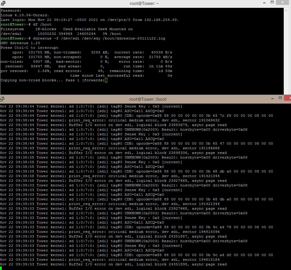

Running ddrescue.
is there a good link that tells me what the different labels mean?
Some are obvious but others not.
i.e. non-trimmed = space that is bad during 1st pass? But that doesn't seem to match what I get when I subtract the rescued ammount from the opos number. Also, Bad Sectors and Bad Areas and Error rate are 0 but have 76 read errors.
The most important part is the percent rescued, in the end it's usually 99.9% for most cases, though it can be much less for really bad disks, there's also an option mentioned in the FAQ that can list the affected files, so you can delete/restore them.

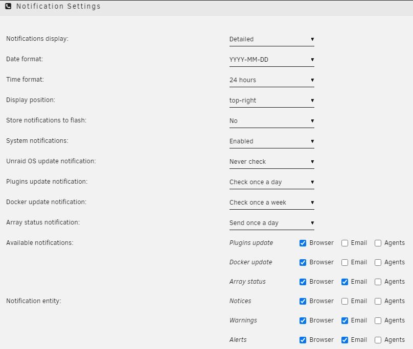

Do you have Notifications setup to alert you immediately by email or other agent as soon as a problem is detected?
I set it up last month, prior to Nov 6th Parity Check which ran without issue.
Never saw anything for Disk18 until the Parity-Resync when I tried to replace the Parity drive with a larger drive.
Unfortunately stuff had written to the array during that process so the old parity drive wouldn't be usable.

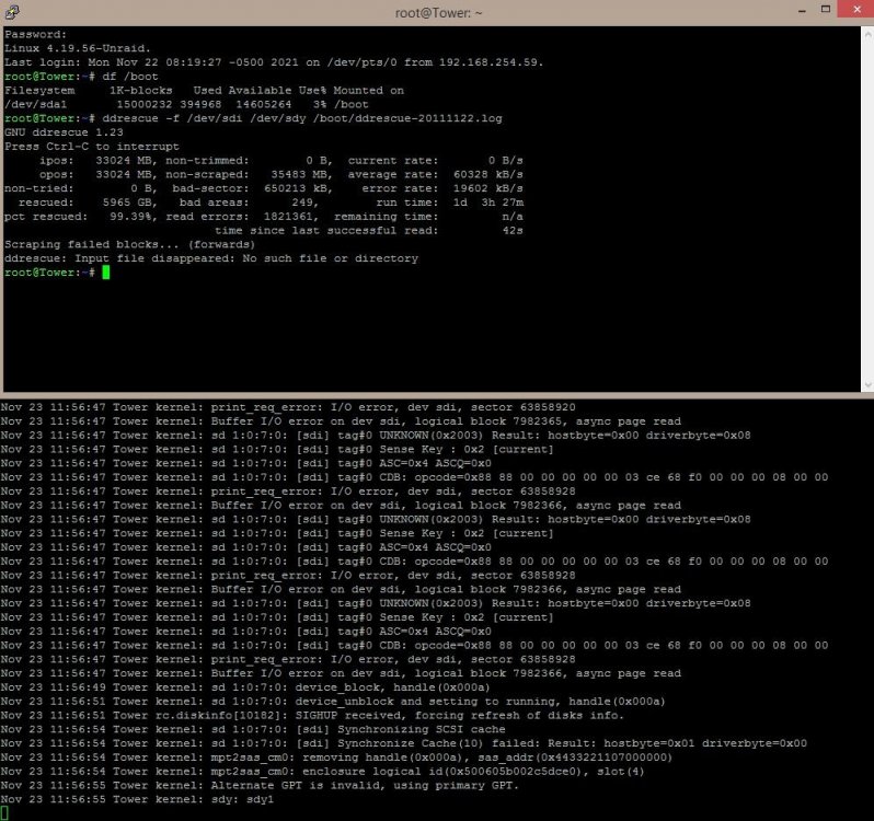

What should I do now at this point?
ddrescue: Input file disappeared: No such file or directory
looks like the source disk went offline?

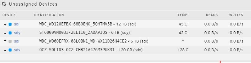

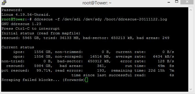

Looks like it dropped offline, you can try power cycling the server, if the disk comes back online run the command again (check the drives identifiers are still the same, if not adjust as necessary), use the same log file and it will resume.
Could I stop the ddrescue scraping failed blocks, then mount the destination drive to check on a couple files (and maybe copy them to another drive), then stop array, unmount the drive, and then restart ddrescue again?
That's OK if you mount the disk read only, you can do that with UD, don't mount read/write or some data will be changed just by mounting/unmounting and that can cause issues.
