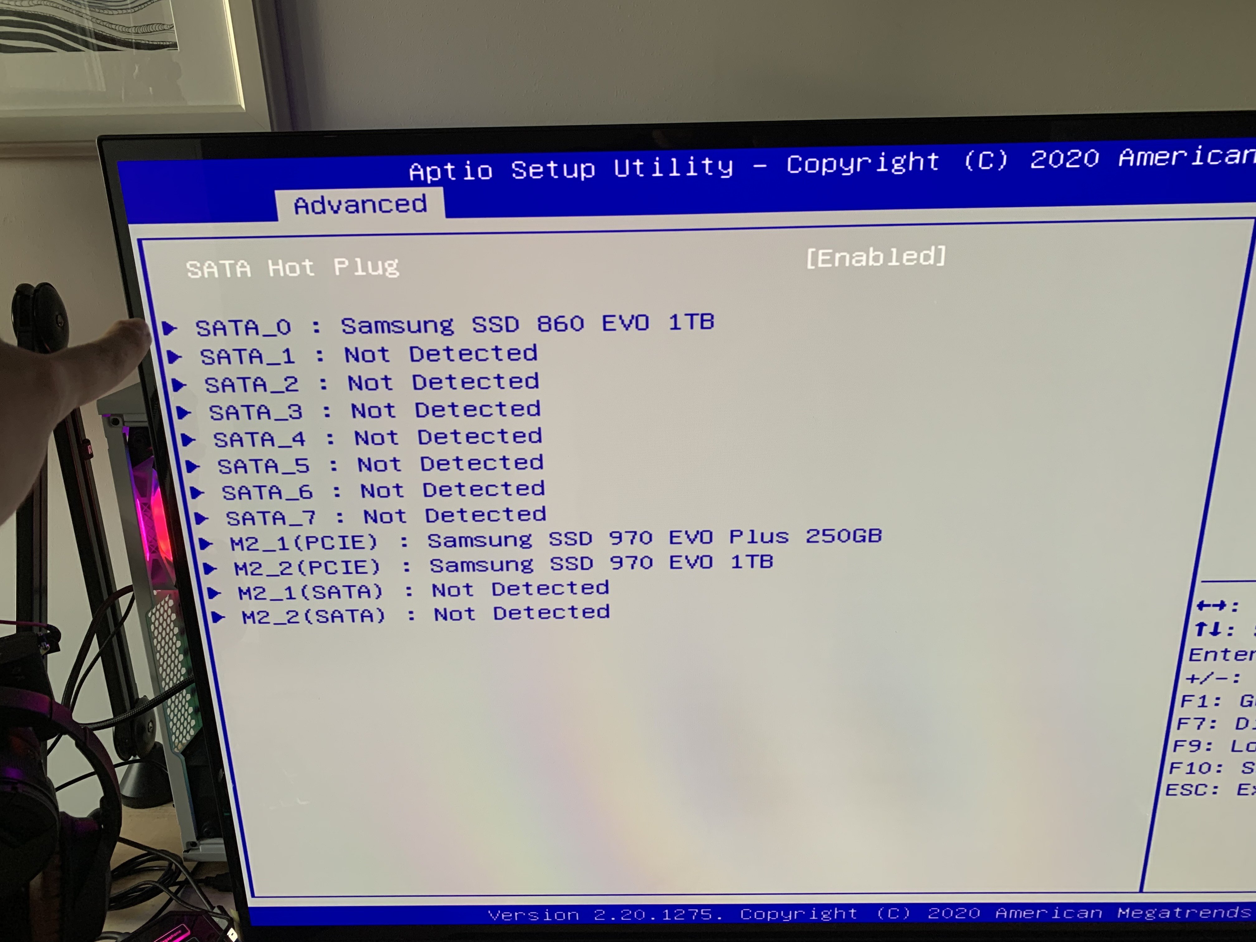

I'm trying to set up my unraid with an ssd, the ssd is visible in BIOS(and windows 10), but not on UNRAID unraid-6.10.0-rc2, also in unraid-6.9.2.
My config:
mobo - ASROCK ROMED8-2T
cpu - AMD EPYC 7702
gpu - NVIDIA GTX 1070
nvme - 1x250gb samsung, 1x1tb samsung
ssd - 1x1tb samsung

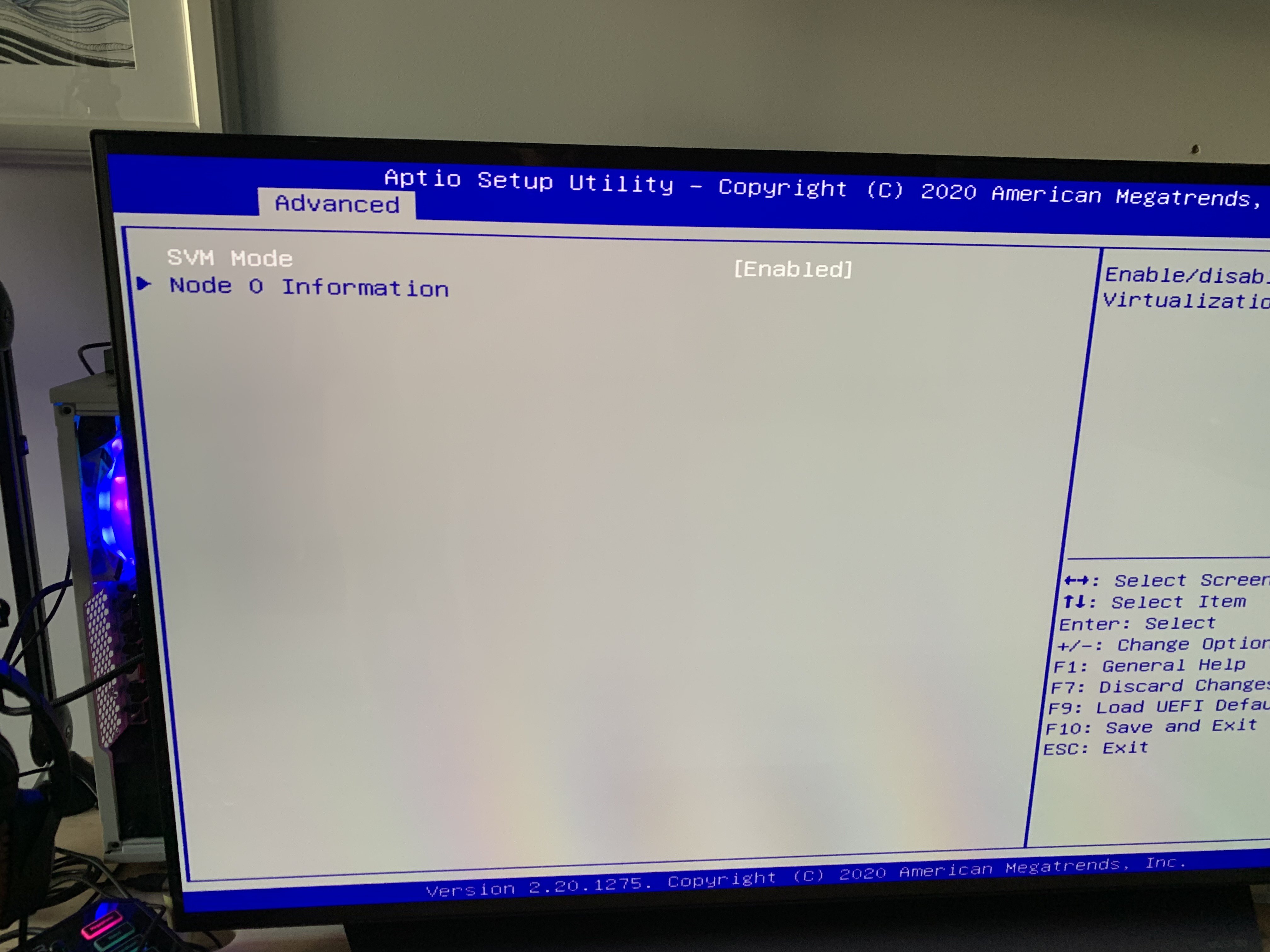

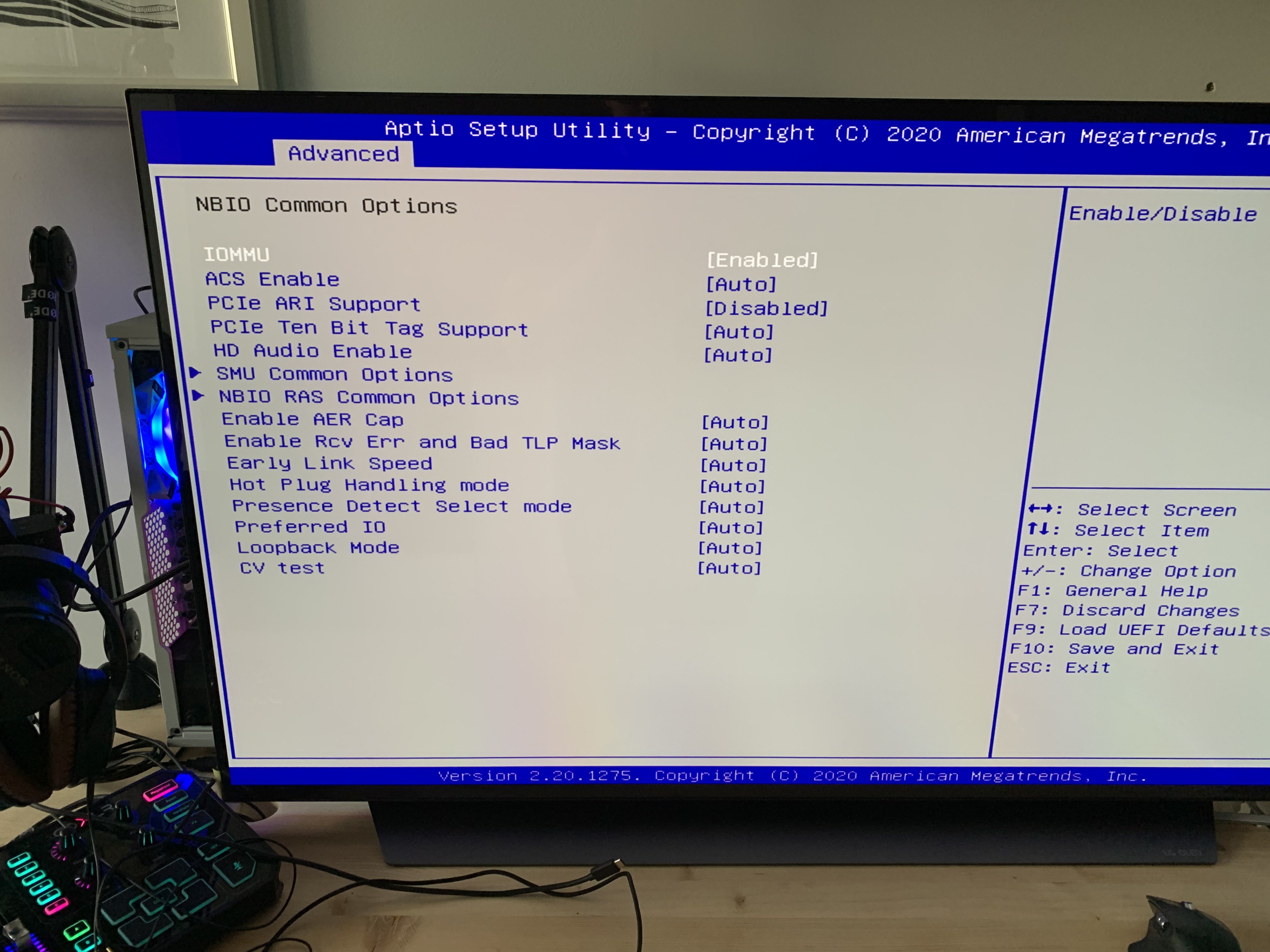

2. Tried adding amd_iommu=on, also amd_iommu=pt in the syslinux/syslinux.cfg
label Unraid OS
  menu default
  kernel /bzimage
  append initrd=/bzroot amd_iommu=on
label Unraid OS
  menu default
  kernel /bzimage
  append initrd=/bzroot amd_iommu=pt

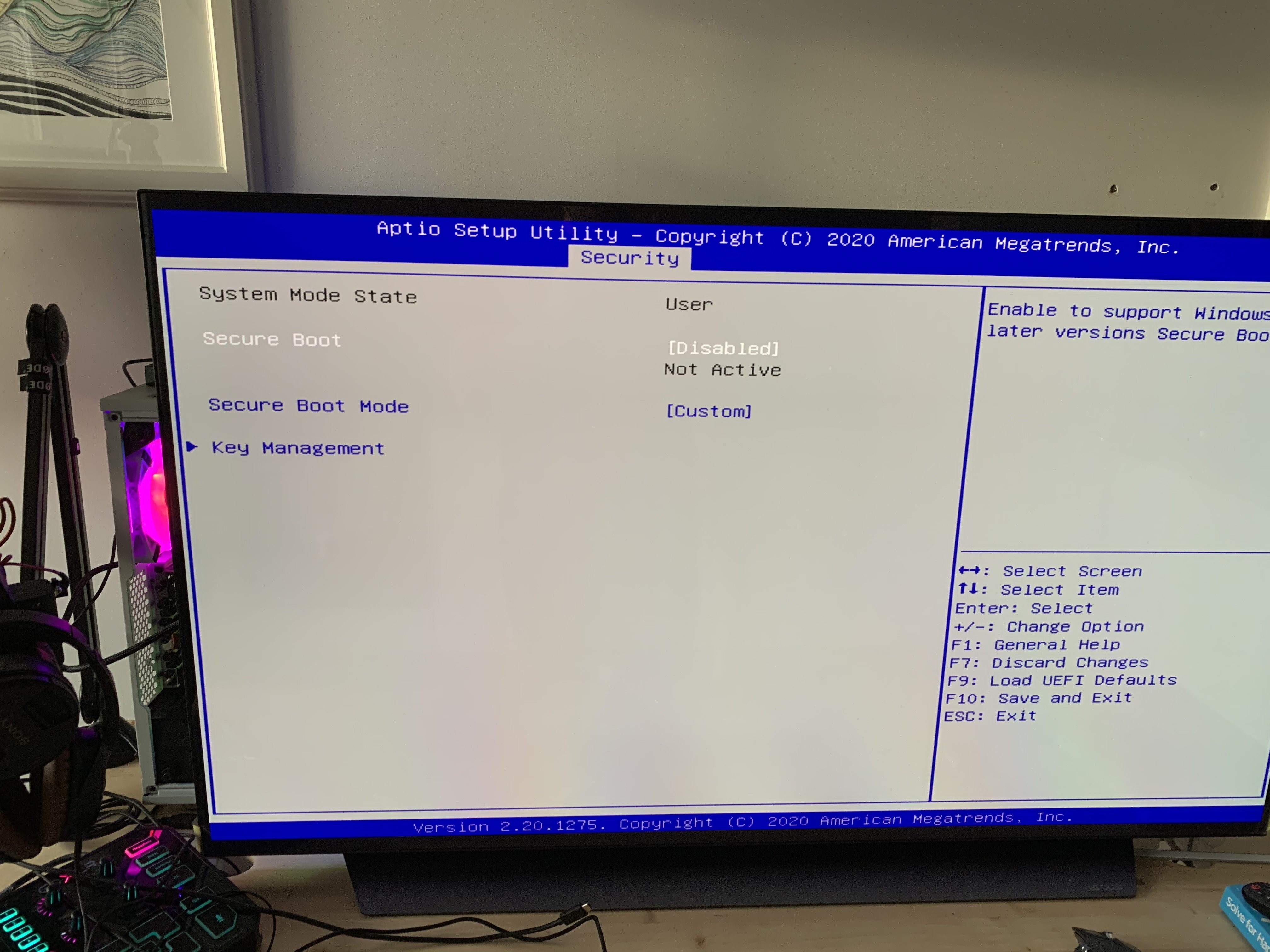

Also if I set Secure Boo to Enabled, the usb with UNRAID does not boot anymore.

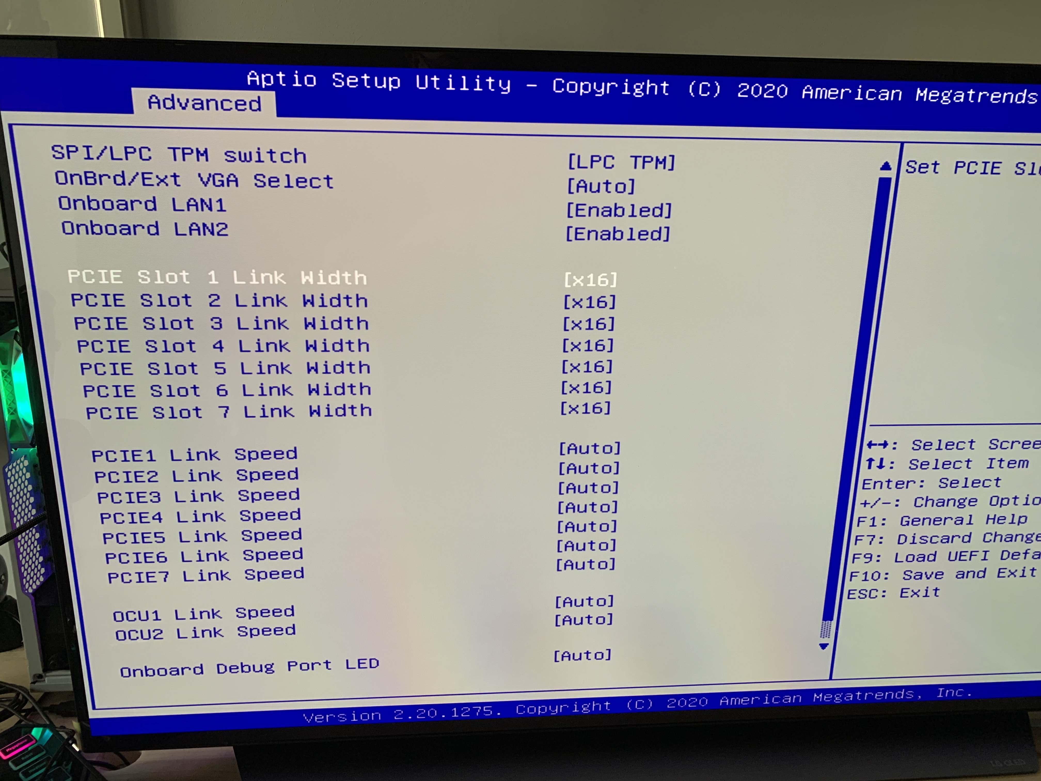

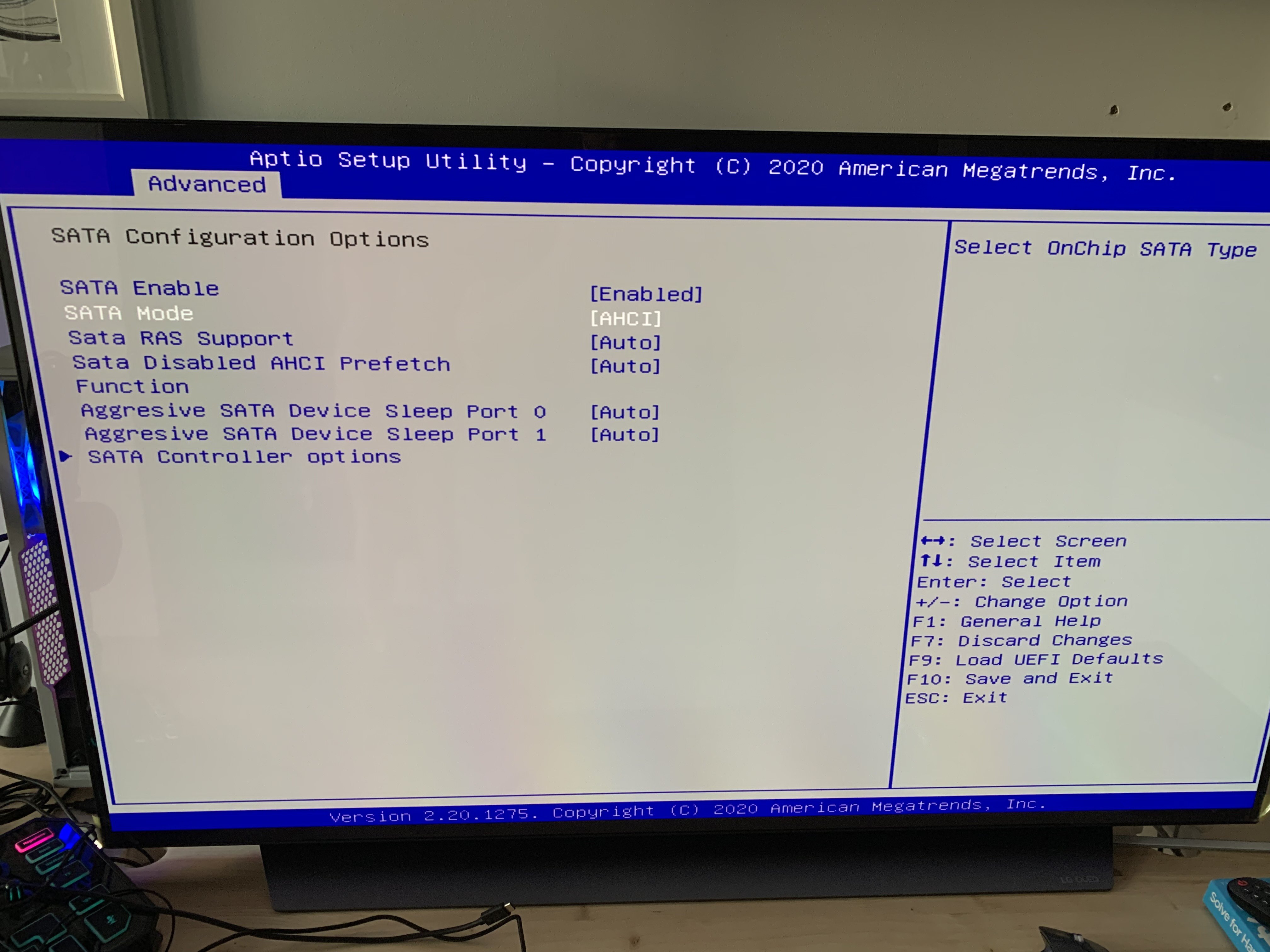

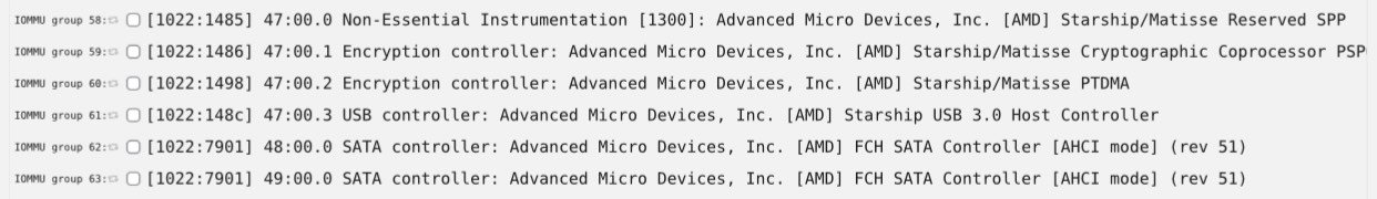

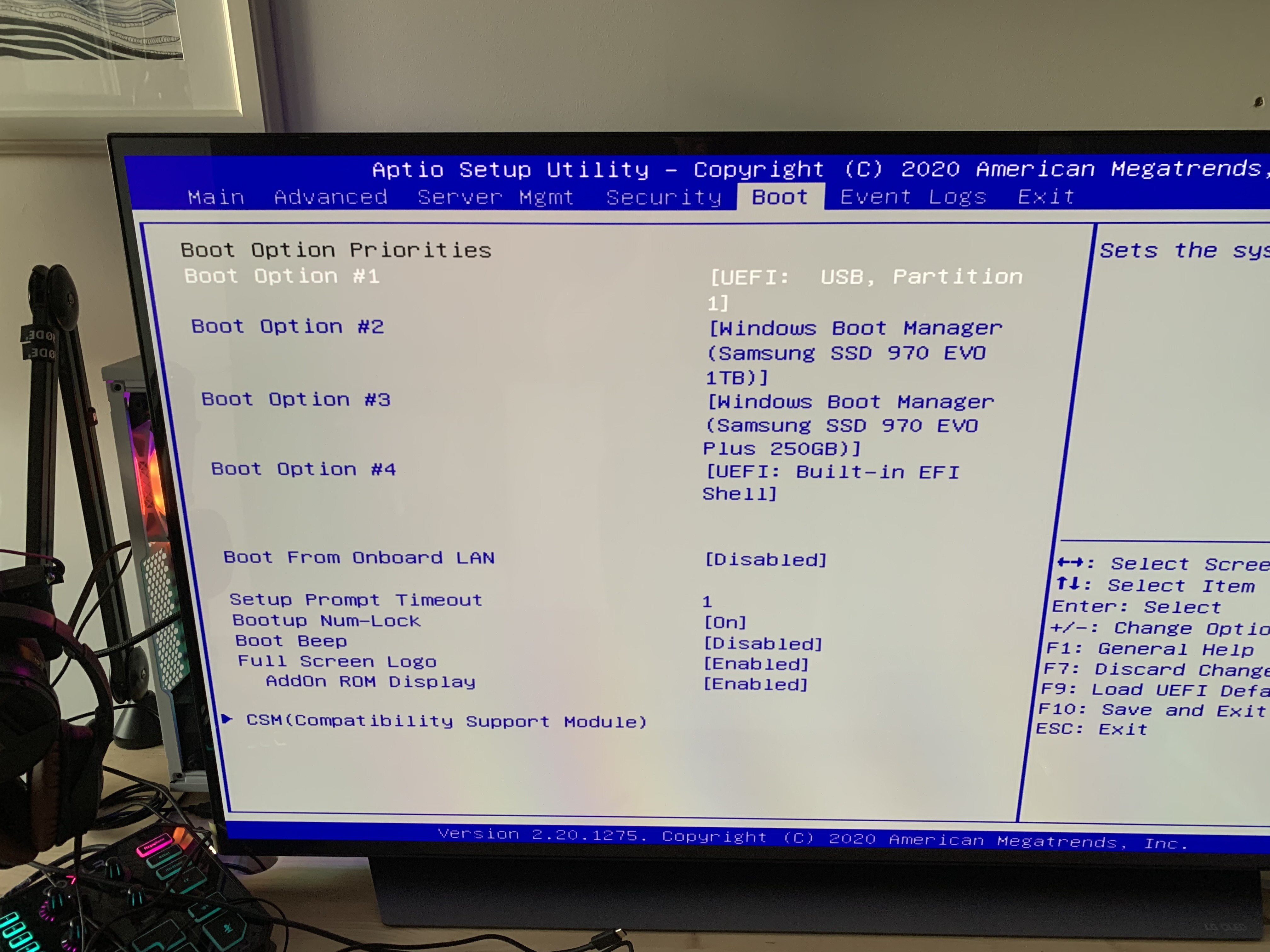

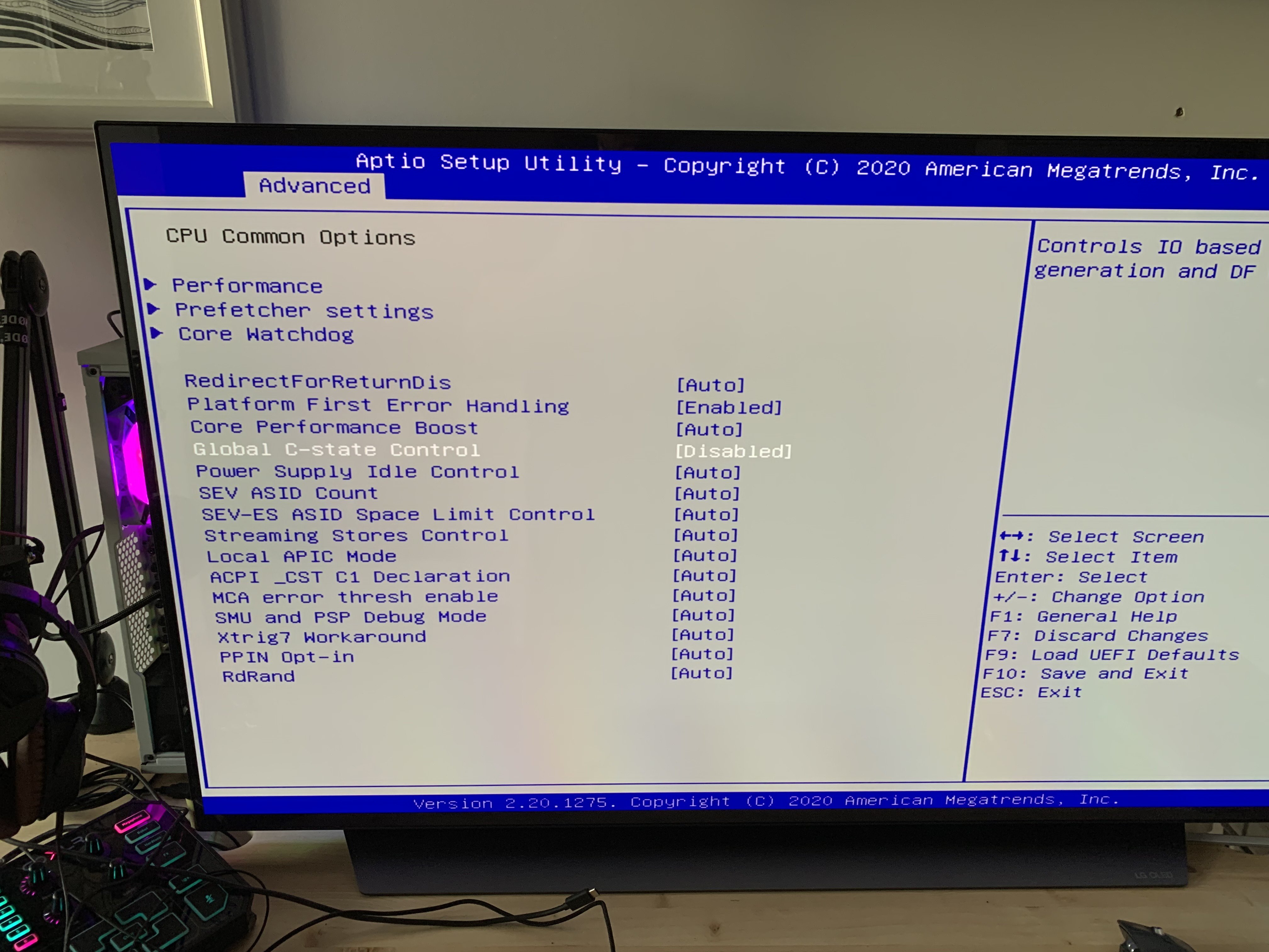

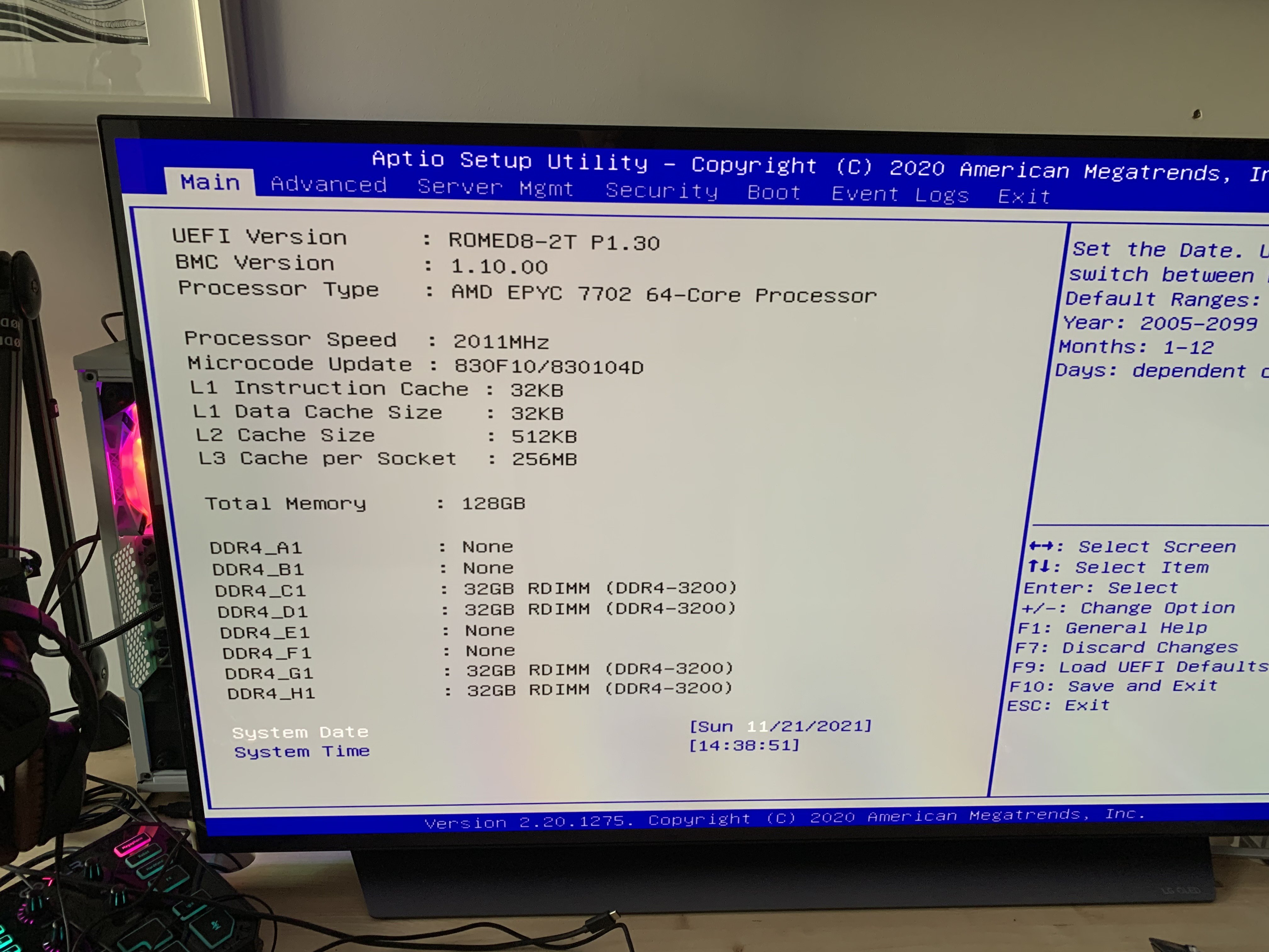

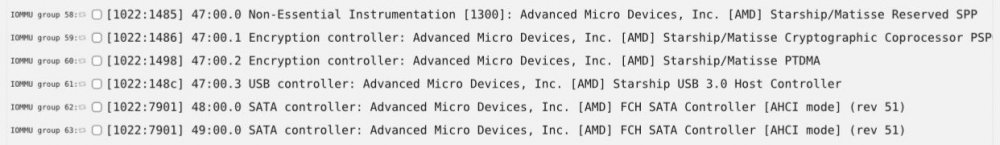

I attached some images of my bios config, and UNRAID iommu groups for sata controllers, also diagnostics.zip.

There's something weird going on with the SATA controllers, syslog shows 4 different controllers, with 8 ports each, and then one of them fails to initialize:
Nov 21 06:40:49 Tower kernel: ahci: probe of 0000:49:00.0 failed with error -22
Look for a BIOS update or try with a different Unraid/kernel version.
