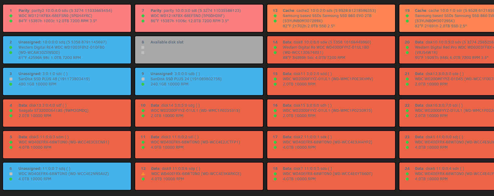

Since you rebooted before getting the diagnostics syslog doesn't tell us anything before that. And I can't tell what disk was assigned as disk4, but there are several unassigned disks in your smart folder.

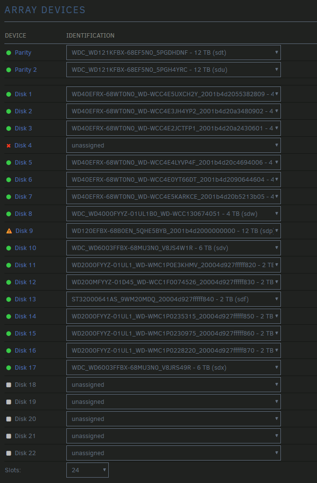

Post a screenshot of Main - Array Devices
I mapped these out shortly before everything went south, so it should be correct as how things are supposed to look.
According to that screenshot of Main - Array Devices, nothing was assigned after disk17. Did you do New Config at some point?
No, that is how it came up after the very first reboot after the alarm. When I log into the BIOS of the RAID card I can see all the same disks are still attached, but for some reason they are just not visible to UNRAID.

Disk 17 is on an LSI controller together with 7 other devices, and all are being detected, also unless you loaded an older Unraid config there are only 17 data disks, look at the screenshot you posted, there are 24 devices total, including cache devices, unassigned SSDs and disks, and an empty slot, you don't even have disk 17 there.
My issues is that 18, 19, 20, 21, 22 as well as 4 all show as unassiged with no option to select the drives that are actually connected to them. I did not load a new config what you see is how it just came back online are the reboot. Prior to that reboot all the drives were assigned a drive and nothing showed as unassigned. That said, I did have 3 drives I believe that were not part of the array.
Now I"m just trying to determine how I get the missing drives back so I can restart the array.
I now see what everyone has been talking about as far as the counts go. I just finished going through and pulling all the drives to verify what was where. It appears the only drive UNRAID is not picking up is the 4TB drive with serial number WD-WCC4E3CECN91, which I suspect should be in Disk 4. I have another drive on the way in the event the drive just died. Should I wait to receive the drive before spinning up the array and restarting the rebuild process on my other failed drive?
