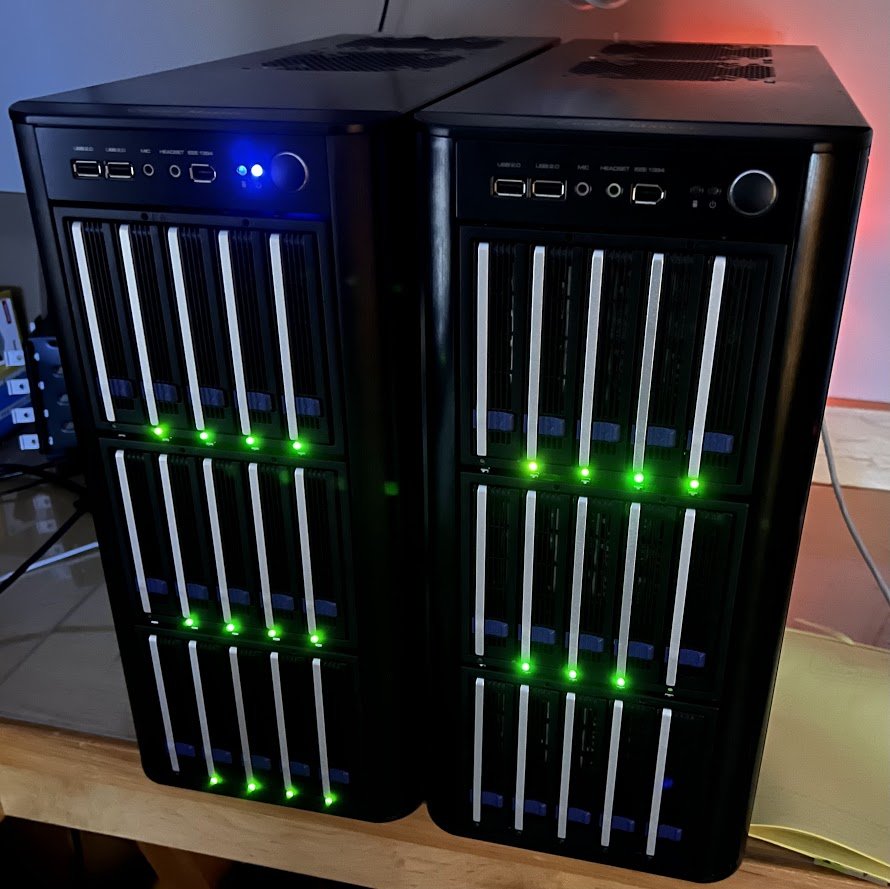

Hi all,
I have just added 6, 5in3 MB155SP-B drive cages across two different mid tower cases. They are connected and powered, but the leftmost slot of each of them does not show a green LED and does not power up its drive. I tried swapping SATA data connectors with one of the working slots. I tried powering via a molex to sata convertor. I tried different combinations of drives and connectors. Always no LED, and no power to left drive.
I can't imagine that I managed to get 6 lemon drive cages. I must be missing something basic. Does anyone have any suggestions?
Thx.

Yes. There are 3 sata power connectors for each unit. They seem to be connected to each other in parallel. I tried powering each of the three connectors individually and a single connector powers the whole unit.

I finally modified the Rosewill case to avoid installing the Icy Dock upside down and everything is working now. Some drive connectors were not properly aligned even with the tray fully closed so they were not getting power.
Icy Dock support said that the dock would work upside down but that I might have to fiddle to get the drive to properly align with the connectors on the backplane. Maybe you have a similar issue?

Thanks very much! I’ll try flipping one the other way around. I actually don’t know which way is “up” anyway. It’s also useful to know that it might be a connection issue between the drive and the cage.
Probably safe to consider that the pictures on Icy Dock website show the standard orientation.
