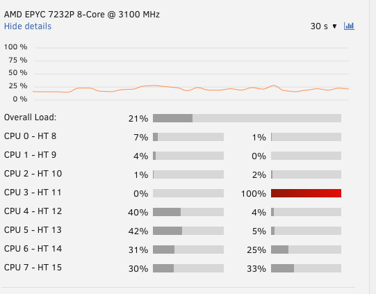

[SOLVED] 1 CPU core stuck at 100% - How can I find out which service is triggering this?
One of my CPU cores is stuck at 100%. No Backup / Parity check running. How can I find out which service is triggering this?
I have one VM running, but that is pinned to different cores.
900869313_Bildschirmfoto2021-11-22um09_52_26.png.916cf52f92d365705df27e6d6e688146.png
Any advise? :)

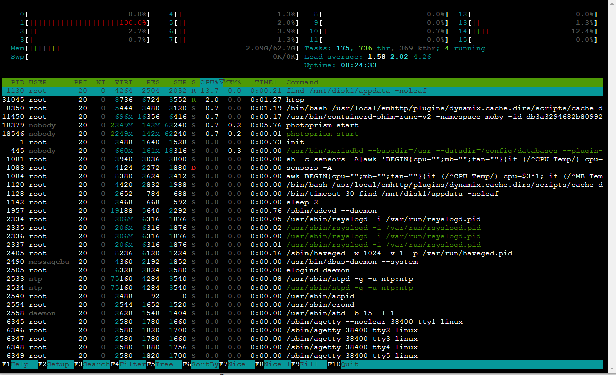

don't think htop adds a lot of detail here:

What's that running find process?

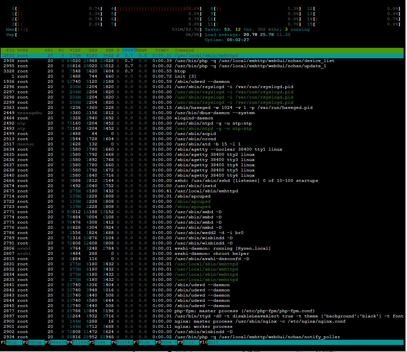

safemode, no gui. Array offline.
Same situation one core at 100%, all other cores idling.

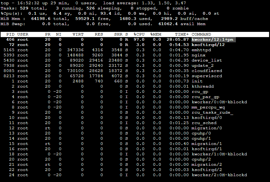

Top shows this -
Who is that "kworker/12:1+pm" guy?

  • doesntaffect changed the title to [SOLVED] 1 CPU core stuck at 100% - How can I find out which service is triggering this?
I swapped all PCIe cards in out and tried different slots. At the end I can reproduce the issue, 1 - 2 CPU cores get stuck at 100%, if I plug a PCIe card (tested with Fenvi T919, Inateck RedComets U26, Radeon RX560) into PCIe slot 6 (second from top) on the Asrock Rack RomeD8-2T board. Consequently, leaving that slot empty I can add following cards without issues:
