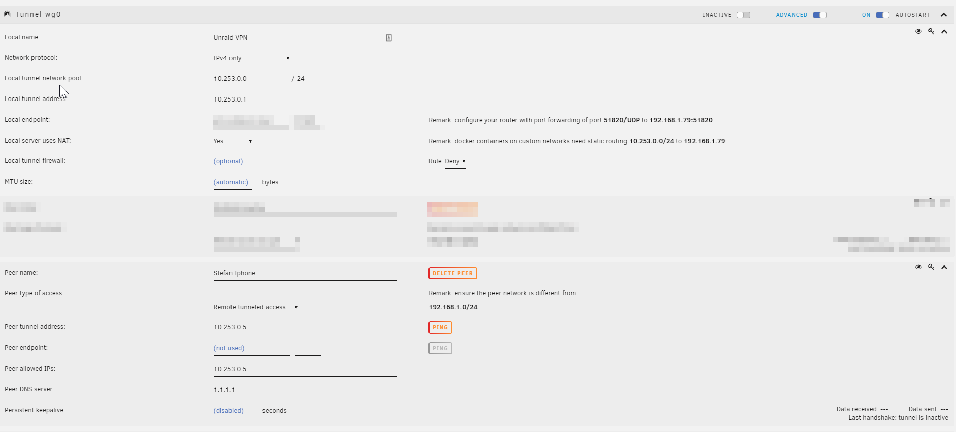

I had a setup for my vpn tunneling and it worked ok till recently.
Im not sure why it stopped working.
Now, when I want to connect from my phone through wireguard to my Unraid, I can't, and also, I don't have internet on my phone when Im connected over vpn (wifi/4G).
So here is my setup flow:
1. I have static ip address and I have a domain mapped to port 51820, vpn.something.com:51820
2. I setup port forwarding from my primary ISP Calix router to my udm-pro secondary router which is on ip 10.10.10.4 (this is DHCP IP range from primary router, secondary router has range from 192.168.1.1)
3. I have also installed nginx manager, so, basically, when request hits, it knows to delegate to right container, or whatsoever.

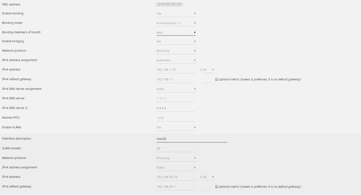

4. Eventually, I added VLAN20 (192.168.20.1) in my udmpro, and connected to my unraid which is now on 192.168.20.79 (instead on 192.168.1.79)
Here is mine setup of vpn settings, also network settings:
network:
What I have tried so far:
