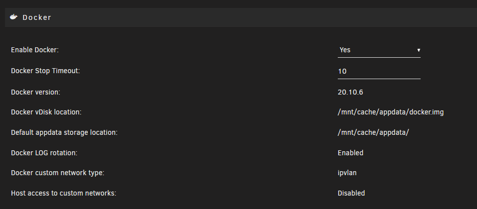

10 minutes ago, Scripter said:
I've attached the diagnostic file to this post and below is traces from the syslog went the computer froze today
Your first call trace is the macvlan broadcast call trace when docker containers are assigned custom IP address on br0.  This is well documented in this thread.  That particular call trace will not always cause immediate lockups, but eventually you will get a server lockup from these call traces.
Edited by Hoopster
14 minutes ago, Scripter said:
I'm currently on 6.10 rc2.
Version 6.10 allows the docker custom network type to be set to ipvlan instead of macvlan.  This setting was introduced to try to work around the macvlan call trace issue.  For some it has helped.
Since I implemented a docker VLAN on my router and switch, the problem has disappeared for me.
THanks for the information. I'm trying out the ipvlan option now after my server frozen again this morning. Let's see if that resolves the issue
  • 5 weeks later...
This seems to have solved my issue. 21 days of uptime without seeing that error in the log and the not stalling
