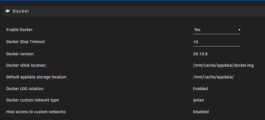

By default in Docker, there is no communication between docker containers and the host (bridge or host).
Have you tried enabling Host access to custom networks in Docker settings?

I have not.  I read somewhere that host access to docker and vice versa was prohibited for security reasons so I'm a little unsure at this point what to do.
Maybe there is a better way of doing what I'm trying to do - I want to be able to send port forwarding to some dockers (i.e. plex) and have others go out over my VPN.  Since my router can assign vpn by IP I was assuming getting a separate IP for each docker that needed special attention was the best way to go, but maybe not.
