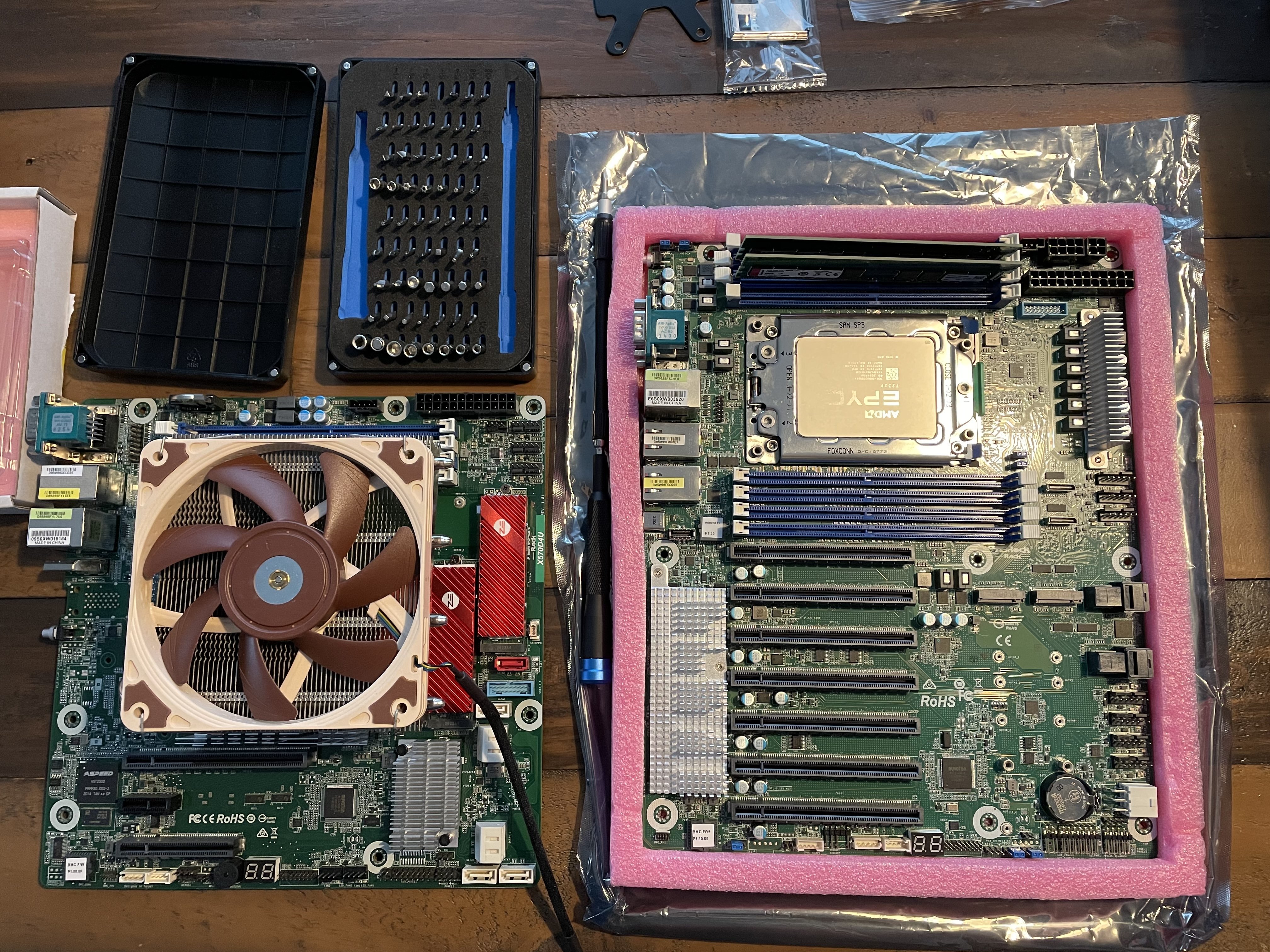

Build Process:

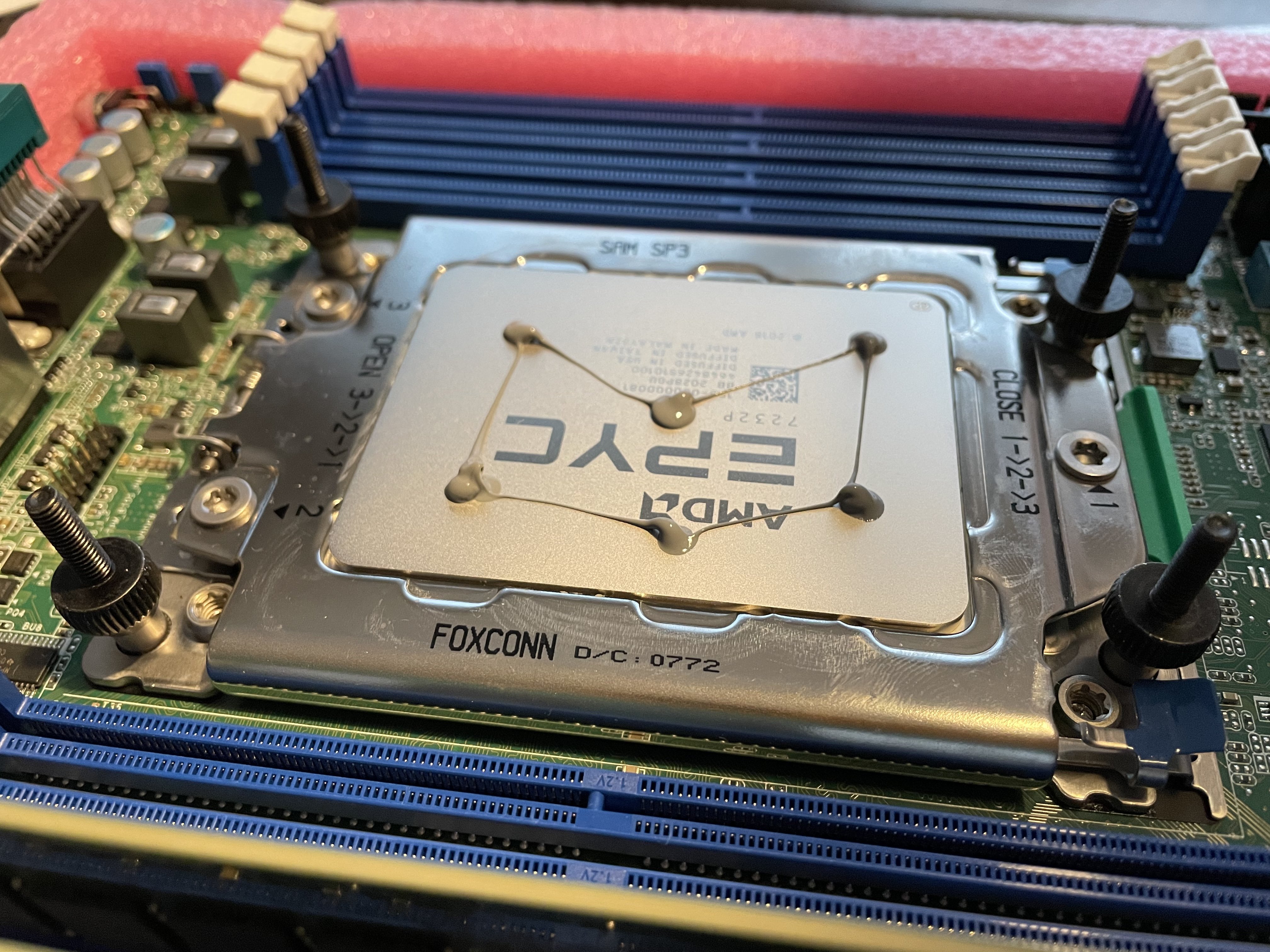

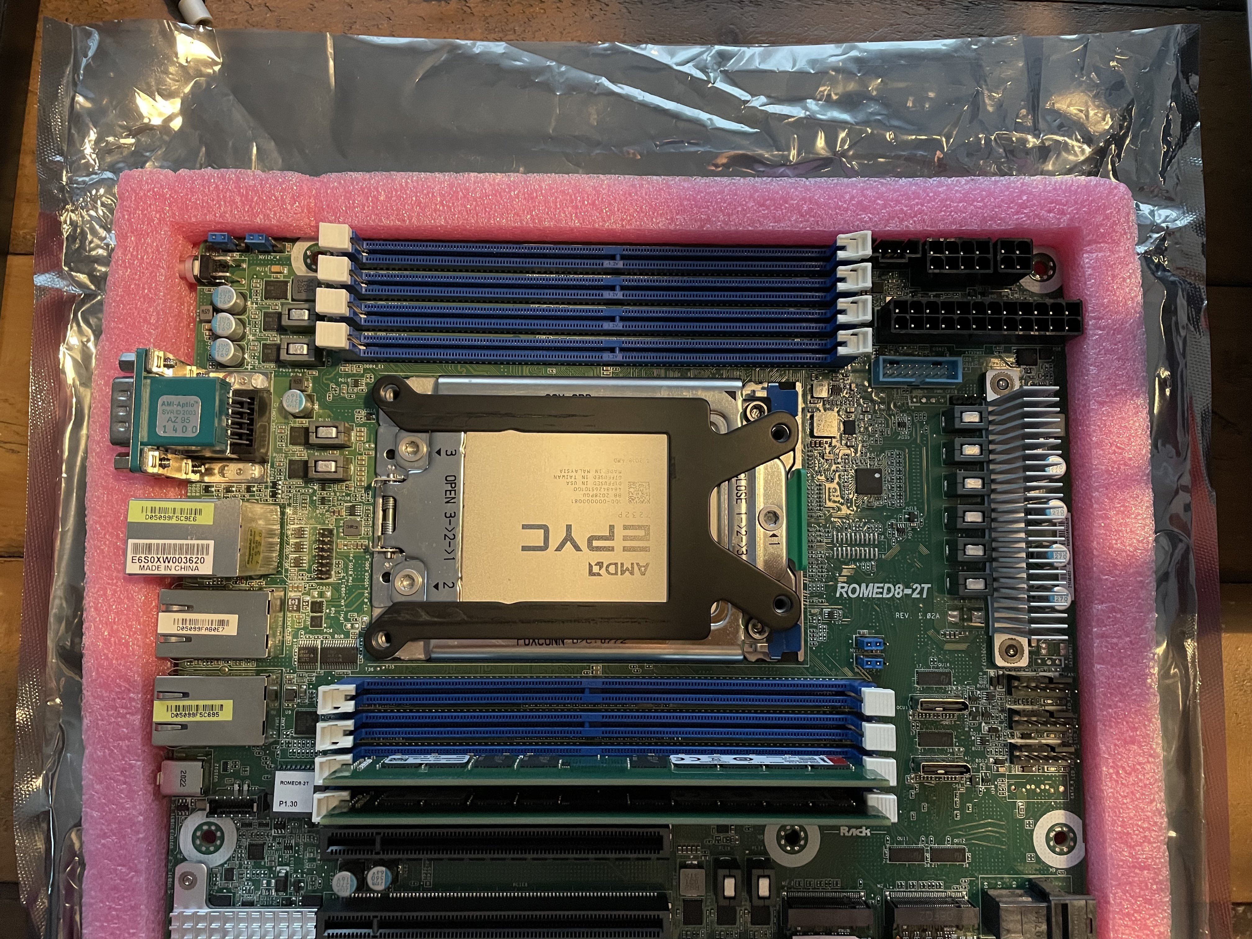

Switching from the Ryzen platform to the new board, CPU and Memory went smooth. Just replaced Board, CPU, Memory and cooling, plugged in the USB stick and booted. At the beginning of the build it hasn’t been clear to me that I had to buy registered memory (RDIMMs), which I did at the end after mailing with the support. The board does not boot with standard ECC memory which I have been using for the Ryzen (Debug LED gets stuck at 46). At the end I purchased the memory based on the RomeD8-2T QVL.
As you can see, it was a full swap. Old hardware has been sold.

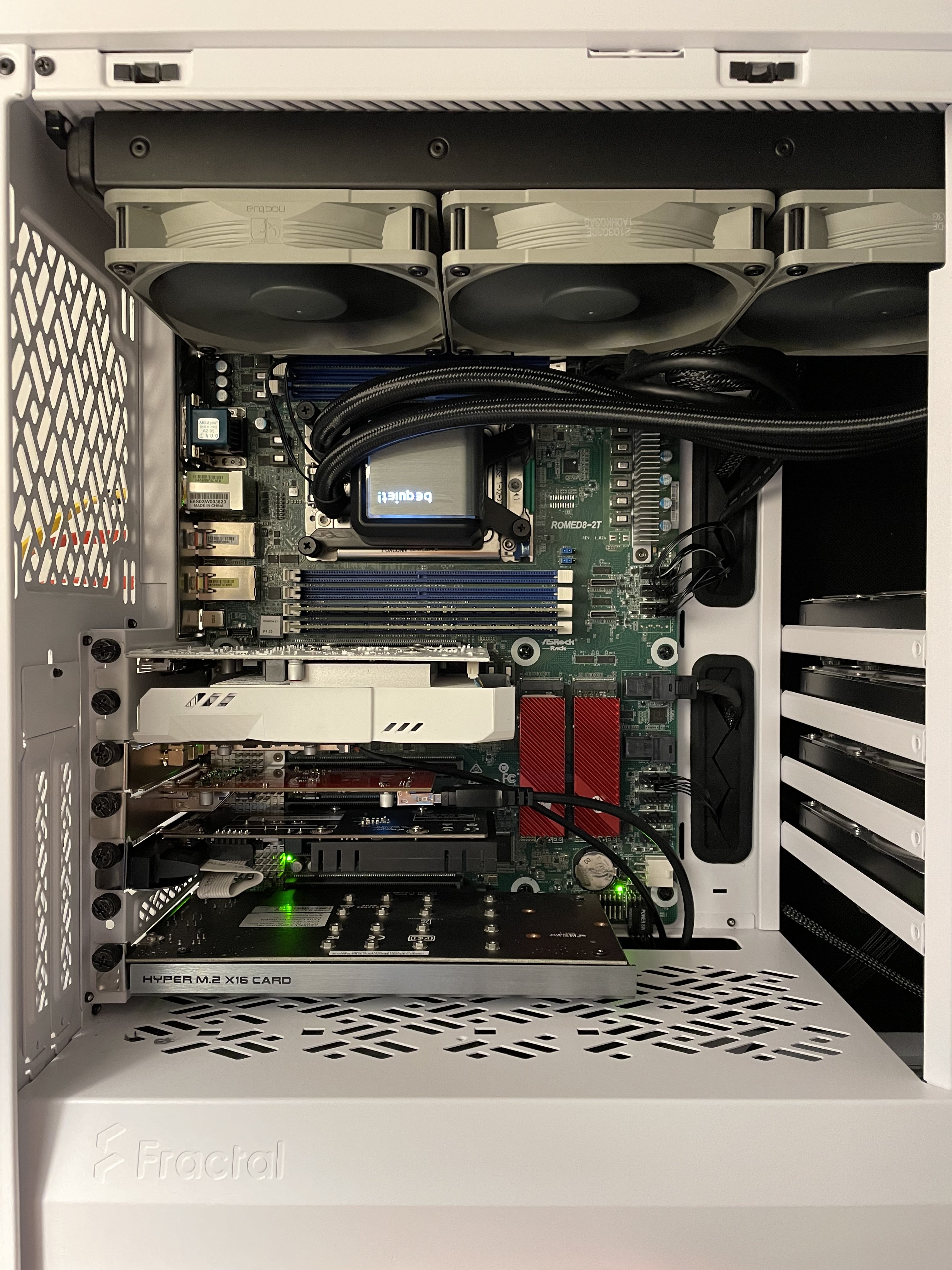

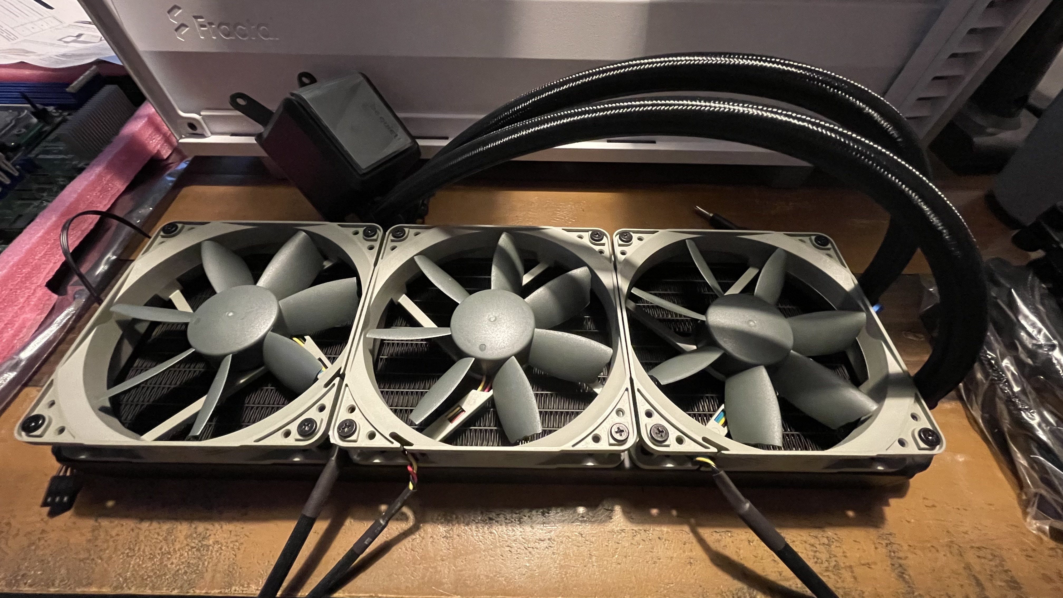

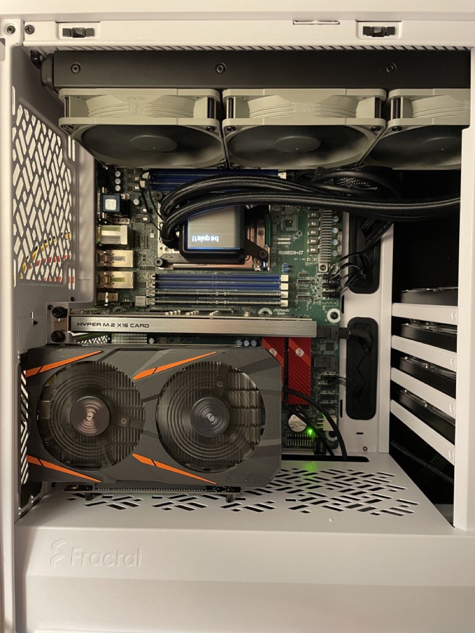

Cooling - I picked the Silent Loop 2 360 and replaced the stock fans with Noctua models, 2 PWMs and one fixed 700RPM fan. The cooling is exceptional quiet, the pump isn’t noticeable at all. To mount the pump unit on the SP3 socket I used the TRX4 bracket which bequiet sells. The original mounting bracket has to be pulled out of the pump (slides out) and the new bracket can be slided in - a 5 second job and the cooling is SP3 compatible. I used the stock by termalpaste that comes with the silent loop.
I also removed the rear fan since I do not see a need for it. Air is pulled into the case from front and bottom and pushed out at the top through the radiator. I am aware that this might cause slightly higher temps, but that’s no problem for me.
Radiator - The Radiator fits well into the case, however in combination with this board and both ATX & 12V Power Connectors I had to make compromises with the cabling. It still looks good, but I think I had to bend the cables a bit to much. The radiator in combination with the fans is basically to low and it is almost impossible to service the memory, cabling, cooling etc. once everything is fitted and mounted. Hence I‘ll get a Define XL, which has more head room above the board.
Everything fits nicely into the case, except when one wants to connect the case header (Power, Reset etc.) at the bottom of the board. Since the Pins are angled by 90° it is rather difficult to connect the header , see photo. It worked out at the end, but as written earlier I will swap the case with a Define XL in a few weeks to address these space limits.

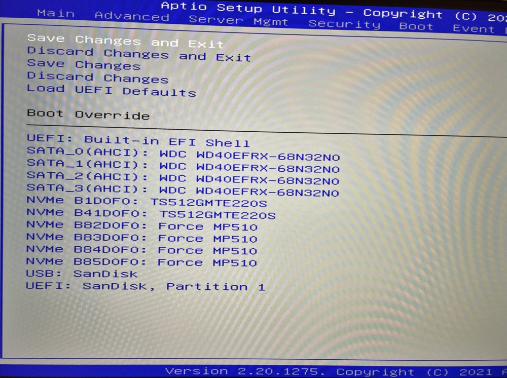

The onboard ASpeed VGA allows a headless setup and the board has a remote management interface, so Bios adjustments etc. can be done remotely. The BIOS is well structured but does not provide (at least I didn’t find it yet) any overclocking / under-volting options - The X570D4U does. What’s cool is that every PCI slot can be configured and in general terms I‘d say the BIOS allows tailoring the config to one‘s needs. I had to enable IOMMU, enabled Bifurcation for the Asus Adapter card and set the onboard VGA to standard. That was it more or less in the BIOS (for now). BIOS photos in the attachment section.

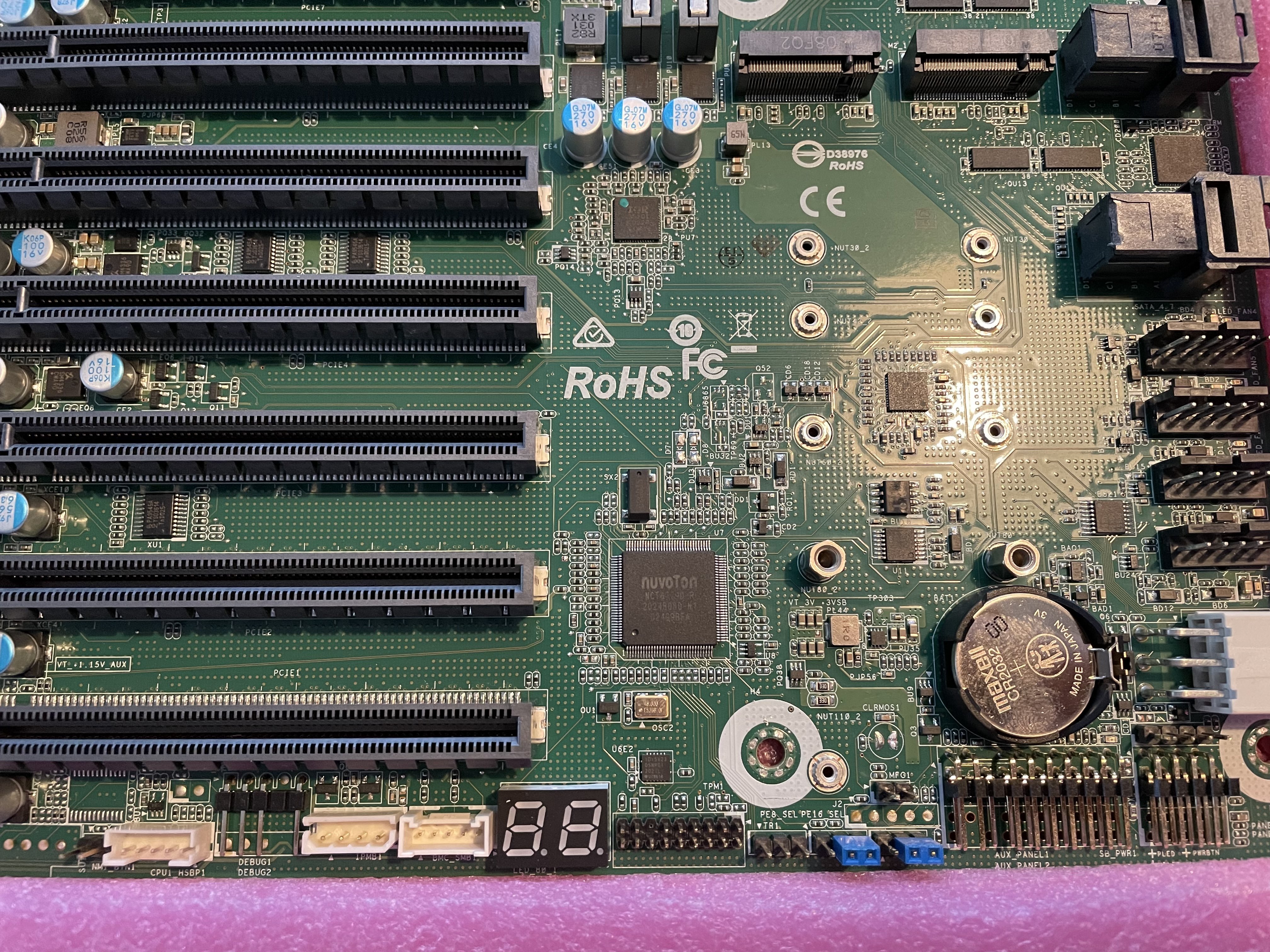

Once UnRaid was running with all the additional cards I noticed that 1 - 2 CPU cores constantly peaked at 100%, causing 10W higher draw and glitches in the VMs (Audio was hanging sometimes).
I pulled the cards and swapped them back and forth, at the end PCIe 6 (2nd slot from top) turned out to trigger this behavior, once it was occupied with a card like the Inateck or T919. So I adjusted the card setup and so far everything works fine. The slot is now covered by the GPU cooler. All additional cards, except the Asus Hyper M.2 adapter, are bind to VFIO and passed through the Hackintosh VM resp. the RX560 to one Win VM.

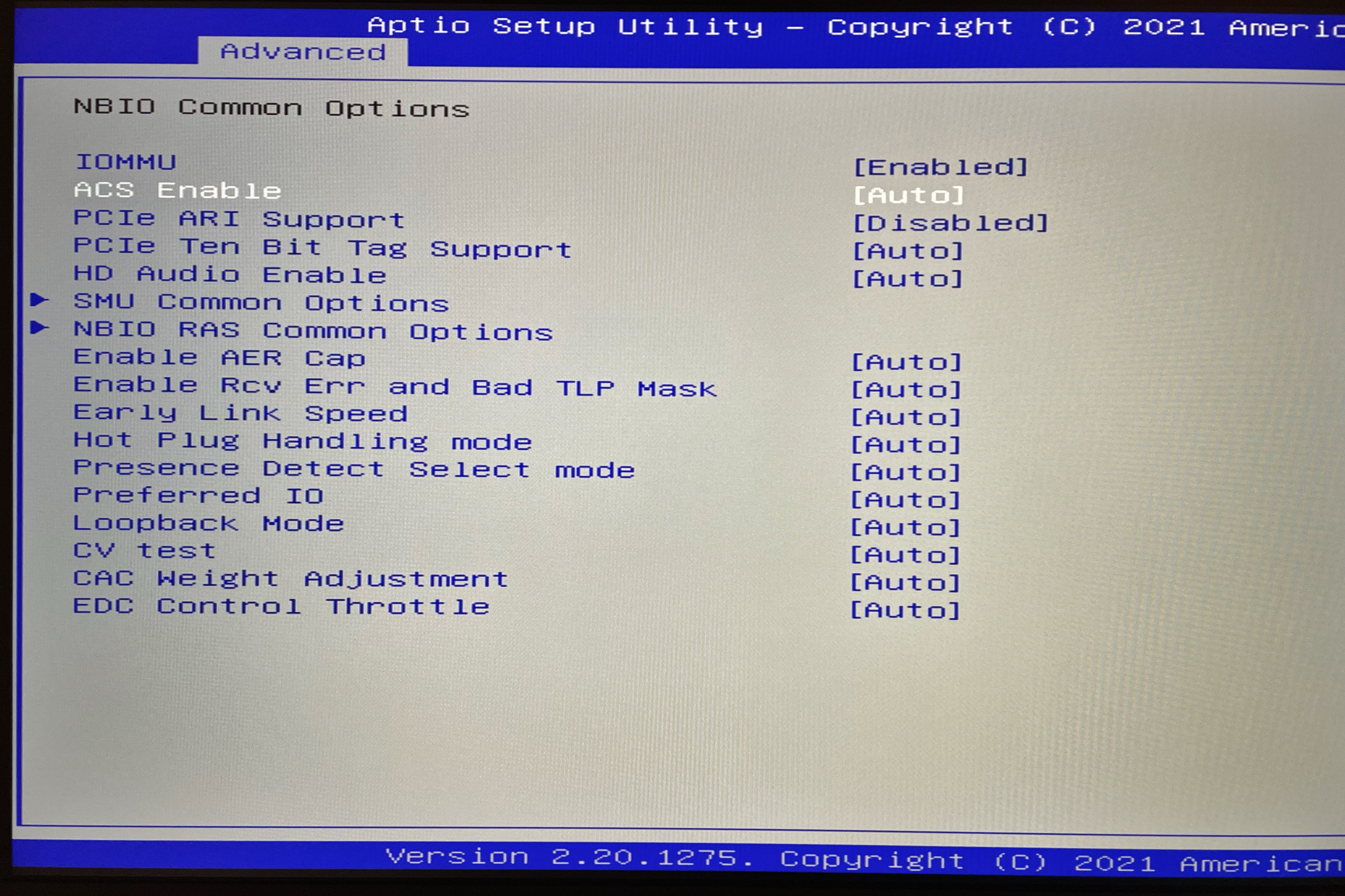

One of the main reason to move from Ryzen to Epyc was also to have more flex for the hardware passthrough for the VMs. Now that I have enough lanes and slots available it was easy to add a GPU, WIFI, BT and a USB controller for the peripherials so the virtual Mac acts close to a physical.
It took a few attempts to get the VM to boot (PCIe config was often wrong) and I must admit that getting a Hackintosh to work isn’t simple, but it is obviously doable.

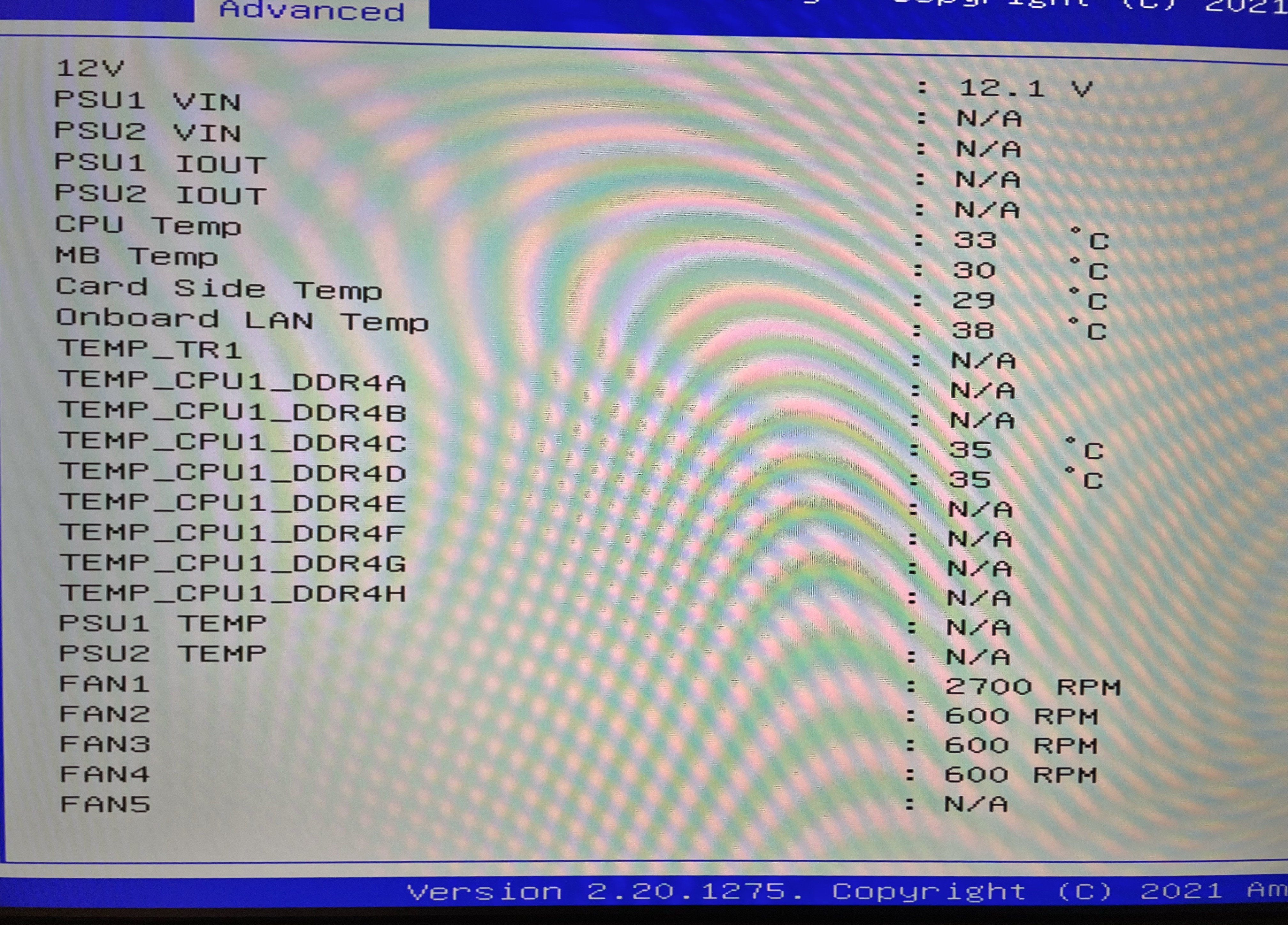

  • Idle draw is between 93 - 107W, RX460 increased the draw a bit compared with GT710
  • CPU Temperature is 37-39°C when idling, haven’t stressed the CPU yet.
  • SSDs 34 - 35°C  (onboard slots), 4 NVMEs in the Asus Adapter 38 - 40°C

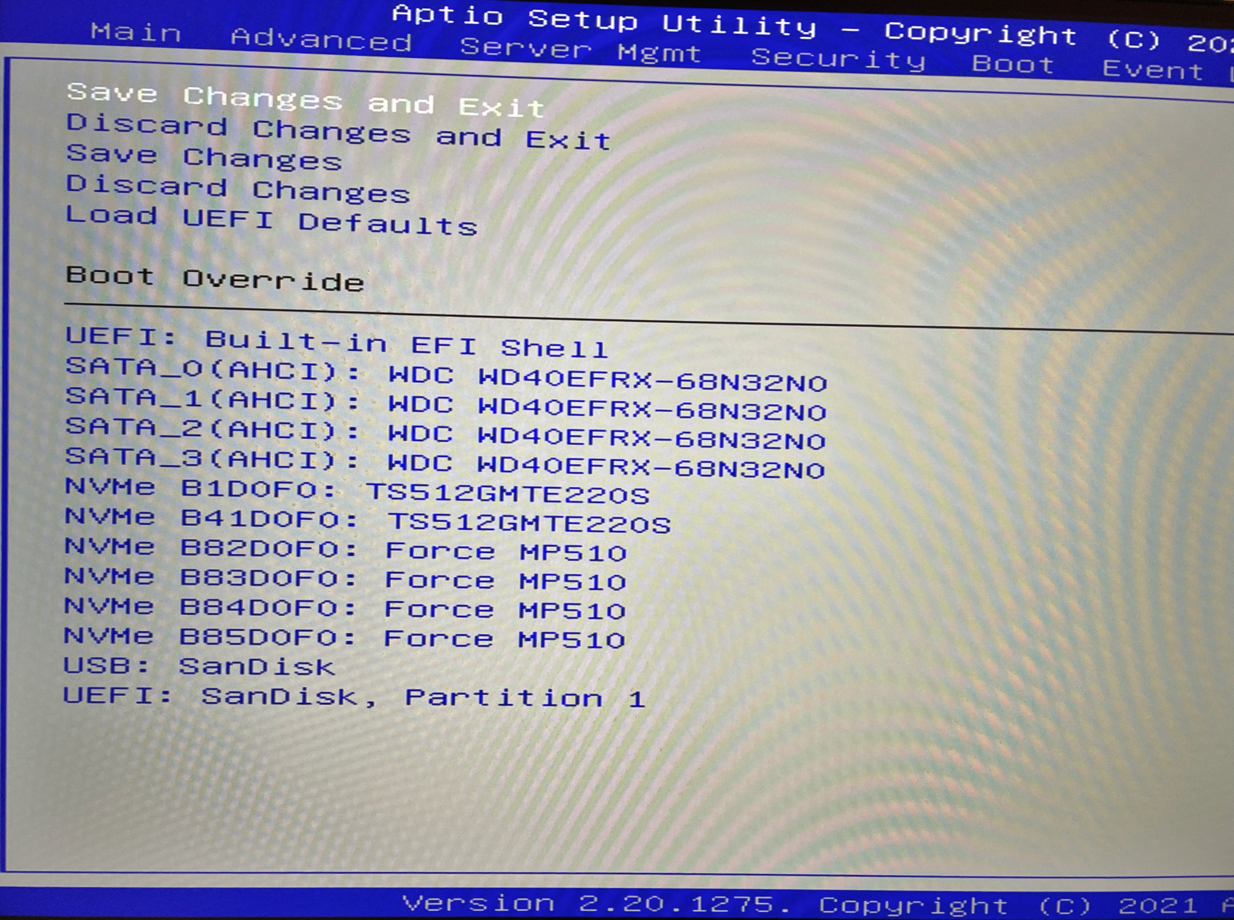

  • Replace the two Transcend SSDs with Phison based PCIe 4 SSDs to enable stable passthrough of the SSDs to macOS and a bare metal installation of macOS. Right now I am using a vdisk for the OS on the Raid 0+1 cache disk. Works fine, no glitches however I prefer bare metal installation.
  • Apparently macOS does not boot (install yes) from the Transcend SSDs.

What mechanisms are in place to alert and react to cooling loop leaks and / or pump failure? Is the rig running unattended for any amount of time?
I have remote messaging through Pushover installed, however want to tweak the alerting and auto-shutdown in the coming weeks. I can shut down the host remotely though. Also have the idea to install a water sensor / sensors in the case and connect that to the alerting. The pump is running at 2600RPM / 9V afaik, something I also want to tinker with and see how the whole monitoring can be improved.
I installed the watercooling primarily to learn and get much better temps (The 3900 had +60°C constantly) and to clean up the case. And I like water cooling :)
Re unattended - mostly, in the sense that I don’t want to look at it constantly since it sits at 2,5m above ground, however the closet is being accessed daily.
Edited by doesntaffect
Have you run tests on how long it takes the CPU to heat up with no coolant? When running unattended I'd be afraid of not getting it shut down quick enough to avoid frying something. That's the major advantage of air cooling, typically when a fan fails you still have a big ole chunk of metal to absorb the heat so the CPU doesn't skyrocket temps.
It's a nice setup, the only thing I don't like is the radiator.
I had 2 of them in my 2 servers to cool the xeons since at that time I was using windows for heavy computational calculations (24 h/day for some months) with tdp of 150W for each cpu, and each server had 2 of them.
One of the radiators started to leak some drops...directly on the gpu...luckily I saved it and it's still running from some years without issues.
After this I trashed the radiator and replaced with air cooling, and I will never use any kind of liquid inside the cases.
Be careful on leaking, if it starts to leak damages can be serious.
Edited by ghost82
I share your point @JonathanM, still I wanted to set up a water cooled system to see how it goes over time. I think I am going to go for a custom solution at some point, where monitoring is easier due to availability of addons like sensors. @ghost82 At this point I picked an all-in-one solution because it is basically sealed, sold million times and its the 2nd gen of the silent loop product. First one had a few issues, and with version 2 a lot seems to have improved. I am surprised that we still have to deal with leaking radiators nowadays.
Does the cold plate of the waterblock covers the IHS properly ?
It seems the IHS is way larger than a regular CPU and I wonder how well are cooled the outside area of the CPU.
According to temps of the CPU and the different sensors from within the CPU I’d say cooling is more than sufficient, however I also had that impression. The waterblock seems to be slightly smaller than the IHS, still the block is certified for the TRX4 socket, which is the same as the SP3 socket of the Epyc CPUs.

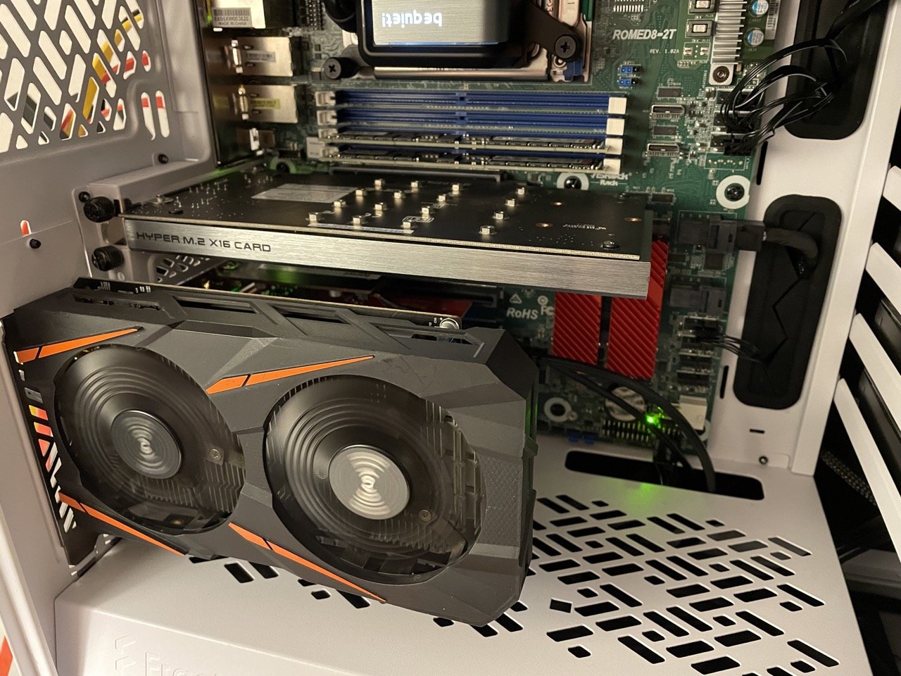

Updated pictures and light config changes:

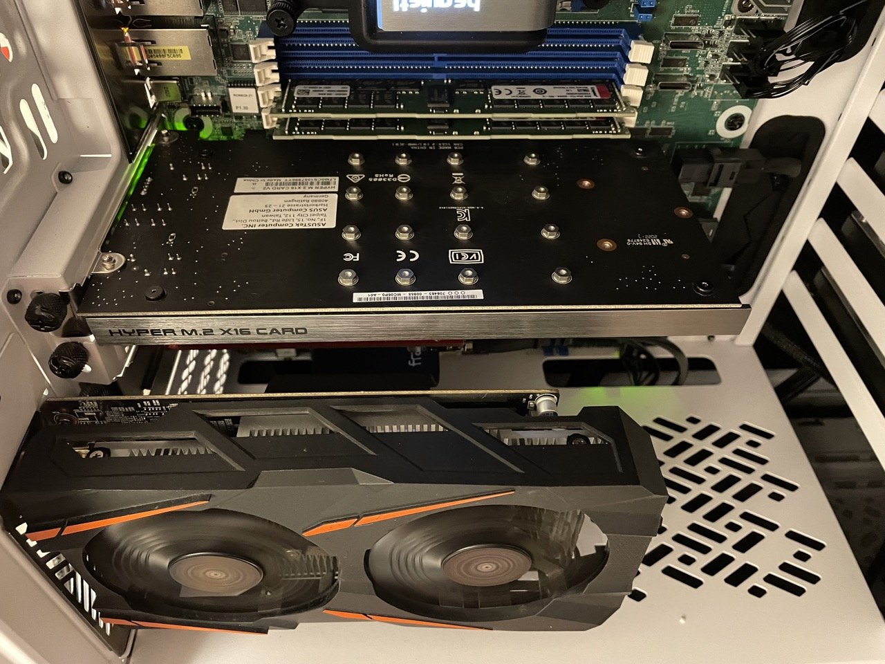

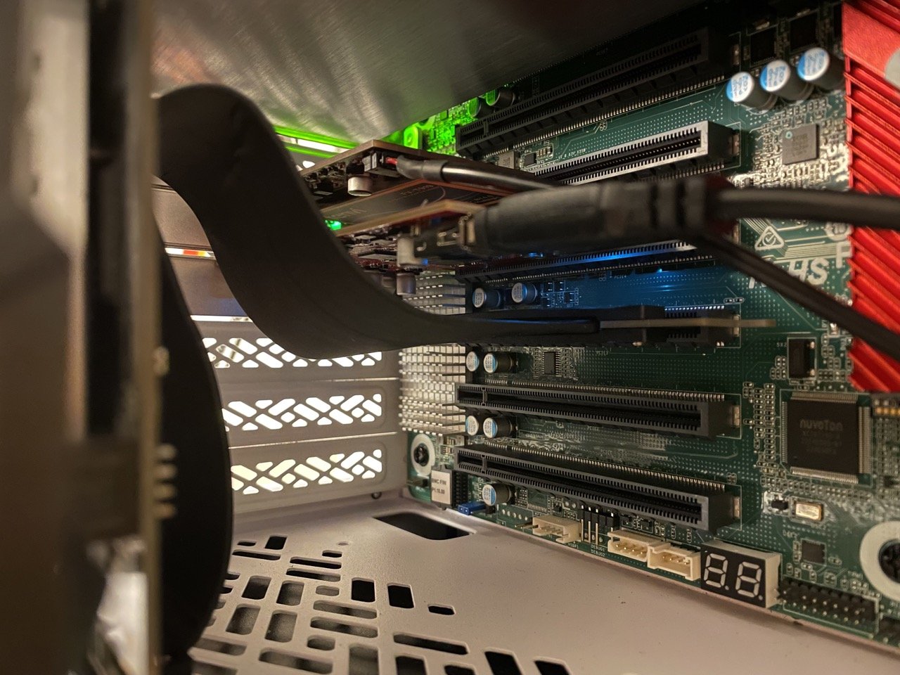

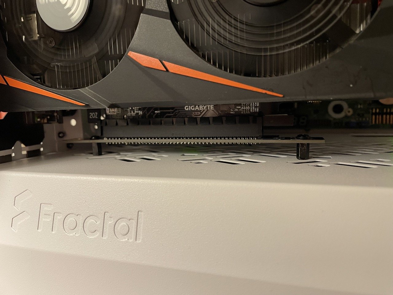

Had to move the GPU to a riser card since, even if it emits relatively little heat, it caused the two SSDs in the onboard slots (MacOS & Backup cache) to heat up to 51° Celsius.
I used the Fractal design riser cable. Quality of the cable is ok, however I had to remove the little slider which locks the card since I couldn't slide the card into the slot. That could be designed in a better way. The cable is relatively stiff.
Temps for both SSDs dropped to 38 - 43, depending on ambient and load.

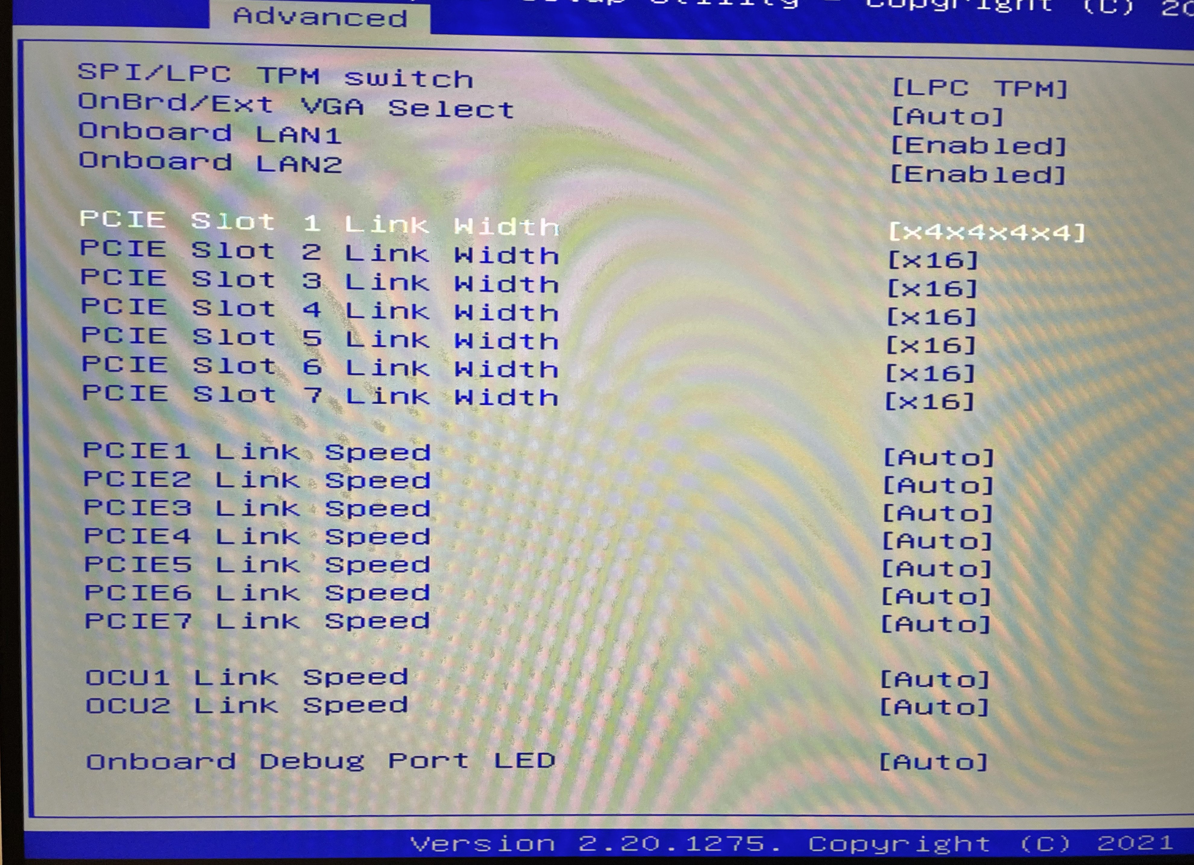

I messed with the PCIe cards in different slots and apparently the current config seems to be the only one which works for my VM set up (GPU in PCIe 5). I could also add a second GPU in another slot, but I think PCIe 1 also didnt work for me. I am using the Riser card for thermal reasons.
@raptwa did you open a support ticket with ASrock yet? To check if they have any limitations in their BIOS regarding PCIe 1.
Yep, I just got an answer from them.
Q:
I am running a Windows 10 VM with GPU passthrough (KVM + VFIO). It is working fine, when the GPU is in PCIE slot 2 or 3. However it is not working, when the GPU is in PCIE slot 1. Is this a known issue?
A (ASRock Support):
Normally it should work. Maybe you can check the slot settings in the bios.

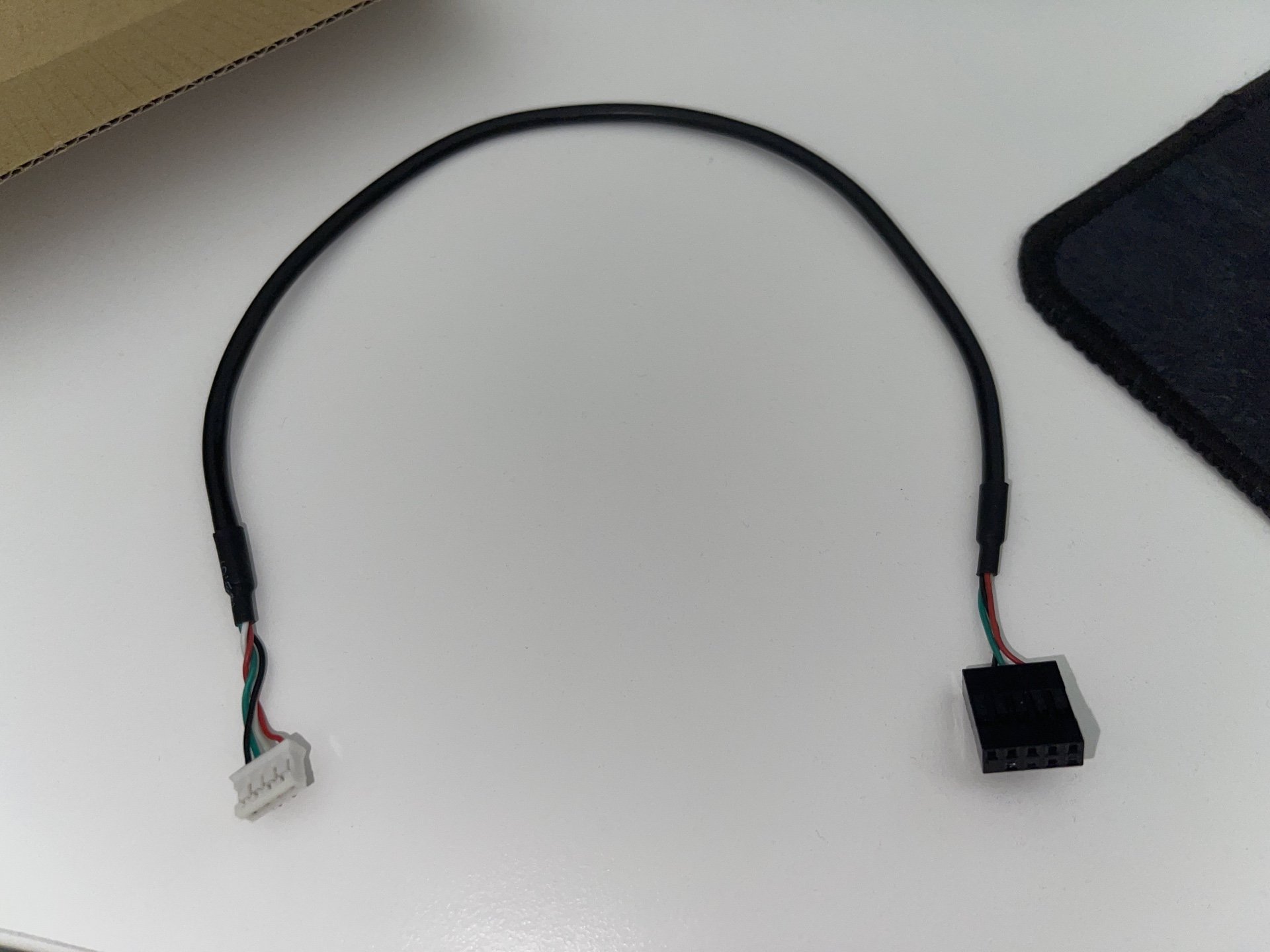

Hey,
what cable are you using for the connection? It does not look like the original one which is being delivered and I can't find it on the internet.
The original has 4-pin to 9pin USB header. Yours is 4-pin to USB Type A.
