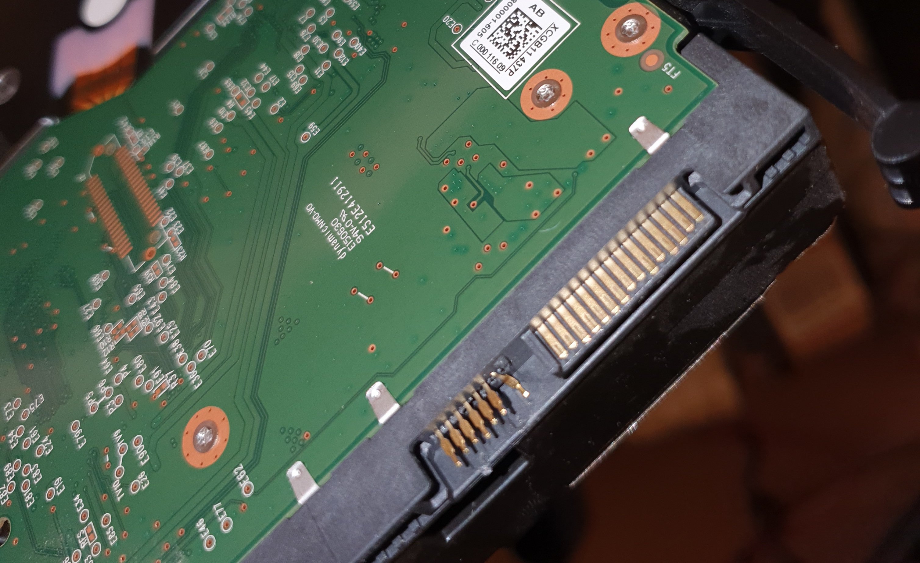

I'm really not sure what to do here or how much I have lost but basically a data drive was acting up so I have come to replace it, but now i've noticed that the Parity drive sata port pins have been damaged (due to the clip on sata cables) and one of the sata pins is bent.
That means I have lost a data drive and the parity disk at the same time.

10 minutes ago, coldjim said:
bent pin on the sata connector of the parity drive
I'm having some trouble visualizing this since the "pins" are not separate, can you post a photo?

I have attached an image of the bent pin. The plastic case came off and exposed the pins, and one of them has bent back. Its due to having clip on sata cables and I must of mistakenly pulled it at some point then tried to put it back on without knowing the pins were exposed.
I think i've really screwed up now....

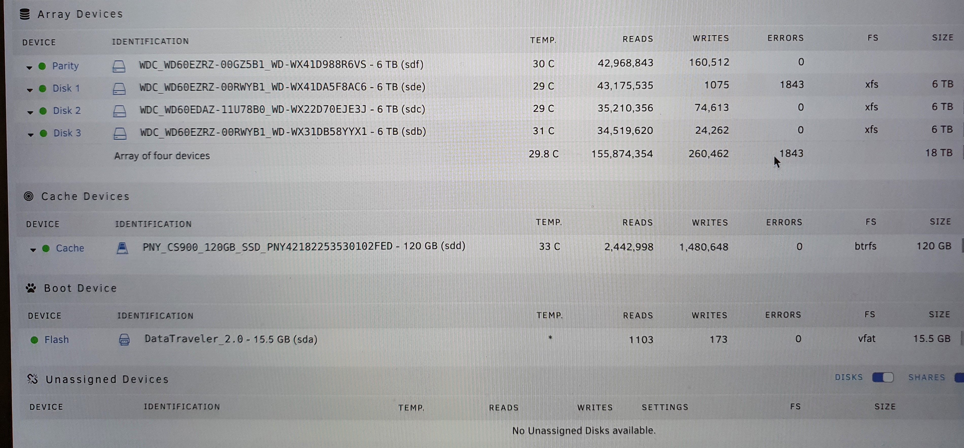

I have also attached how many unraid server looked BEFORE anything happened.
I have since tried to add a new drive as a data drive (to the one that failed) which is Disk1 (AC6). But this was before i realised the parity had the bent back pin.
