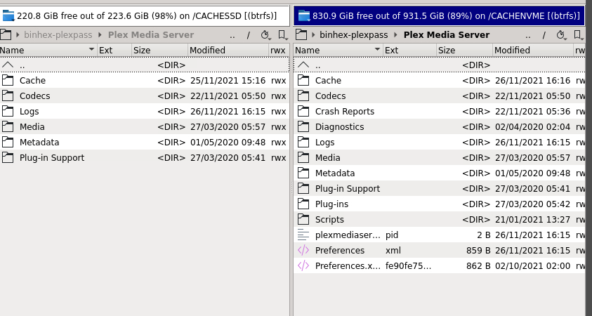

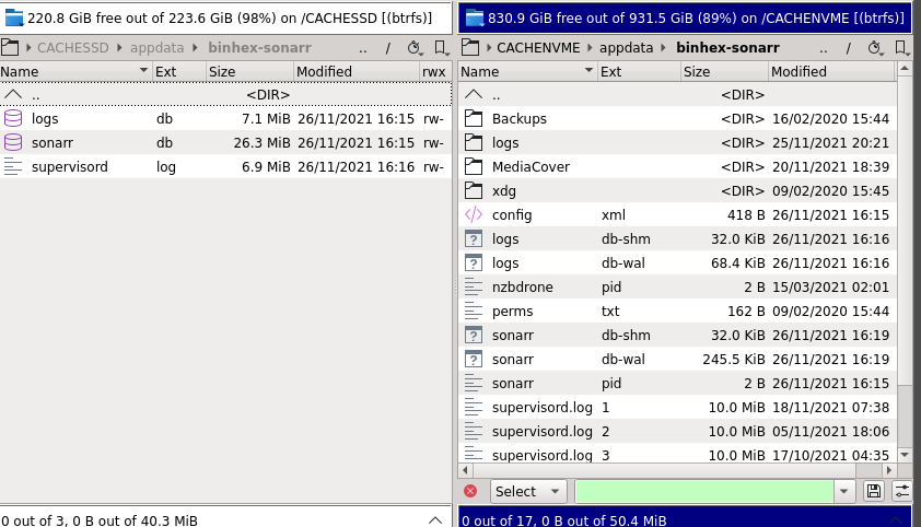

My issue is that I am seeing a split of appdata for all of my dockers. There is a small(in size) amount
of appdata remaining in the old appdata location on cache_ssd(734MB).  Appdata on cache_nvme is 43GB.
See my Screenshot below of Sonarr and Plex AppData. Why do I have split content and what can I do about it?  image.png.303423cecbd8c1ea2364b7e6352e7ea6.png
