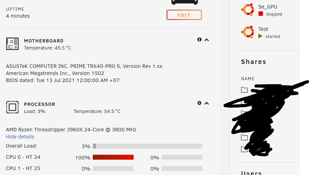

GPU2 passing to VM2 (not boot and 1 core always 100% utilize)

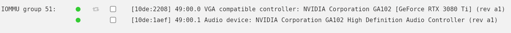

Here is my passing parameter, IOMMU group of second device and 1 core 1 core always 100% utilize
my GPU1 use exactly the same passing parameter, except bus

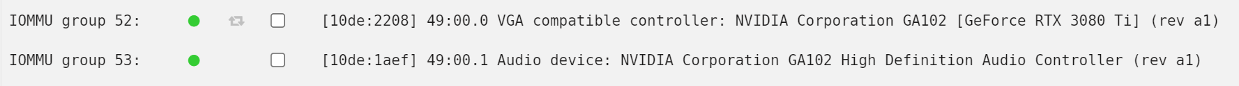

I don't know I understand it correctly or not, I have tried isolating the GPU as shown below, now 3080Ti IOMMU is now separated.
I am also added a vbios, but it still doesn't worked
