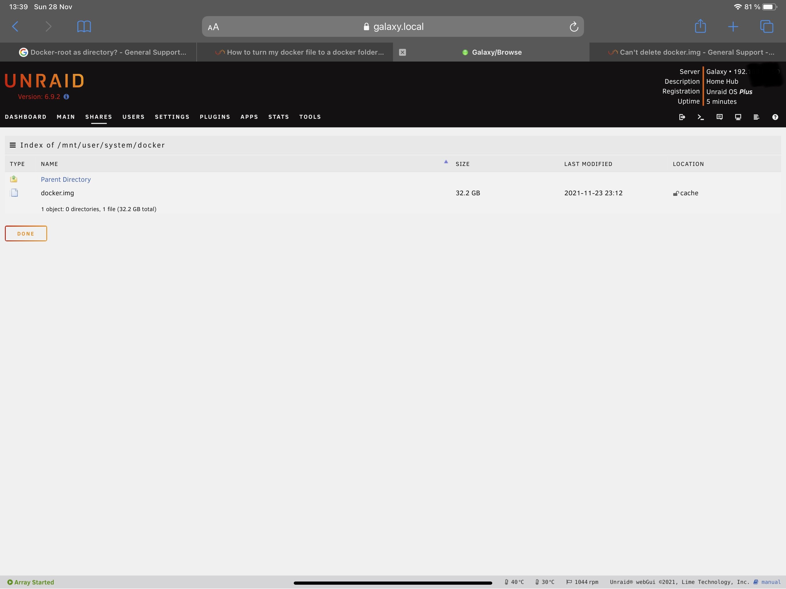

My docker is corrupted. Can't delete it using the system. Can't delete it using krusader. Can't delete it using telnet.
Any ideas? Files attached.

I try to delete it every few hours. And I have disabled Docker in Settings.
image file from days ago is still there.
