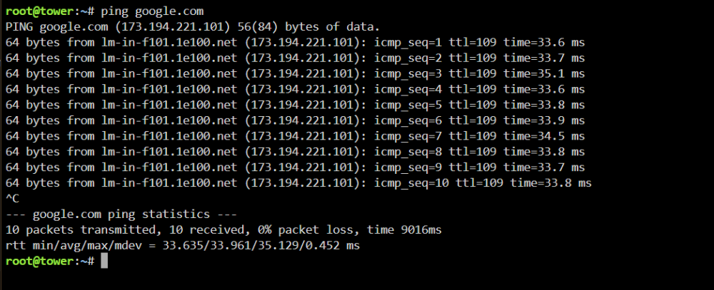

I am having the same issue can’t resolve DNS servers but can ping gateway help appreciated
HPMicro-Diagnostics.pdf
Try not using the Gateway as DNS server 1.  Use the Google ones or Open DNS as #1 and 2 and gateway as #3

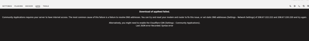

However, the box still won't update apps, dockers, plugins or OS versions. JSON syntax error on the community apps page.
I downgraded from 6.12.3 to 6.12.2 and since it won't connect, three of my plugins failed (dvb, nvidia, qnap), so of my docker containers won't run.
I've searched for the syntax error and that usually is resolved when GitHub is working, but GitHub isn't/wasn't down.
Edited by nothus
fixed my issue
Enabling CA's debugging (Settings - Community Applications) and then going to Apps, waiting for the error and finally hitting "Debugging" and uploading the file might shed some light.  I would however also try running your browser in incognito mode / no extensions whatsoever and see if that makes a difference.  (There are some extensions that hijack communications which CA / Unraid (and many other websites) do not play nice with.
