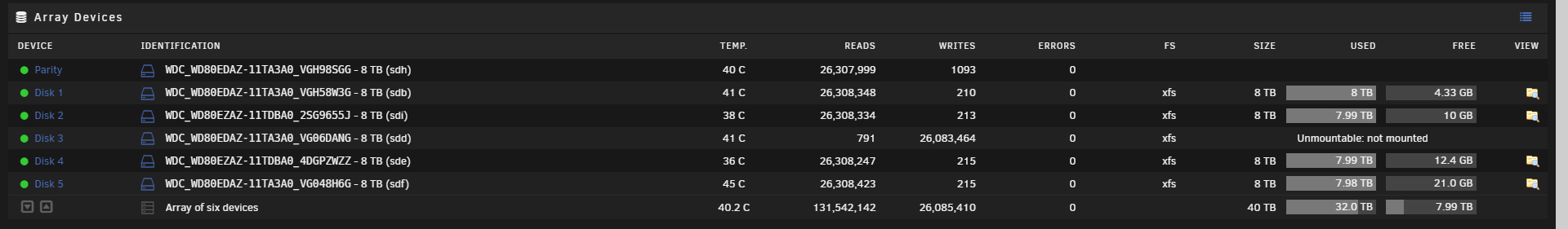

Post a screenshot of Main - Array Devices.
2 minutes ago, trurl said:
Disk3 seems to be disabled and unassigned
Did you unassign disk3 yourself?

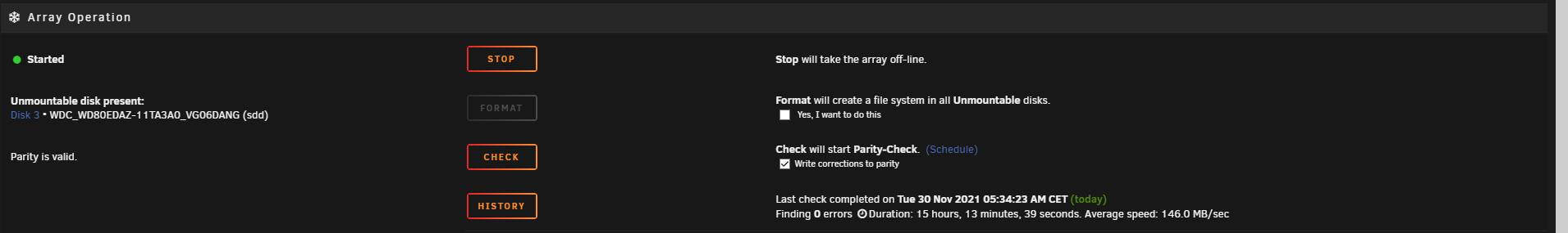

OK, after looking more closely at your syslog, it seems you had already started to rebuild disk3.
It looks like emulated disk3 was mounting though.
Start the array with disk3 unassigned and post new diagnostics.

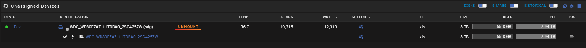

- I plugged old Disk 3, with new Disk 3 still connected and mounted old Disk 3 with "Unassigned Devices" plugin
- When old Disk 3 is mounted it shows that it has zero data on it BUT when old Disk 3 is mounted, new Disk 3 shows up "Unmountable: not mounted". When I unplugged old Disk 3 and rebooted, new Disk 3 is mounted again but with zero data
I'm confused, beacuse old Disk 3 should still have remaining data.
Should I start array with old or new Disk 3 unassigned?

1 hour ago, paululibro said:
new Disk 3 is mounted but with zero data on it
 Are you sure you didn't format?
No disk assigned as disk3.

Here are diagnostics with old Disk 3 (the one that should have data but shows empty) plugged in but unassigned and new Disk 3 not connected at all.

Also when I click on "File System Check" next to unassigned old Disk 3:
I'm getting these logs:
Spoiler
FS: xfs
Executing file system check: /sbin/xfs_repair -n /dev/sdg1 2>&1
Phase 1 - find and verify superblock...
Phase 2 - using internal log
- zero log...
- scan filesystem freespace and inode maps...
Metadata CRC error detected at 0x43cfad, xfs_bnobt block 0x37fffffd0/0x1000
btree block 7/1 is suspect, error -74
bad magic # 0xa202020 in btbno block 7/1
Metadata corruption detected at 0x43cc88, xfs_cntbt block 0x37fffffd8/0x1000
btree block 7/2 is suspect, error -117
bad magic # 0x49414233 in btcnt block 7/2
agf_freeblks 74458438, counted 0 in ag 7
agf_longest 74458438, counted 0 in ag 7
Metadata CRC error detected at 0x46b78d, xfs_inobt block 0x37fffffe0/0x1000
btree block 7/3 is suspect, error -74
bad magic # 0x58444233 in inobt block 7/3
Metadata corruption detected at 0x4536d0, xfs_bnobt block 0x80000000/0x1000
btree block 1/1 is suspect, error -117
Metadata CRC error detected at 0x43cfad, xfs_bnobt block 0xfffffff8/0x1000
btree block 2/1 is suspect, error -74
bad magic # 0x64383a61 in btbno block 2/1
Metadata CRC error detected at 0x43cfad, xfs_bnobt block 0x27fffffe0/0x1000Metadata corruption detected at 0x4536d0, xfs_bnobt block 0x1ffffffe8/0x1000
btree block 4/1 is suspect, error -117
btree block 5/1 is suspect, error -74
bad magic # 0x205f5f5f in btbno block 5/1
Metadata CRC error detected at 0x43cfad, xfs_bnobt block 0x2ffffffd8/0x1000
btree block 6/1 is suspect, error -74
bad magic # 0xa202020 in btbno block 6/1
Metadata CRC error detected at 0x43cfad, xfs_bnobt block 0x17ffffff0/0x1000
btree block 3/1 is suspect, error -74
bad magic # 0x51380c72 in btbno block 3/1
Metadata corruption detected at 0x4536d0, xfs_cntbt block 0x80000008/0x1000
btree block 1/2 is suspect, error -117
Metadata CRC error detected at 0x43cfad, xfs_cntbt block 0x100000000/0x1000
btree block 2/2 is suspect, error -74
bad magic # 0xe12ea68c in btcnt block 2/2
Metadata corruption detected at 0x4536d0, xfs_cntbt block 0x1fffffff0/0x1000
btree block 4/2 is suspect, error -117
Metadata corruption detected at 0x4536d0, xfs_cntbt block 0x27fffffe8/0x1000
btree block 5/2 is suspect, error -117
Metadata CRC error detected at 0x43cfad, xfs_cntbt block 0x2ffffffe0/0x1000
btree block 6/2 is suspect, error -74
bad magic # 0x54686973 in btcnt block 6/2
Metadata CRC error detected at 0x43cfad, xfs_cntbt block 0x17ffffff8/0x1000
btree block 3/2 is suspect, error -74
bad magic # 0x17b63fbe in btcnt block 3/2
agf_freeblks 268435445, counted 750 in ag 1
agf_freeblks 268435445, counted 0 in ag 2
agf_longest 268435445, counted 0 in ag 2
agf_longest 268435445, counted 5 in ag 1
agf_freeblks 268435445, counted 567 in ag 5
agf_longest 268435445, counted 4 in ag 5
agf_freeblks 267913717, counted 1320 in ag 4
agf_longest 267913717, counted 9 in ag 4
agf_freeblks 268435445, counted 0 in ag 6
agf_longest 268435445, counted 0 in ag 6
agf_freeblks 268435445, counted 0 in ag 3
agf_longest 268435445, counted 0 in ag 3
Metadata corruption detected at 0x4536d0, xfs_inobt block 0x80000010/0x1000
btree block 1/3 is suspect, error -117
Metadata CRC error detected at 0x46b78d, xfs_inobt block 0x100000008/0x1000
Metadata corruption detected at 0x4536d0, xfs_inobt block 0x1fffffff8/0x1000btree block 2/3 is suspect, error -74
bad magic # 0x5829dbd5 in inobt block 2/3
btree block 4/3 is suspect, error -117
Metadata corruption detected at 0x4536d0, xfs_inobt block 0x27ffffff0/0x1000
btree block 5/3 is suspect, error -117
Metadata CRC error detected at 0x46b78d, xfs_inobt block 0x180000000/0x1000
btree block 3/3 is suspect, error -74
bad magic # 0xd3a6ff15 in inobt block 3/3
Metadata CRC error detected at 0x46b78d, xfs_inobt block 0x2ffffffe8/0x1000
btree block 6/3 is suspect, error -74
bad magic # 0x546f7272 in inobt block 6/3
agi_count 0, counted 1728 in ag 1
agi_freecount 0, counted 191 in ag 1
agi_count 0, counted 2016 in ag 4
agi_freecount 0, counted 134 in ag 4
agi_count 0, counted 2336 in ag 5
agi_freecount 0, counted 102 in ag 5
sb_icount 64, counted 6144
sb_ifree 61, counted 488
sb_fdblocks 1952984849, counted 268438106
- found root inode chunk
Phase 3 - for each AG...
- scan (but don't clear) agi unlinked lists...
found inodes not in the inode allocation tree
- process known inodes and perform inode discovery...
- agno = 0
- agno = 1
- agno = 2
- agno = 3
- agno = 4
- agno = 5
- agno = 6
- agno = 7
- process newly discovered inodes...
Phase 4 - check for duplicate blocks...
- setting up duplicate extent list...
free space (1,2952230-2952262) only seen by one free space btree
free space (1,2952264-2952332) only seen by one free space btree
free space (1,2952334-2952418) only seen by one free space btree
[[[ IT GOES FOR THE NEXT ~1400 lines but with different values ]]]
- check for inodes claiming duplicate blocks...
- agno = 1
- agno = 2
- agno = 3
- agno = 4
- agno = 5
- agno = 6
- agno = 7
- agno = 0
No modify flag set, skipping phase 5
Inode allocation btrees are too corrupted, skipping phases 6 and 7
Maximum metadata LSN (1610016023:-369629521) is ahead of log (1:58).
Would format log to cycle 1610016026.
No modify flag set, skipping filesystem flush and exiting.

But the original drive still shows up empty:
Also when old disk is mounted, new disk is unmountable:
And now, there is also a "Format" button next to the old drive. If it's the one we talked about earlier then I'm 100% sure I didn't format:
Started array in the maintenance mode and checked both drives:
