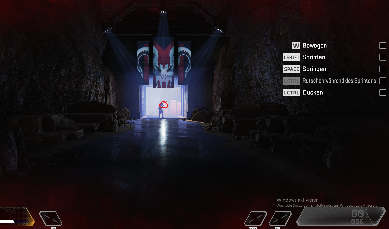

Apex:
When I start the training the mouse is fix to a dot in the center (screenshot is not centered)
When I move the mouse I look to the ground or some where and can not use it properly.

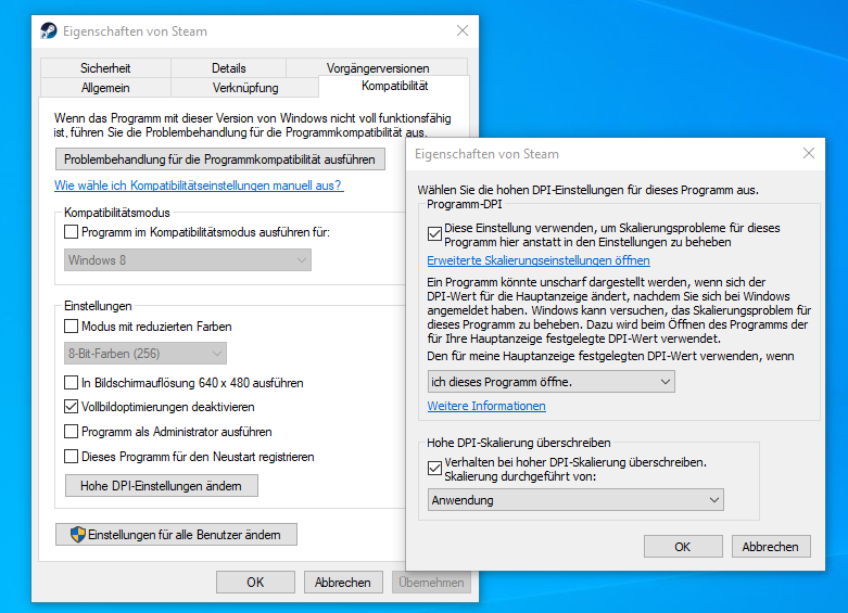

If read something about overlay and high resolution problem of the mouse. (Logitech G604 btw)
I tried with right click on steam.exe and adjusting "compatibility Mode" with no success.
(sorry for german interface)

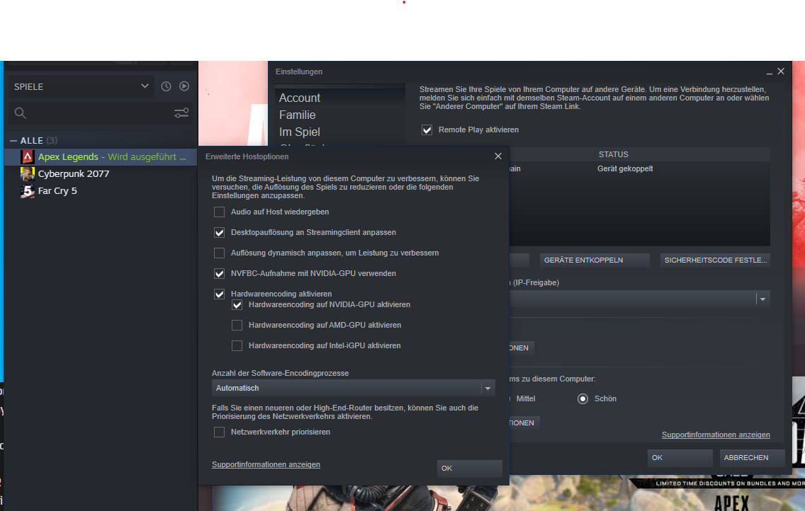

Here my Steam settings:
Any ideas how to solve it?
