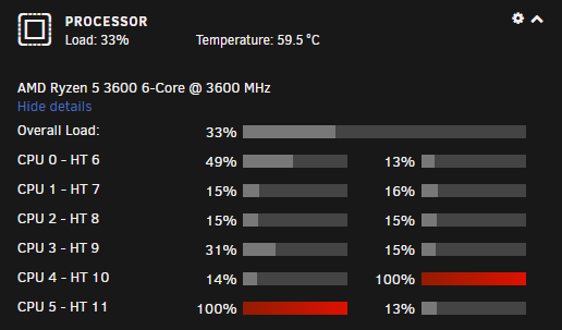

I also have two CPU cores stuck at 100%.
Caused by the following two USB-related processes:

In each scenario, both cores remained stuck at 100%. The only USB device connected is the UnRaid flash boot drive to a USB 1.0 port.
I'm at a loss here. Thankfully there's no noticeable performance issues, but I'd like to keep this CPU/mobo setup for the long-term.

Well, despite the lack of assistance from the forums, I found that monitoring the threads while plugging and unplugging a USB mouse and keyboard did the trick. The threads have returned to normal levels.
