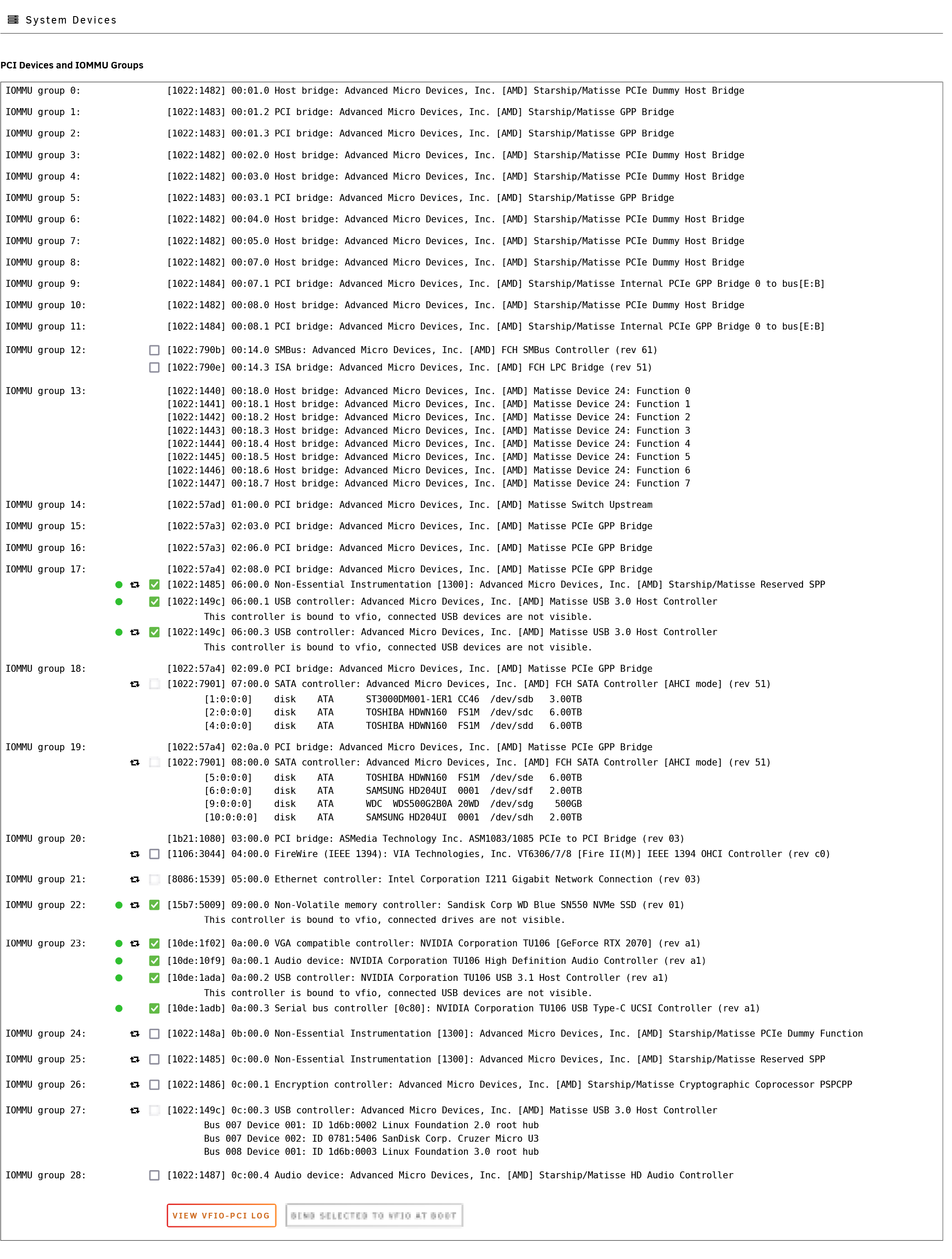

  1. I am unable to pass the card through to my Win 10 VM.

First, I opted for the vfio-pci.cfg, as the card is in its own IOMMU group (20, see attached picture) and this method already worked well for my GPU, NVME and onboard USB controller. Unfortunately, this method leads to unraid not being able to boot at all. It seems to get stuck at the vfio-pci.cfg read stage (I think), but the syslog doesn't show any errors or hints towards the exact problem. The consequence is that the PC gets restarted and the unraid thumb drive is not detected anymore. I have to plug it into my laptop and remove the vfio-pci.cfg to get unraid to boot again.
