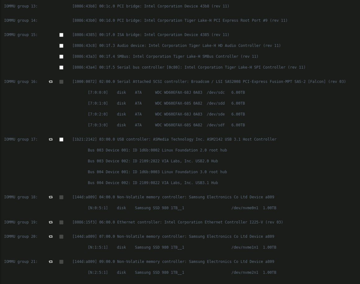

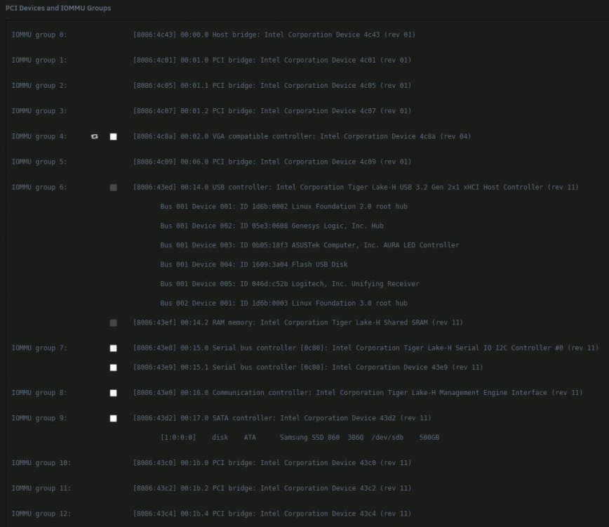

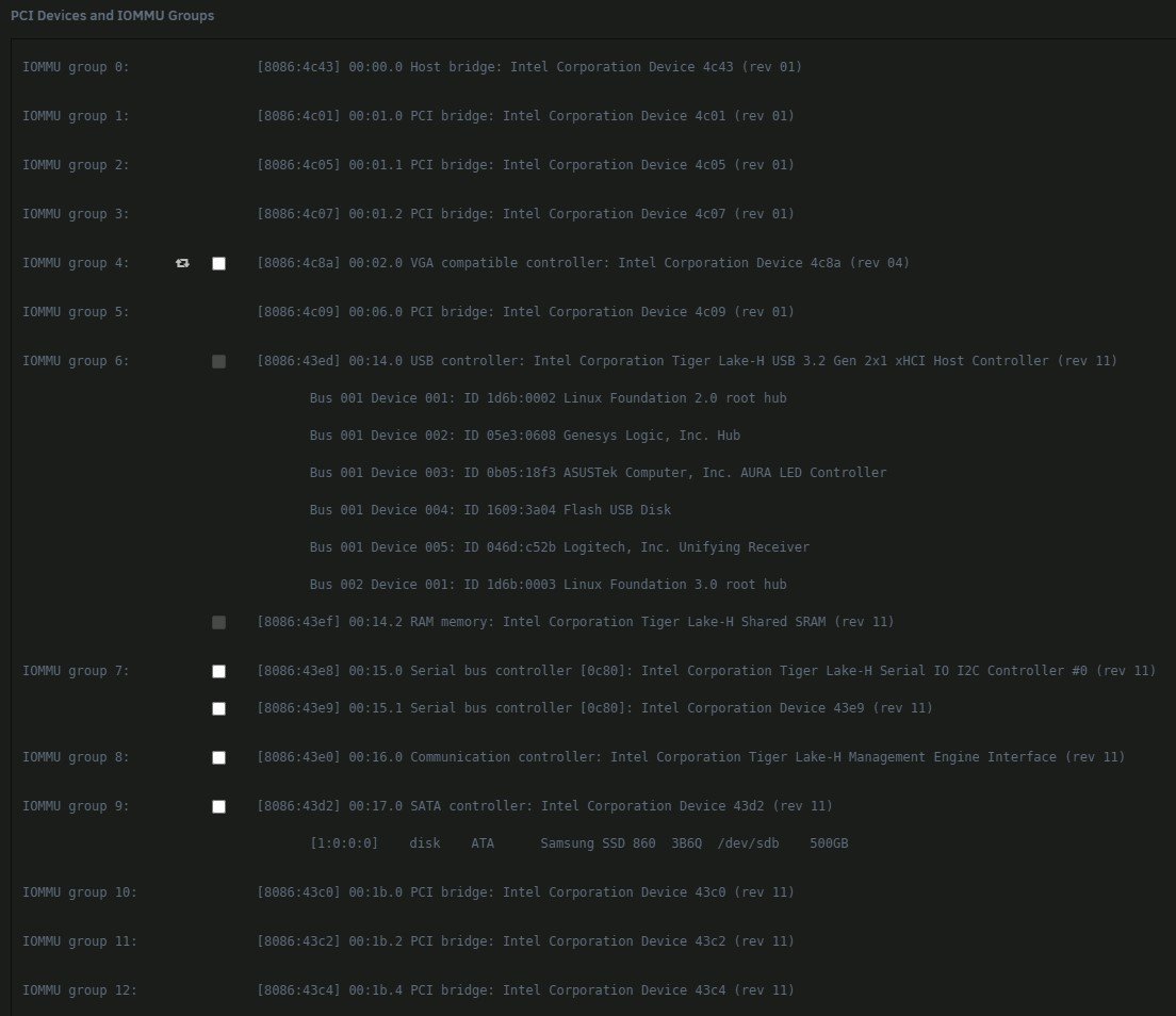

IOMMU Group 17 has the Asmedia controller. See the images attached for my list of IOMMU groups before and after adding it to VFIO.
Thanks!!!
