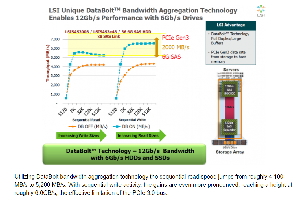

9 hours ago, JorgeB said:
It was true with SAS2 expanders and HBAs, and AFAIK there are no exceptions, with SAS3 there are, LSI for example uses Databolt to improve performance with slower linking SAS2/SATA3 devices:
PMC Sierra uses a similar feature, some numbers in the thread below:
https://forums.unraid.net/topic/41340-satasas-controllers-tested-real-world-max-throughput-during-parity-check/

12 hours ago, m-a-x said:
What happens if I have a mix of SATA2 HDD and SATA3 SSD capable of 6Gbps?
It will downgrade the performance of all connected devices, there are a couple of examples of that on the link I posted above.
