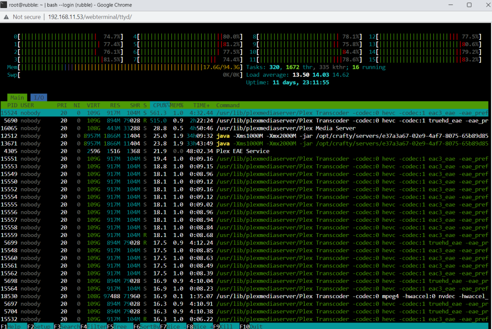

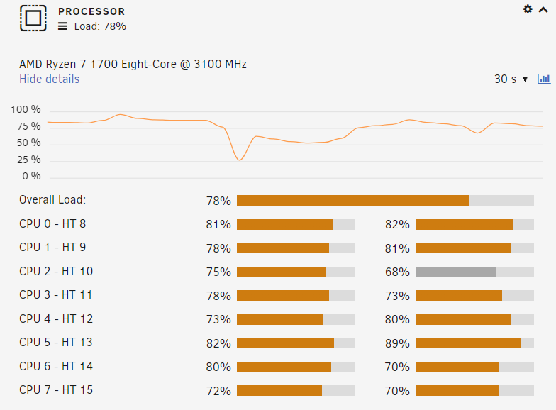

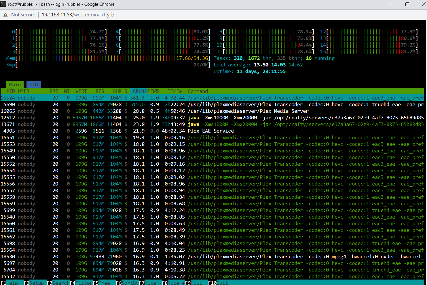

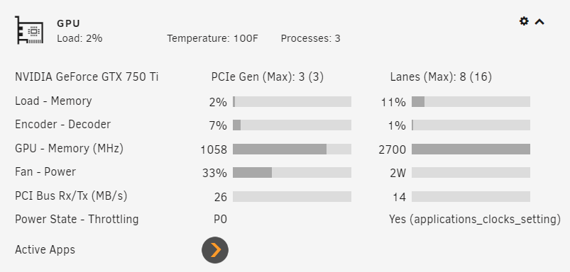

any luck on this? I'm having similar issues on mine. I haven't rejiggered the docker yet, that's next. I'm on the lscr.io/linuxserver/plex docker, and my nVidia driver stuff is under Settings > User Utilities > Nvidia Driver
Edited by dkerlee
