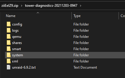

This is the file i am getting on the USB stick when i run diagnostics on the server as i have no web access due to the original problem, i can download and extract the file in the first post, i think windows messes up the extension of the file.
ziiEeIZ9.zip
