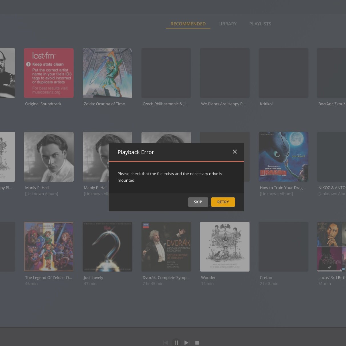

Plex no longer able to find Library directory.

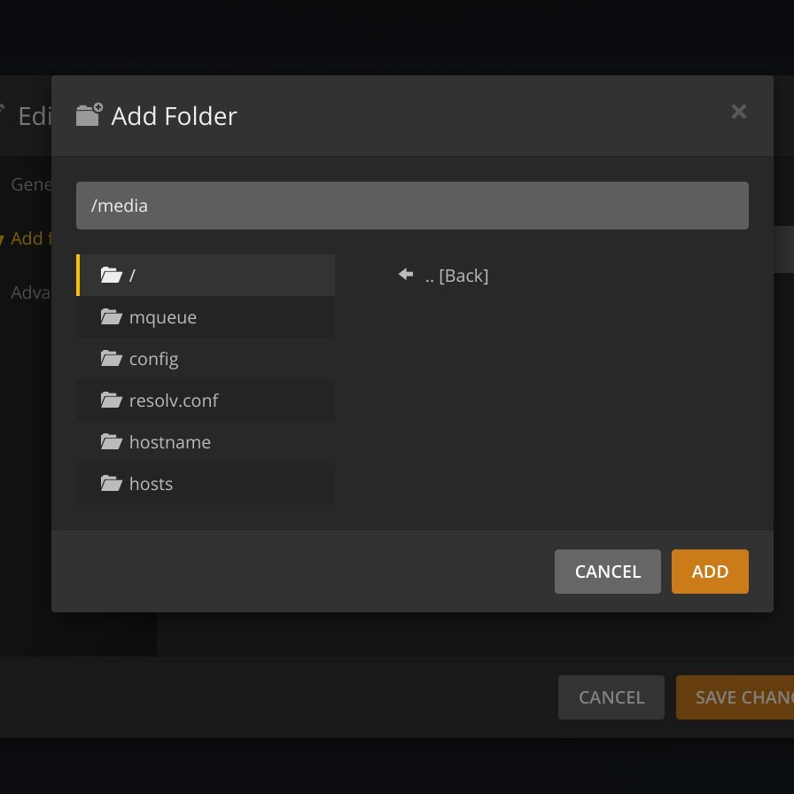

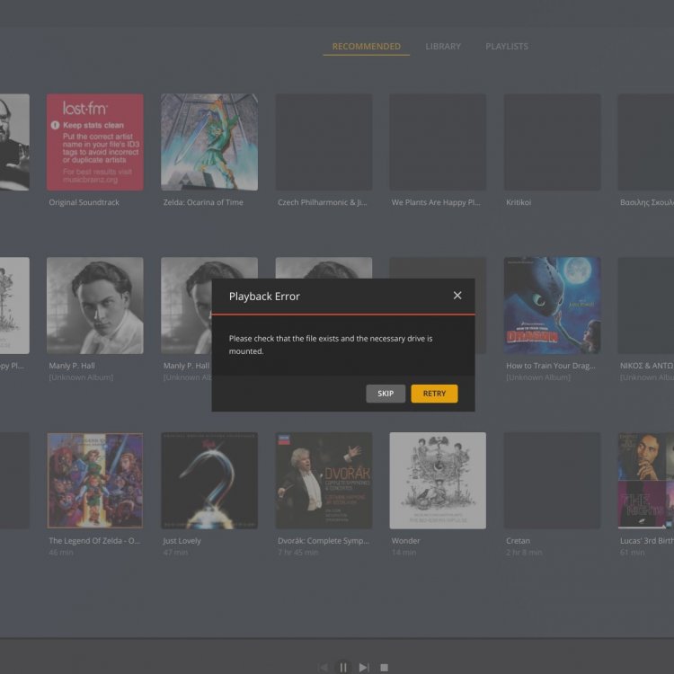

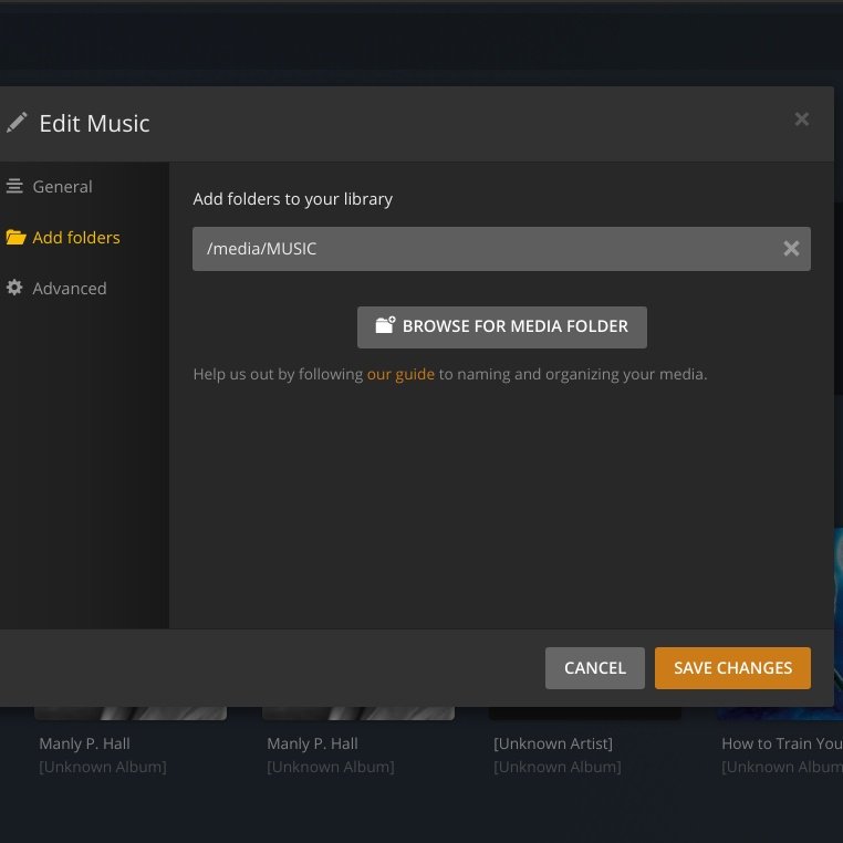

My Plex Server is no longer able to find my files on my Unraid array. My music folder for example, is located in "ROOT/media/MUSIC" however under media, the MUSIC folder long longer is visible.
I am not quite sure what to do.

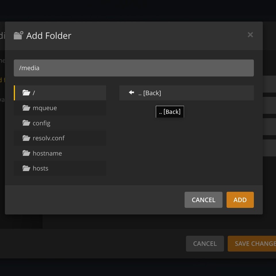

You only have a volume mapping for config (appdata), so the container can't see anything else on the host. It couldn't have been working like that before so what did you do to get to this state?
Do you understand docker mappings?

You must not have used the Previous Apps feature on the Apps page to reinstall it, or it would have reinstalled it exactly as it was.

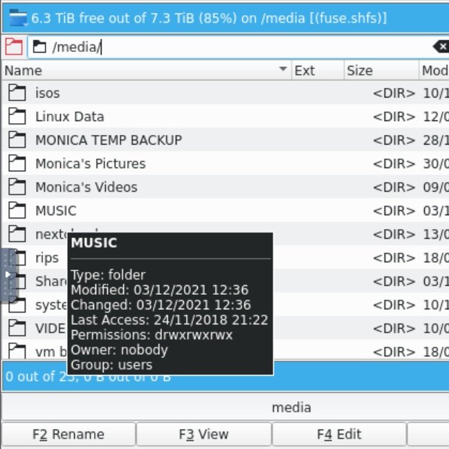

Guessing from your screenshots you probably had a mapping from /media to /mnt/user. You will have to add that mapping

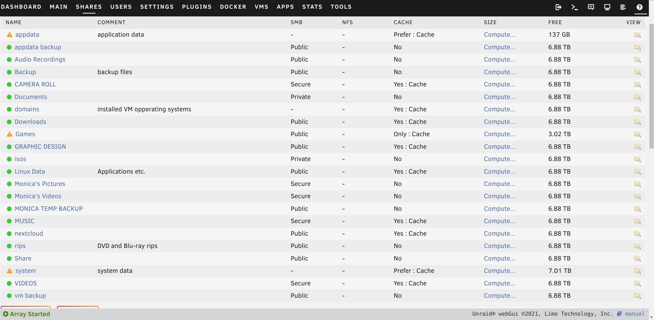

I'm sure most people do since dockers perform better with appdata on fast storage. Your system share should also be on SSD for the same reason. Plus, these shares always have open files and will keep your array disks spunup if they are on the array.

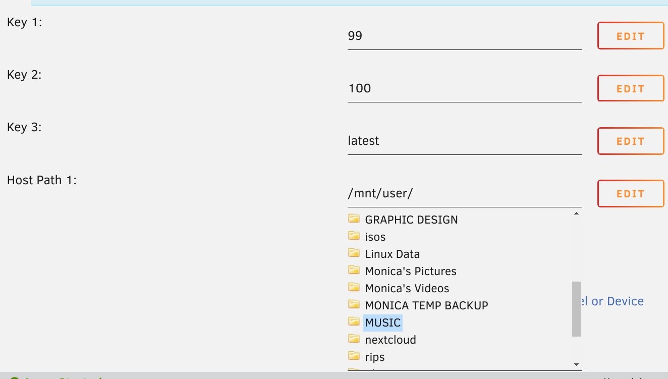

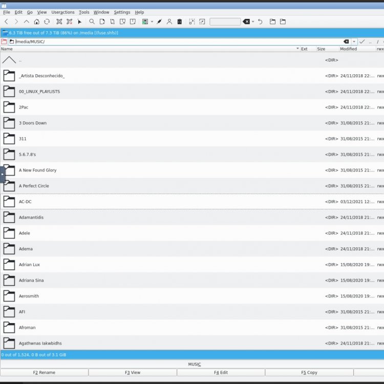

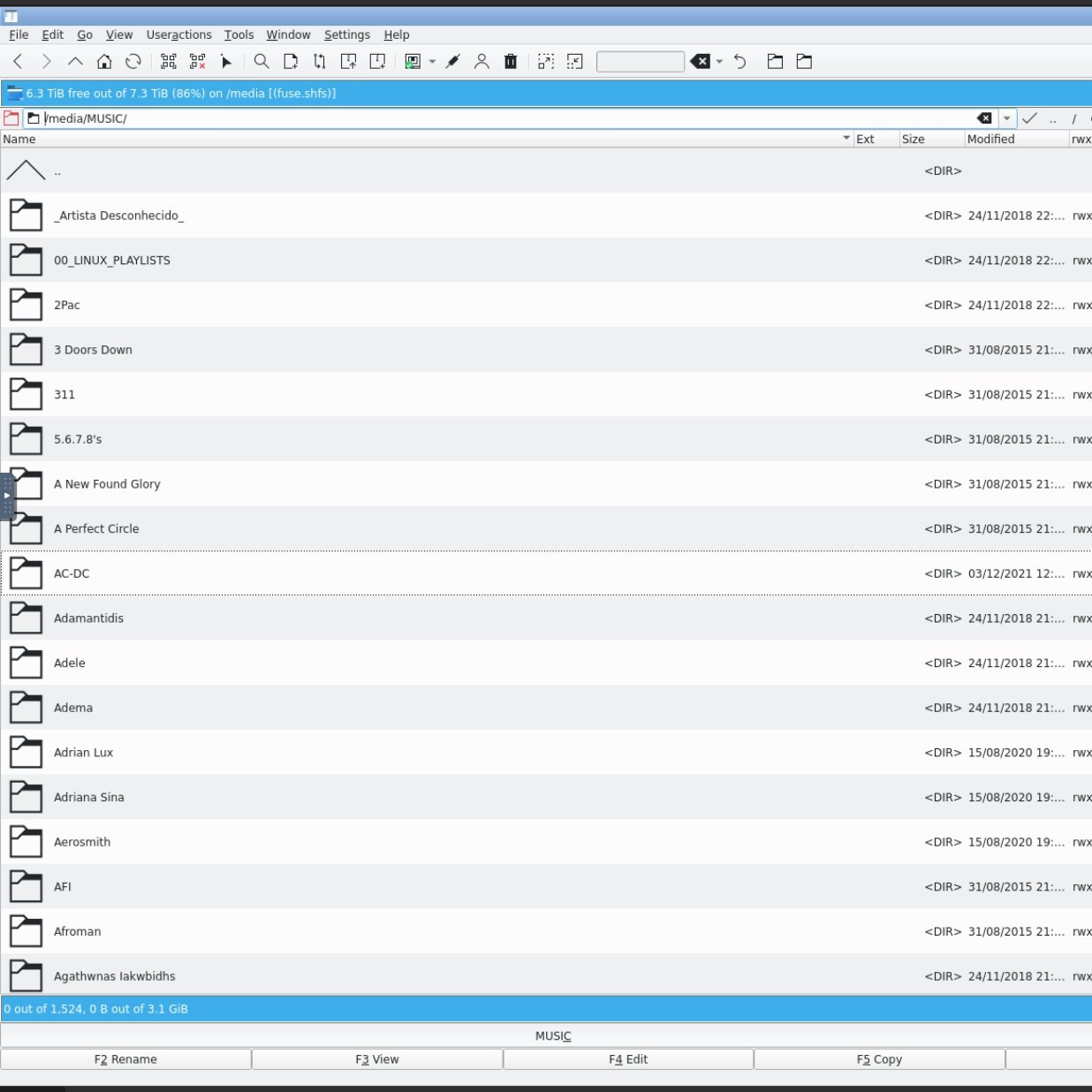

Thanks for sending. I watched this and still cannot solve my issue. I have all the appdata available from Plex but it still cannot locate media even when I mapped the container to the folder containing my media shares that I want Plex to recognize again. Take a look at my "MUSIC" share for example. Why can't Plex detect this? What am I missing? Thanks for the help.
Edited by bubbleman441
You're missing it.  You've got a /media mapped to /mnt/user within Krusader's template, so you can access the files within that app
You don't have any additional paths set within Plex, therefore it has no access to any files on the server at all.
Add another path (there's a link at the bottom when you edit the template) and create a new mapping with host dir of /mnt/user and container dir of /media
Then you'll be able to access your files within /media when inside plex.
Think of mappings as a "shortcut".  Those shortcuts only exist if there's an explicit mapping done on the template and within the app whenever you see /media it gets translated to /mnt/user/...

That was actually the template settings for Plex not Krusader. I solved it thanks for your time and help!
