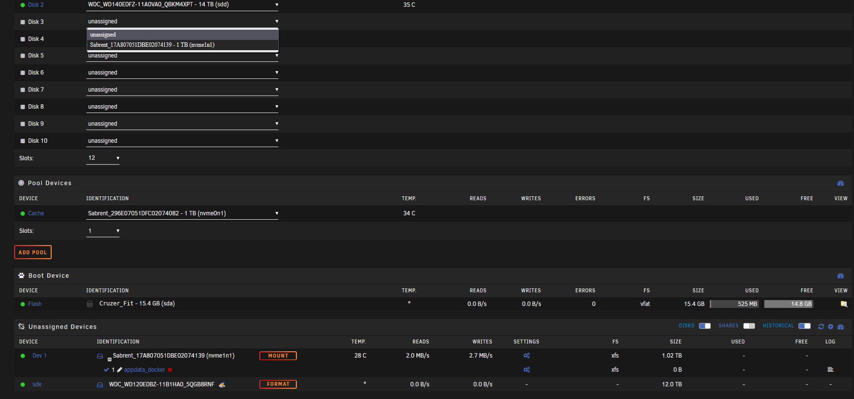

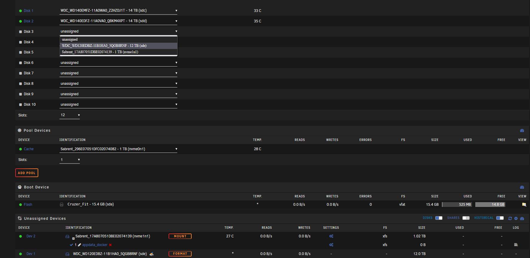

i'm trying to add a 12Tb disk to an array constitued with 1 parity of 14Tb and 2 HDD of 14Tb.
So i stop the array, select the disk but then it dissapears from the list without adding it.
I noticed that the device name changed from dev 1 to sde (which is the next name of my array sdb,sdc,sdd)
Thanks,
Kishin.
