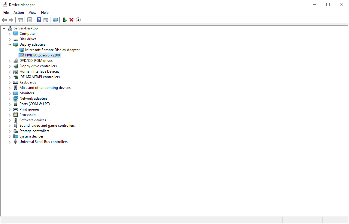

Same result.
Device manager says:

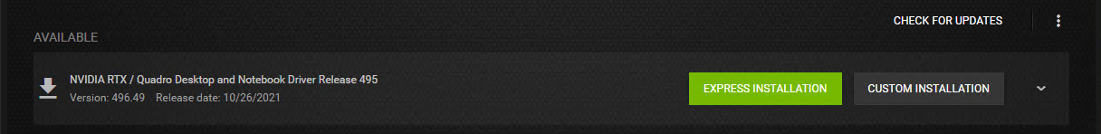

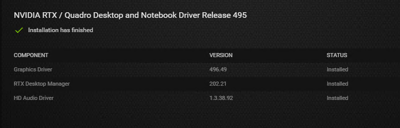

When I tried from Nvidia Geforce Experience I can install it again right after, so there's never an installed driver. I always do a clean install.
It's version 496.49 here.

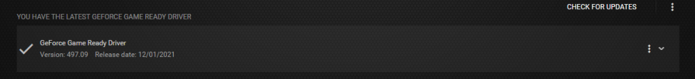

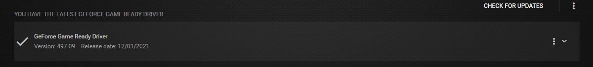

And right after:
If I check on my desktop (not the VM):
For some reason, it can see the GPU, but it can't use it, and I don't get why.

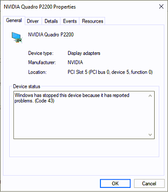

It could be error 43 because nvidia detects a virtual machine.
It is true that nvidia now allows passthrough of its gpus, from march 2021?, but this should only be with its consumer cards.
From Nvidia:
The feature is enabled on all GeForce/TITAN GPUs supported in the R465 driver (Kepler and later for Desktop; Maxwell and later for Notebook) for Windows 10.
It could be that quadro cards are not "consumer gpus", so you need to apply all the fixes to hide the hypervisor from nvidia.

You were right about the code 43:

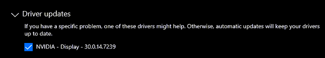

Found this one in the updates:
Didn't work either.
