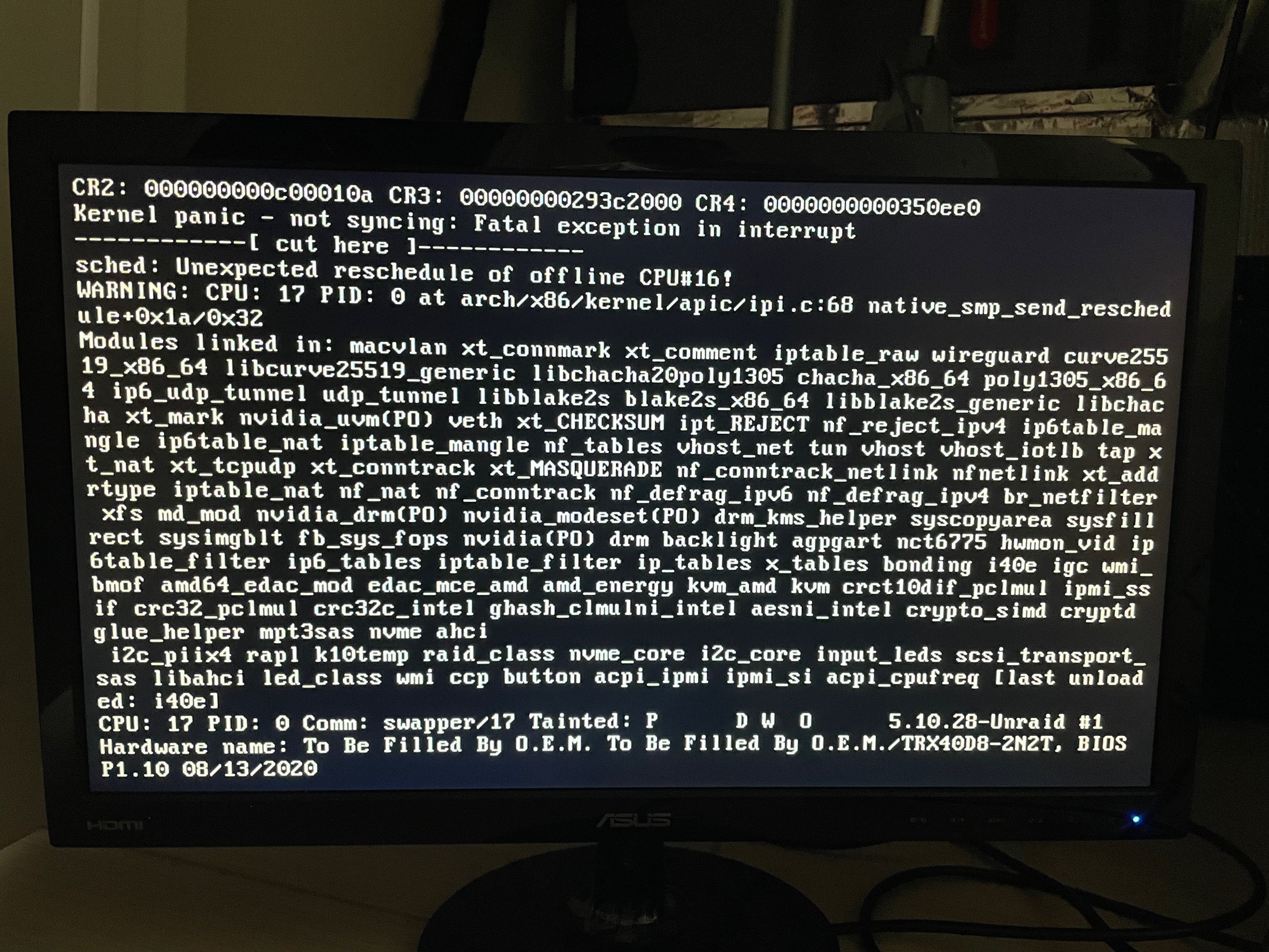

Crashed again this am - 1-2x weekly.  I added syslog mirror to flash if that will help.  Screen shot and syslog attached.
the time before this the monitor said : "Monster Login: General protection fault, probably for non-canonical address 0x9f", this time I posted image below in screen shot as more info is there.
I ran memtest in the last couple days and no issues there.  Hardware is thread ripper with ECC ram.

Macvlan call traces are usually the result of having dockers with a custom IP address, upgrading to v6.10 and switching to ipvlan might fix it (Settings -> Docker Settings -> Docker custom network type -> ipvlan (advanced view must be enable, top right)), or see below for more info.
https://forums.unraid.net/topic/70529-650-call-traces-when-assigning-ip-address-to-docker-containers/
See also here:
https://forums.unraid.net/bug-reports/stable-releases/690691-kernel-panic-due-to-netfilter-nf_nat_setup_info-docker-static-ip-macvlan-r1356/
I guess I'm just oblivious, but I went to the main forum and it says v6.10 RC2 available, but can't actually find the link.  I'll do anything at this point, if I can't get it fixed I'm going to buy a NAS and be done with it, stability is critical.  Appreciate it.
Backup your actual flashdrive
Update your plugins
Go to Tools / Update.
Select the Next branch.
Download the update
Reboot
