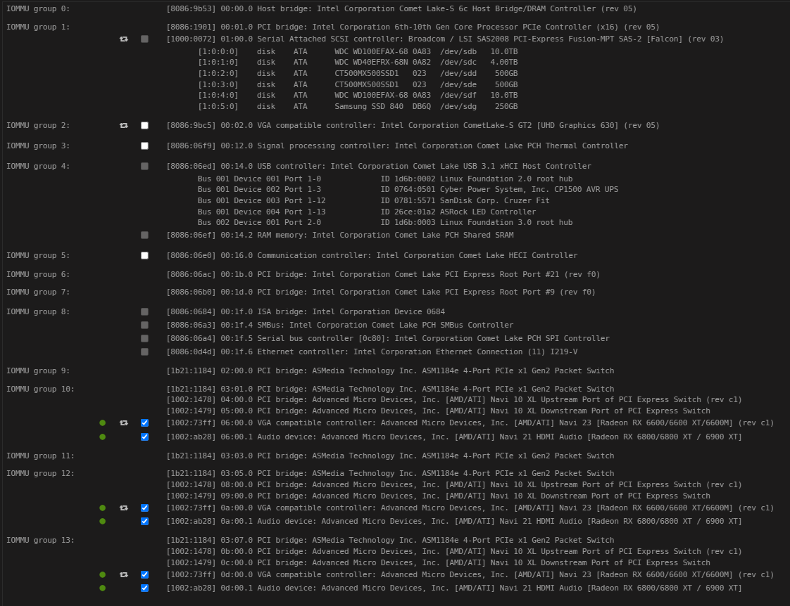

VM (HiveOS) won't start with a third GPU on Q35
i had running HiveOS as a VM for over two month without problems.
Last weekend i try adding a third GPU, but the VM won't start.
I had to switch over to i440fx. (With i400fx i had some other problem with the WebUI, but this is another story.)
So, i created a new VM, added the image and my GPUs with i440fx.
Now i am trying why Q35 will not work, or what i do wrong?
Here is my XML:
Spoiler

Maybe someone can take a look and can give me a hind?
Edited by sonic6

If i delete one of the Cards(+multifunction) the VM will start. Doen't matter which one. (I also don't need the multifunction as well, for a VM startup)
Or isn't it possible to start a VM with 3 GPU on Bus?
(I need the Card on "bus", because the card values on "slot" are all the same (temperatures, hashrate, etc)

Does not work... I don't understand this... maybe it is the image?
For what it concern the xml everything seems good.
What do you mean by doesn't work? Can you be more specific?
Sorry, i wasn't at home.
So, if i start the "working" xml i can see in the unraid dashbaord that Thread "1" goes up to 100% for a few second. Then the load from Thread "1" goes down and Thread "7" goes up to 100%. After that both are beetween 20%-30%.
With "your" xml only Thread "1" goes up to 100% for a few seconds and then nothing. Both Threads goes down to 5% and i can't connect to the VM with ssh.
I don't have any error or messeages in the logs, so i don't know where or for what i can take a look.
I would try from scratch with a new vdisk, but if it doesn't work it sounds to be quite difficult to fix, if it's possible at all..
Check also for bios updates, try to avoid beta versions first.
So, i try adding noVNC, but it looks like the VM won't really start up:
if i add all GPUs under pci-root (0x00) i can follow the start up on VNC.
My bindigs are ok?
Maybe there are limitations with 3 GPUs on Unraid, QEMU, KVM? Are there some other places, where i can look at Logs or something else?

1 hour ago, sonic6 said:
My bindigs are ok?
Do you use acs override?
I can see pci bridges belonging to a different device in the same iommu groups, I would split more the iommu groups with acs override downstream, multifunction ("both" option in unraid) if you are not using it.
Are you attaching the gpus to a pci express third party card (asm1184) pcie riser? <-- This may be the issue...
What card is it?
Edited by ghost82
17 minutes ago, ghost82 said:

If i change the GPUs to "bus 0x01"... then i got the windows from this post
What card is it?
okay, now i will be complicated:
i am using this m.2 to PCIe riser then a 1-to-4 PCIe Card (picture) and three PCIe x16 riser
i know this is a very weird and messi setup. but when i delete just one card from the xml (doesn't matter which one) the values are fine and the vm starts up.
so in my eyes, the hardware setup isn't the problem.
I think it's not a good idea to use both vnc+qxl + gpu(s) passthrough, I always read: use one or the other and if you need remote access with gpu passthrough enable it in the vm.
I would not bet on this, could be a firmware issue, but this is becoming very difficult, at least for me, to solve.
I used this just for troubleshooting.
Thank you! you helped me alot about understanding how the xml works. It "works" at this point with the "bus"-solution and if a found another way, i will report!
