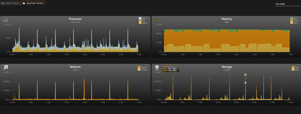

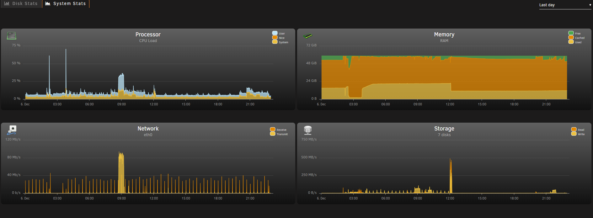

How can I find out what's causing the massive disk IO that occurs each day at 12-noon ?  It's causing some containers to fall over.
3:30am is my CA backup, 8am my Duplicati backup begins, transferring to a different server, and it finishes at around 10:30am so I expect to see high disk and network usage peek a this time, but I have no idea what the 12-noon disk usage is?

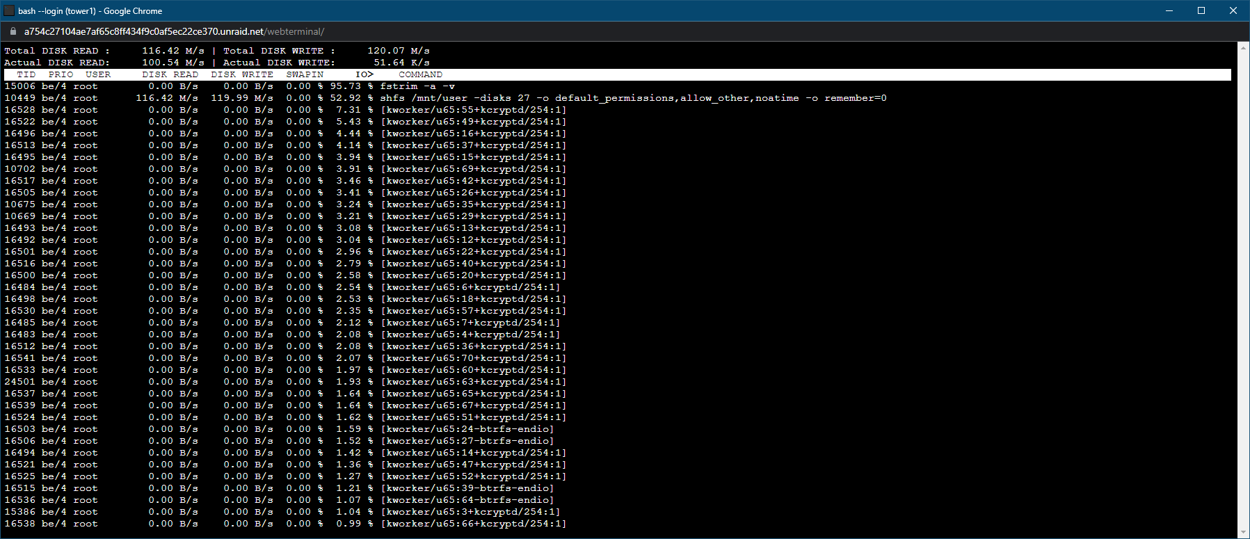

iotop from NerdPack (also requires Python 2.7) may help figure it out.
12:00:

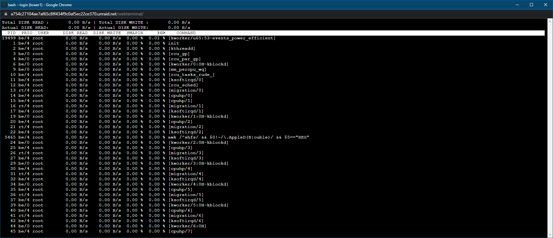

12:12: (seems back to normal) :

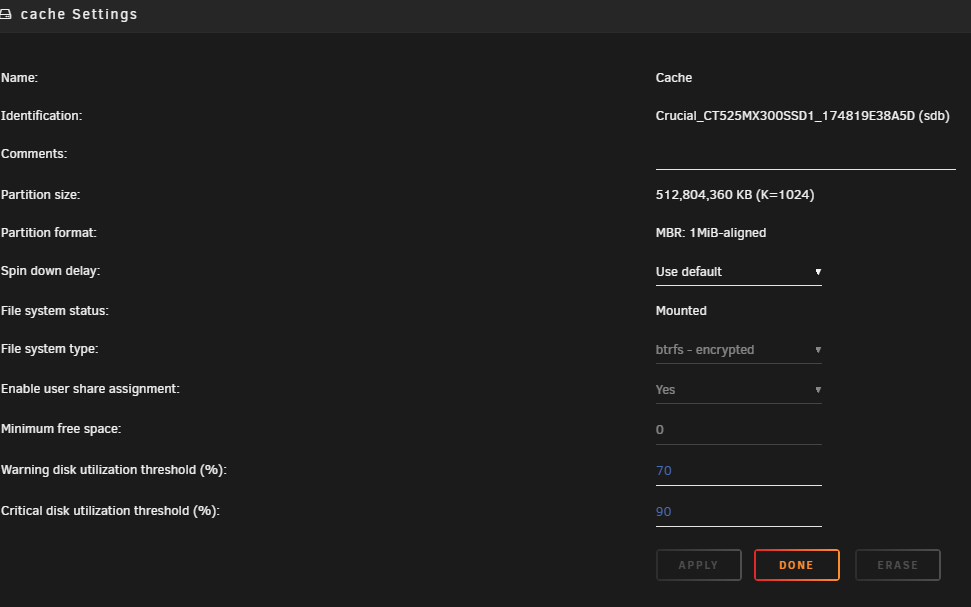

BTRFS will do that.  XFS won't.  Hourly is a bit much to run it though.  Daily or weekly during off hours is more than sufficient
My cache drives are using btrfs, so i'm ok to just disable it?
