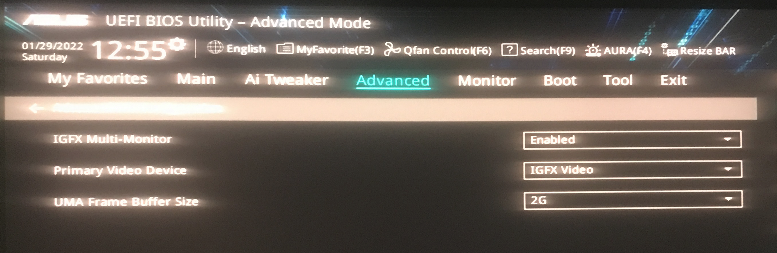

As to the settings to make sure the integrated GPU is always active, here is what I set in the Asus motherboard BIOS:
