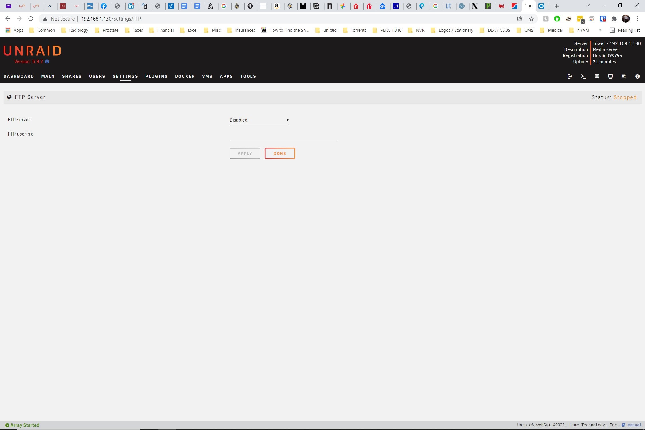

Looks like it is still spinning it's wheels. Taking a very long time to come up. Once up, the ftp was back to enabled. I know that I disabled it...
Also, it seems that my shares all of a sudden just drop out. When I tab over to the Shares all I see are my disks. I'll attach a second diagnostic which is right after the share disappeared.
tower-diagnostics-20211207-1823.zip
tower-diagnostics-20211207-2112.zip
Edited by levster
Make sure you have no ftp users listed

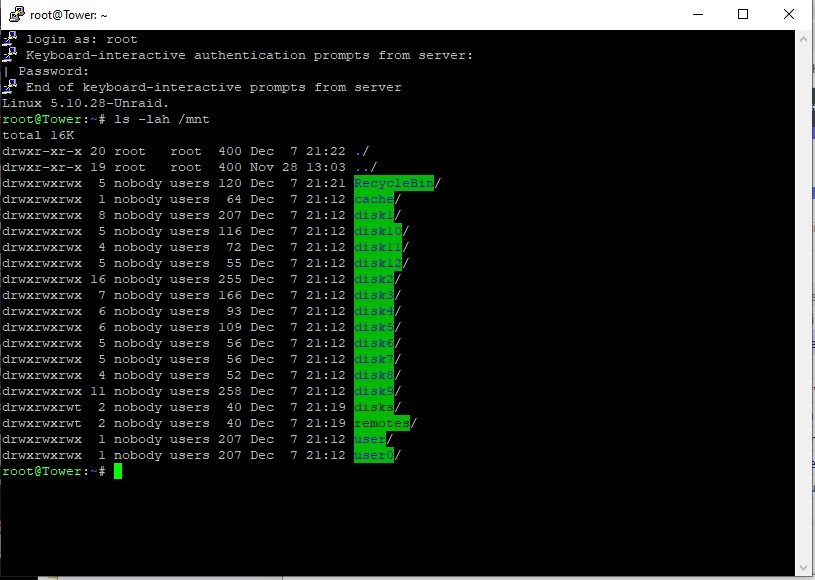

What do you get from the command line with this?
ls -lah /mnt
ls -lah /mnt
I have no one else logging into or using the server. It took over 800 sec to come up the ftp is again enabled.
It seems that every time I try to add MariaDB to the docker - I loose my shares!!!
Log for_ mariadb.pdf
Edited by levster

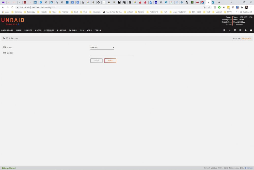

On the FTP Server page where you disable it.
I do not think that I have any ftp users. I am the only one who's using the server.
Edited by levster
