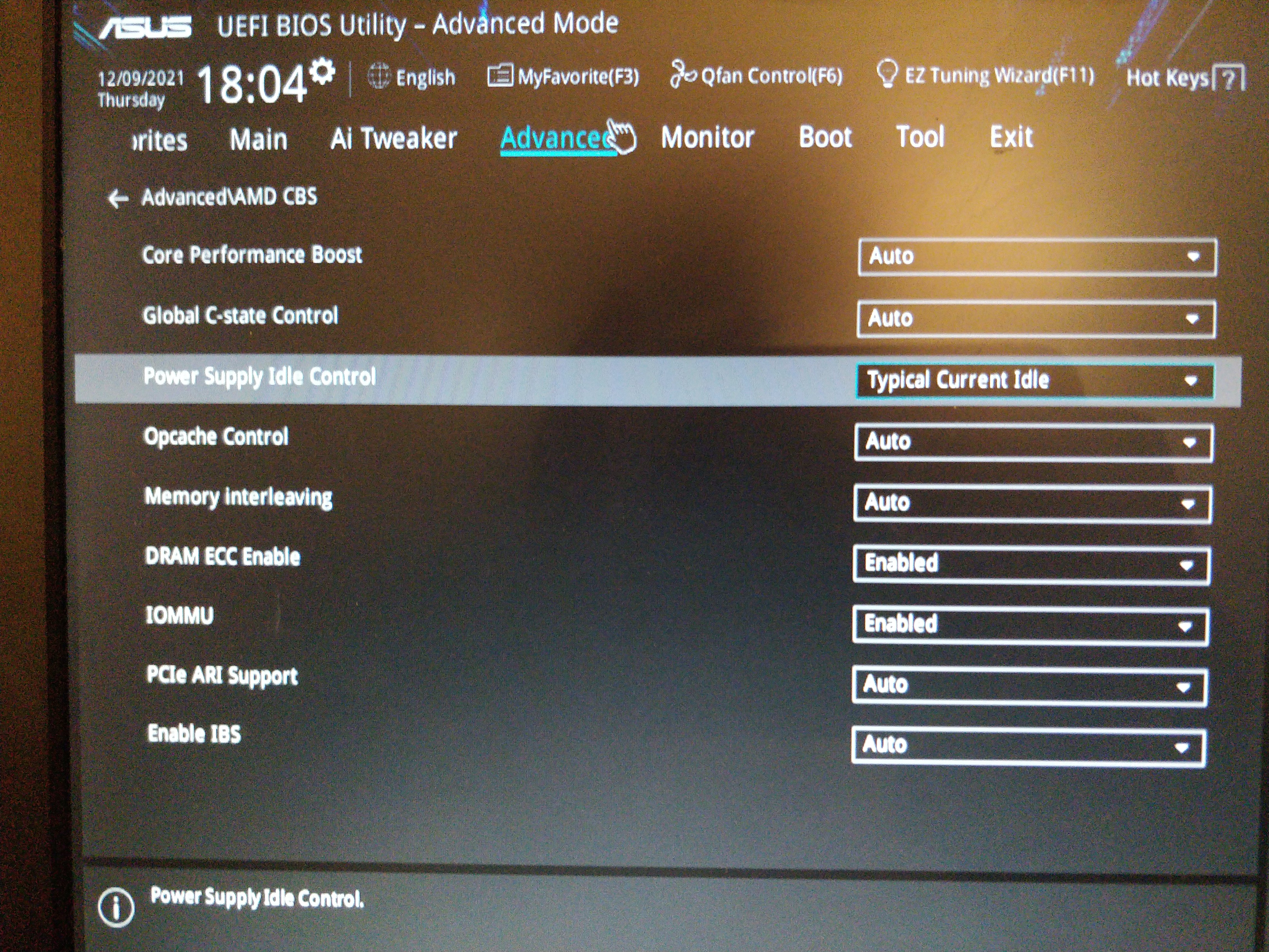

Thank you. I'll double check when at home, I'm almost sure to have follow instructions this page regarding ryzen cpus when I set up the server last year. Not sure about power supply idle control, but I remember disabling global C-State control. I've never experienced such behaviour in roughly a year and a half.
Edited by potjoe
Hi! So I finally had the time to check bios settings tonight. My memories were correct : when I set up the server a year ago, I disabled Global C-state control but did not touched Power Supply Idle Control. I adjusted them according to the recommendations : Power Supply Idle Control set to "Typical Current Idle" and re-enabled Global C-state control (set to auto).
The situation where Unraid became unresponsive only started two months ago or so. I'm not familiar with the options you mentionned, thus I don't know if this was the source of the issue.
Current settings
Edited by potjoe
