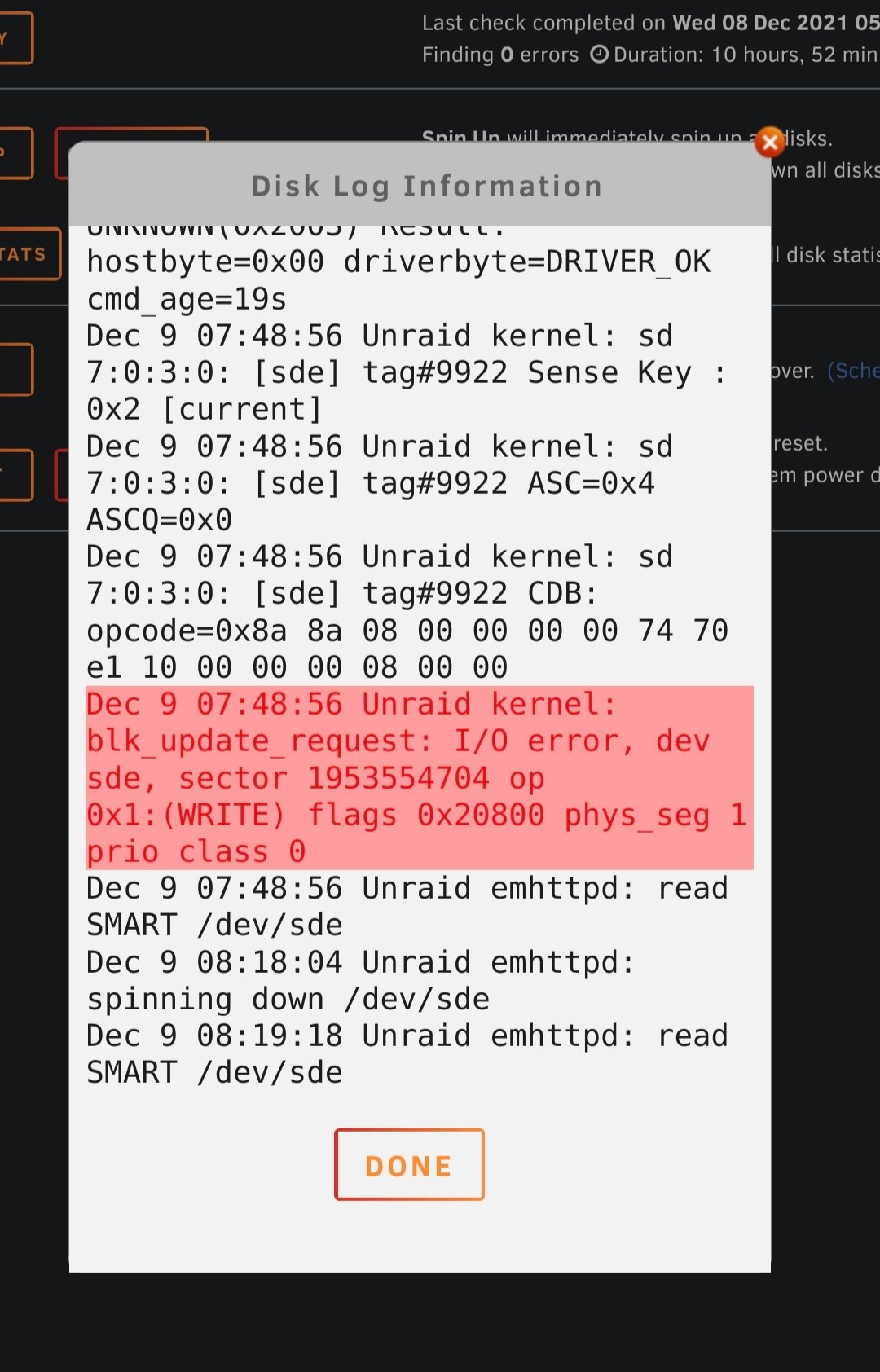

Screenshot_20211209-082251_Firefox.thumb.jpg.a44c1129b3e0e7c8ec8882803ceab957.jpgSo I woke up this morning to notification that my array had a disk with an error. It was the parity drive and had 1 error.
I recently only just put the 8tb drive in as parity, upgrading from one of the 4tb drives and it all went well with initial checks etc for over 20 hours. Anyway,
I spent yesterday consolidating the data on my drives so data wants spread out amongst a bunch of drives. I used unBalancer to get the job done. I presume it went well as when I fired everything back up everything worked with 0 issues.
About 3 or 4 hours later it looks like it hit the parity with the error. Here's a screenshot of the disk log and I've included the zipped diagnostics which are from before I touched anything.

Any ideas? I'm not one for diagnostics but from the disk log looks like a write error?
Is anyone able to check my diagnostics out and see if there's more information about what happened?

SMART attributes look OK, not a new disk but not very old. Looks like extended test was run a few months ago.
Run another extended test, you might have to disable spindown on the disk to get it to complete.

No worries, I'll give it a once over and see how it performs and report back
