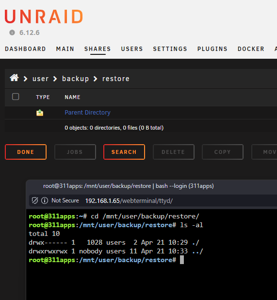

Hi!
Thank you very much for your docker. I like it very much. I just have one question - would it be possible to change the permissions after a backup-run?
I'm asking because I would like to upload the archive-files with another (rclone)-container - but the other docker doesn't have the permission to access the files...
Thank you so much!
6 minutes ago, sturmstar said:
Hi!
I think you should check the UMASK variable, it will allow you to customize how backup files are created. Or you can also create a cron job in unRAID to periodically check and assign permissions to whatever you would like for the new files.
Hi! Thanks for the quick response.
Cronjob in Unraid is imho a bad solution because I don't know how long the backup is running for example.
I know there are these UMASK settings - but I must confess I'm not familiar with how these are working exactly. Could you give me a hint how I could/should set them - it would be no problem if the permissions are for all - I have no security issues here.
thanks

I did what you said - I added the UMASK Var to the vorta docker, deleted the whole repo before, and tried again to upload with rclone. Doesn't work - sadly. I even don't know if the permissions are different then before?
best regards
image.png.118a17765b05078062897919d4ca91b8.pngimage.png.1dd4d49952fbeb5c5c2937bc203633d8.png

7 hours ago, SmartPhoneLover said:
@sturmstar
I couldn't find the reason why you're experiencing that behaviour with the files created by Vorta. (I don't use RCLONE)
I have asked it to other users, but did not receive a reply yet as not many of them use RCLONE. I will reply to this thread if I have an answer for this.
Thank you for your efforts here.
Just for you to know - currently I use the 'borgmatic' container for borg-backups. The issue with the permissions there is exactly the same - except there is the possibility to run a "hook" after the backup is done. I use it to chmod 777 -r everything after a backup. Also not an elegant solution but it works at the moment.
But I just like the GUI from vorta - i hope we can come to a solution there.
What I don't understand is - I'm no expert with linux in general - and with file permissions in linux - in combination with docker inside/outside - but should it be so hard (?) - I mean - is this such a 'special' demand?  - someone has to be knowing what he's doing.
best regards
best regards
What about ownership? Have you tried exporting PUID and PGID ?
I don't know what 'export PUID und GUID means...
But I 'solved' it the other way - I got it running by changing PUID und GUID to 0 and 0 on the rclone-docker - I think this means that the rclone-docker is running with root rights - and so it can access the files from vorta.
...best regards
