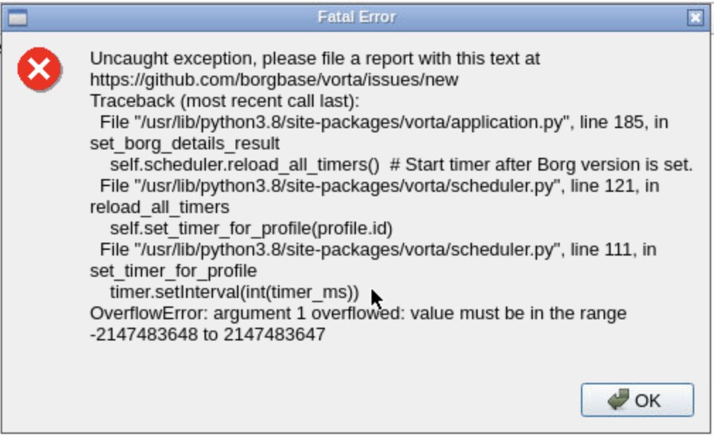

I'm getting this error msg when I tried to change from "Backup manually" to Backup daily or weekly.
Please help... thanks
Hello everyone,
I have similar problems as the poster before me. The interface is crashing and no further operation is possible. A restart does not fix the problem, i.e. I can no longer make any changes.

On 5/1/2022 at 11:50 AM, Stenki said:
Hello everyone,
Same here - everything was working fine for long time and crash broke everything.
